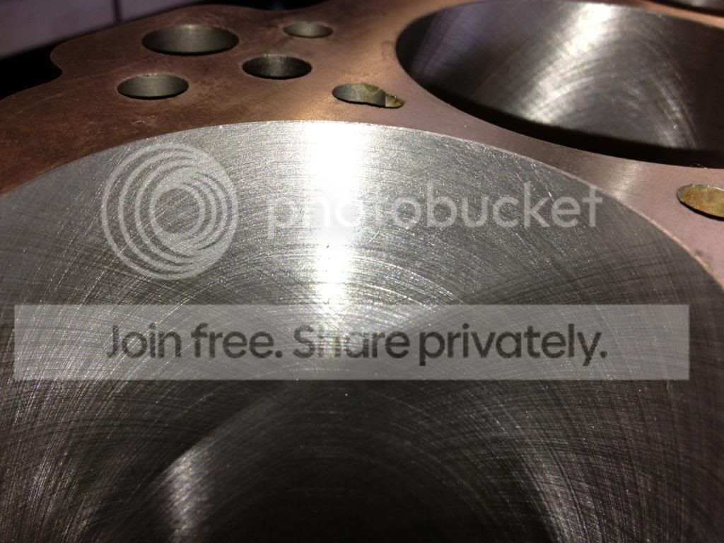

Picked up a new block today and took it over to the engineer, it is standard 84mm bores so will be having a re-bore, the eagle crank is being re ground, new pistons, new rods , all new bearings etc, balance shaft removal basically a brand new bottom end,

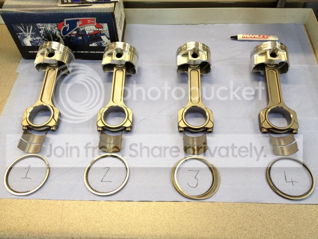

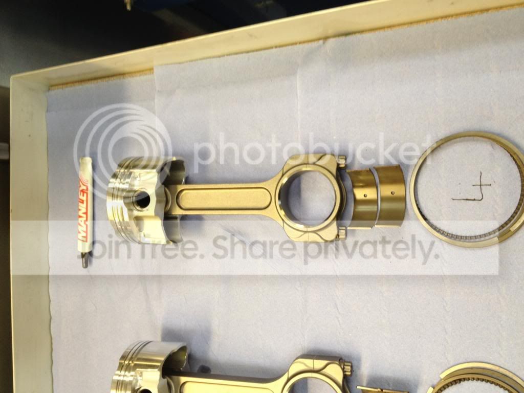

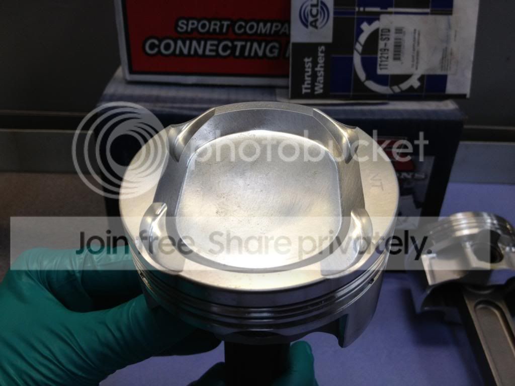

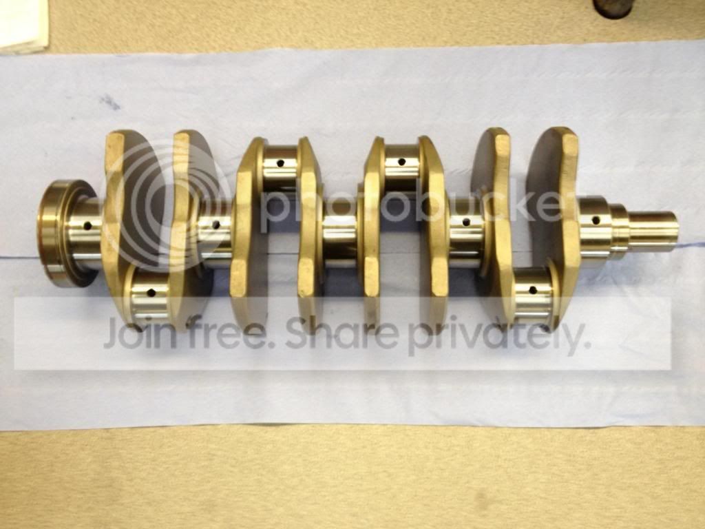

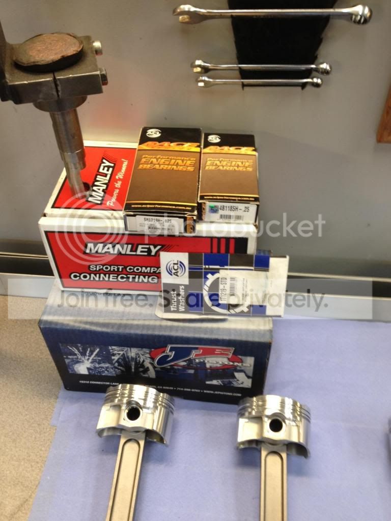

Here are some picture of the new parts used for the bottom end rebuild:
Eagle crank
JE pistons and Manley turbo tuff I beam rods
Rebore (fresh block)
Also ordered a balance shaft delete kit today I thought I may as well do it whilst the engines in bits..
Parts look awesome !!!
I like shiny new parts, such a shame they never get seen :(

Had JE in before and 86mm
Yeah true lee , although you certainly know they are there lol

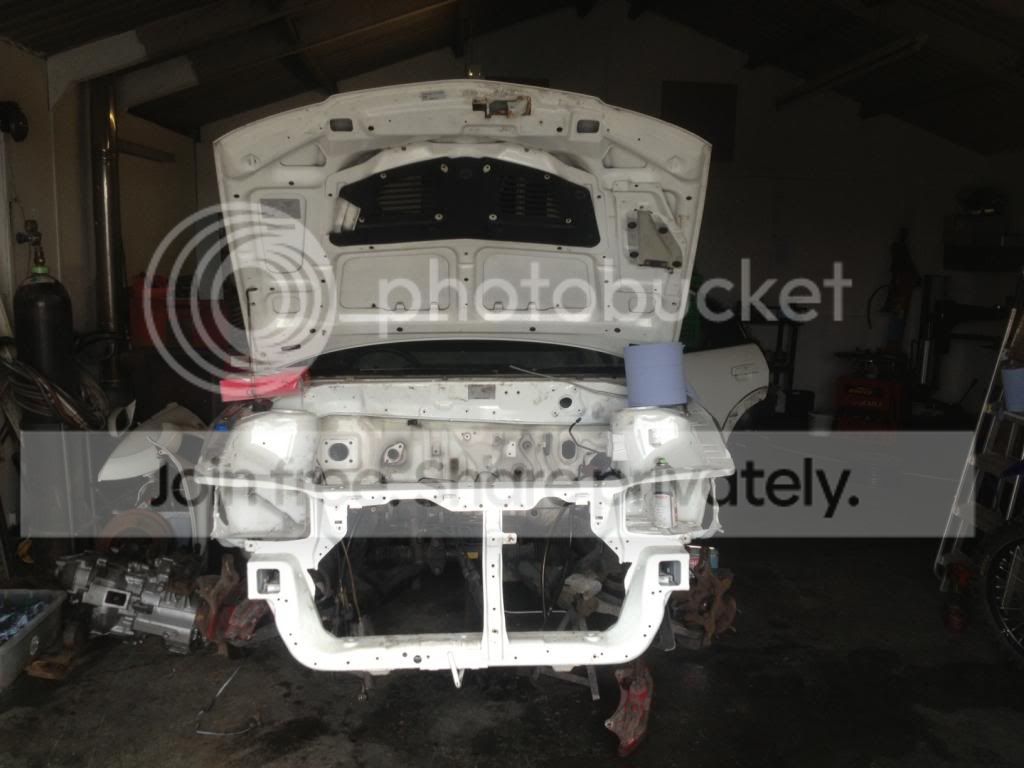

Started stripping the car today ready for respray. Will be heading off to be shot blasted and painted underneath early next week then off to the body shop, gna rebuild this over the winter from the bottom up, powder coat all suspension bits etc
Pics tomorrow
Mikeyc
Mikeyc

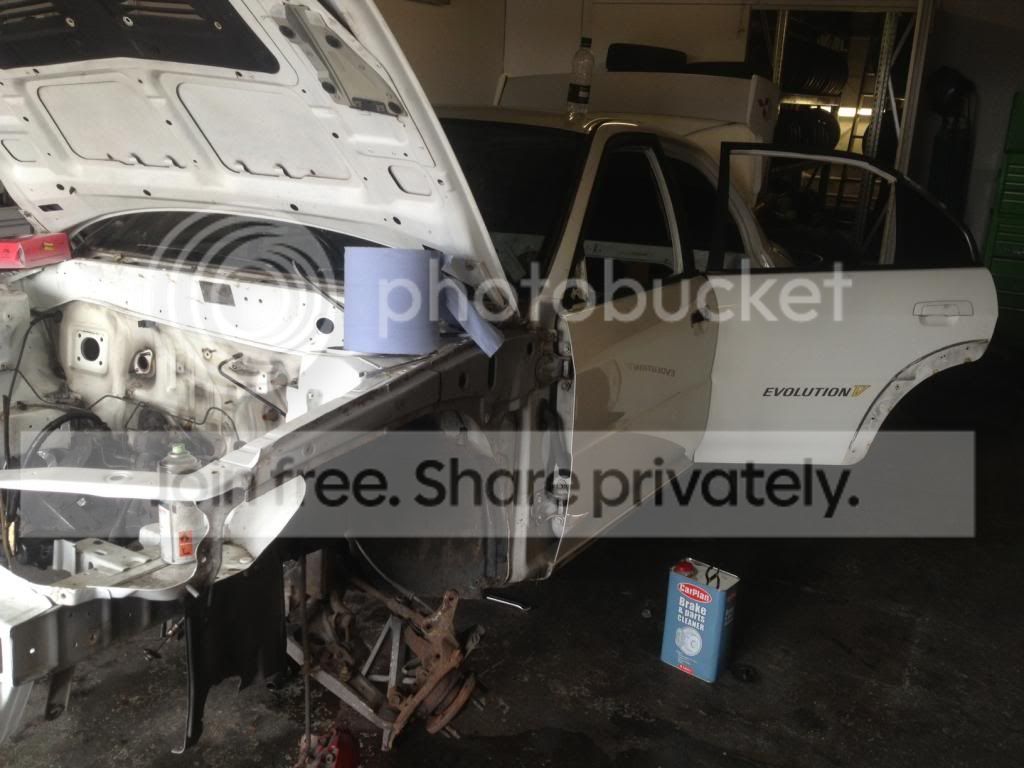

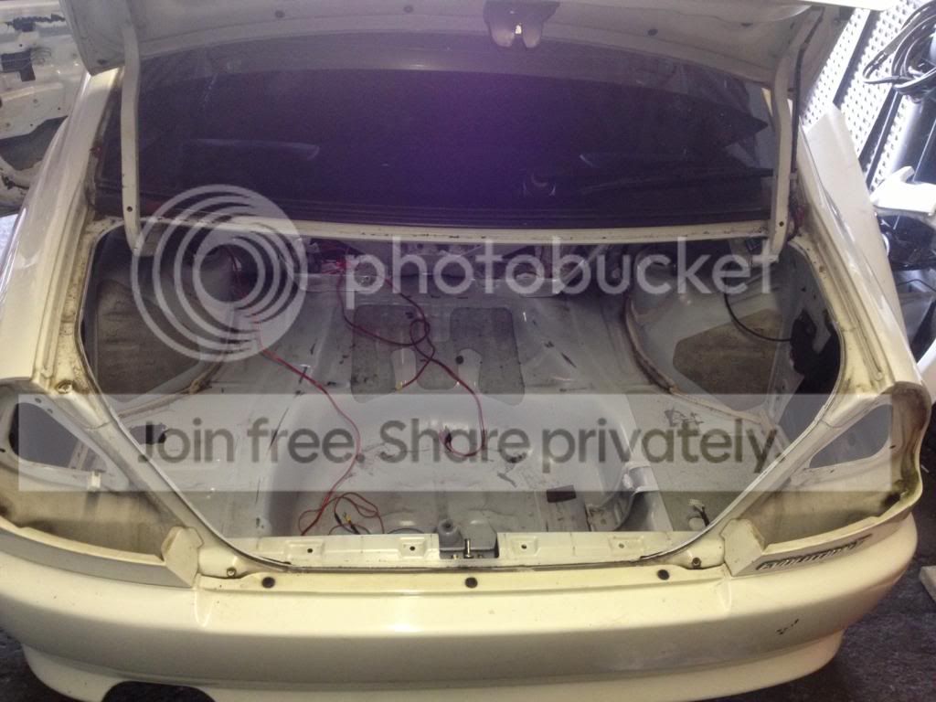

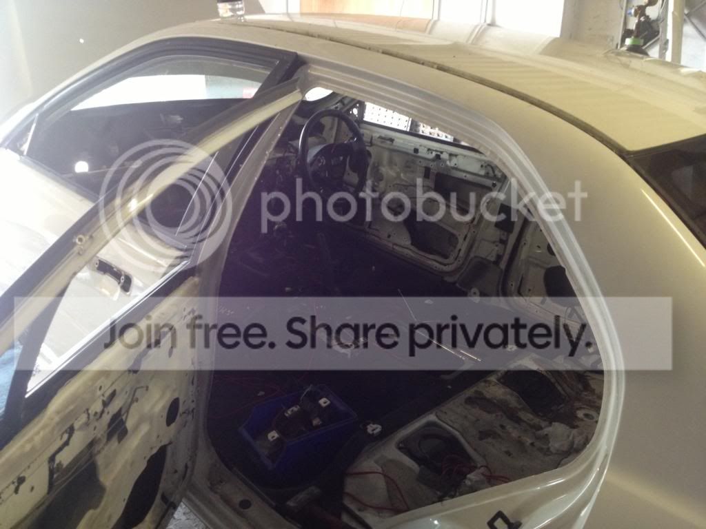

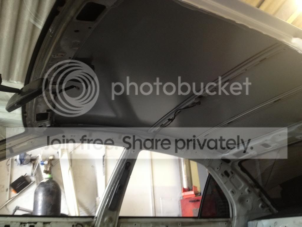

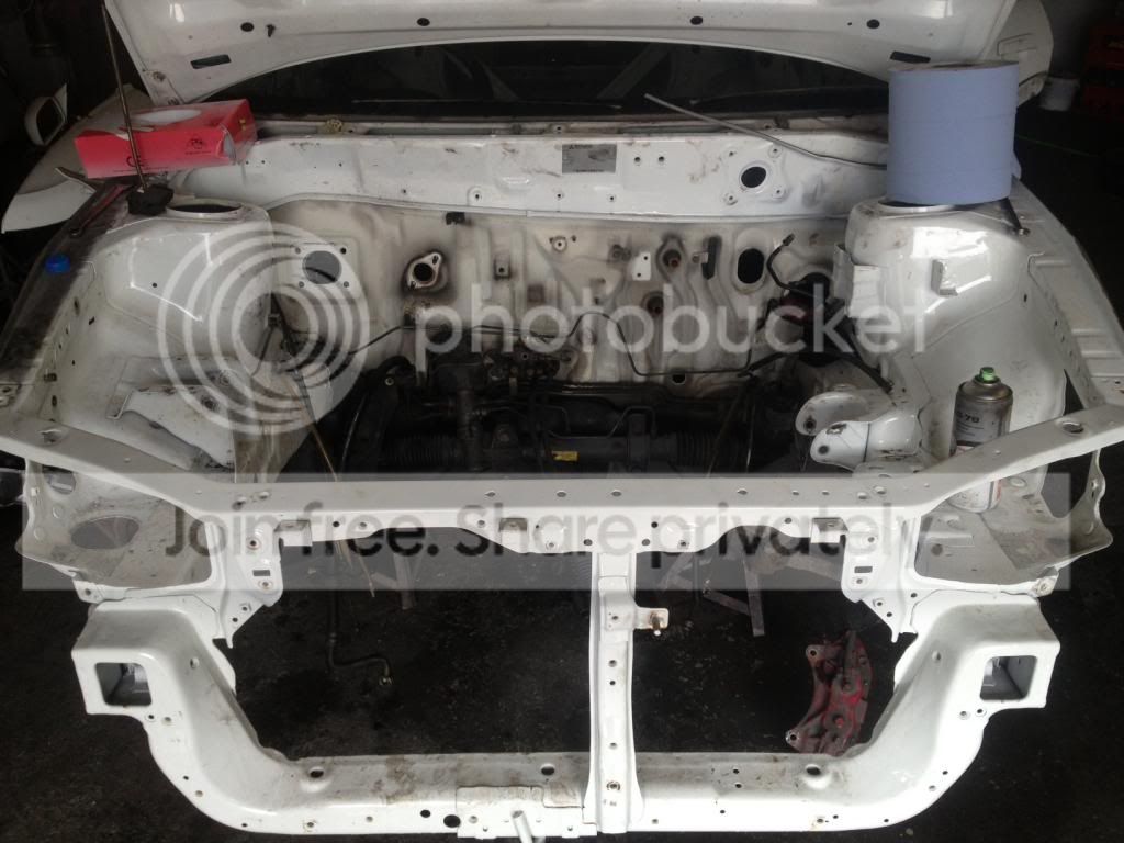

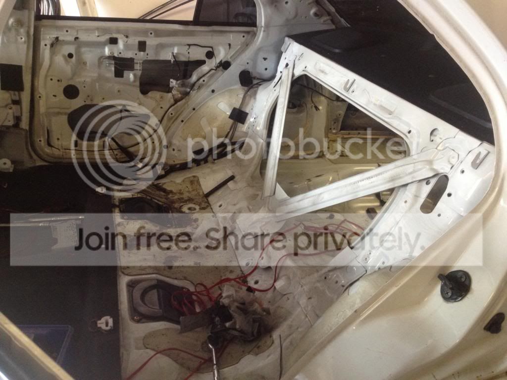

Today and yesterday the car has been stripped to a bare shell...
pics
The car will go off to the bodyshop on tuesday for a full respray inside and out...also the bottom is being taken back to bare metal and protected and painted white.
All metal bits will be shot blasted and powder coated before going back on to the car and after that the new engine :)
Now that's what you call stripped. May not seem like it but will be worth the effort :)

Mate I got half way through and thought "what am I doing !!!" Haha but will definately be worth it , after bare shell respray nothing is being bolted back on unless it's been powder coated or a new part :)
Just gotta drop sub frame down after I collect some trollies tomorrow then she's pretty much ready
