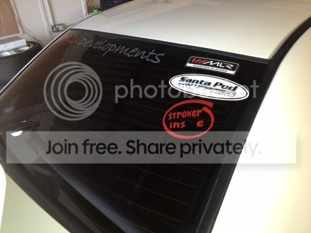

Picked the V up monday so me and a friend Joe got to work on it looking at what would need to be done...

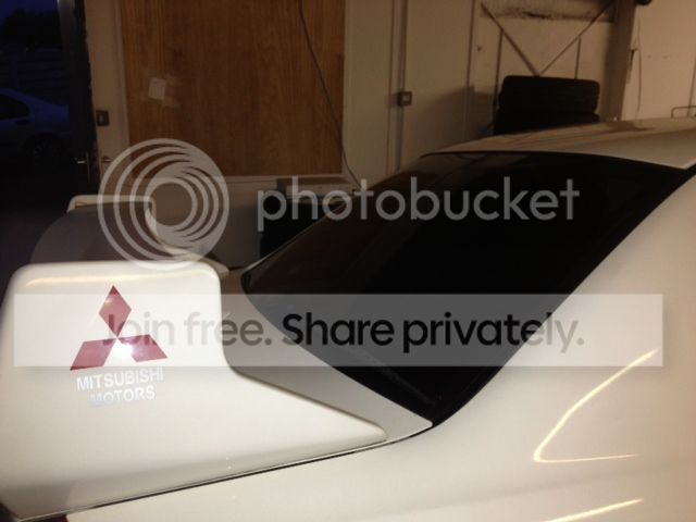

First job was to remove some of the horrendous stickers all over the car :wtf:
Some people have strange taste....I believe an evo needs very little in the way of stickers etc to make a statement lol just my opinion

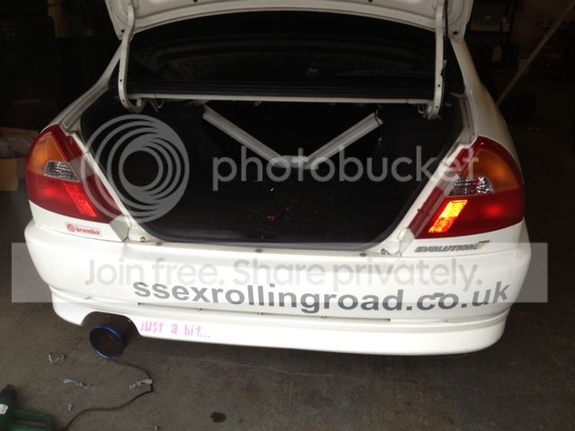

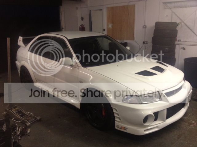

So when we got it, it looked something like this:

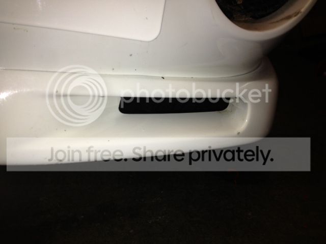

So then we removed all stickers apart from anything original and left the ralliart ones on the sides of the front bumper :razz:

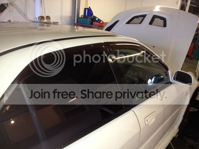

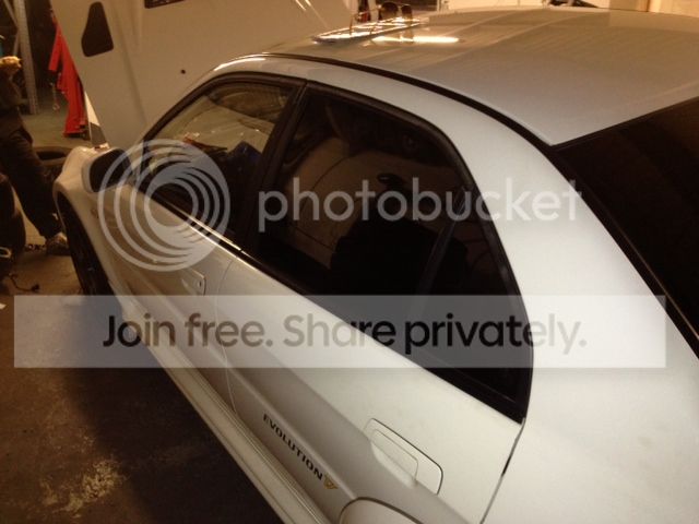

Some pictures after sticker removal:

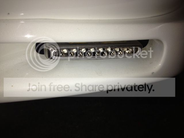

Also we loved these HID fog lights......NOT :mad:
So out they came

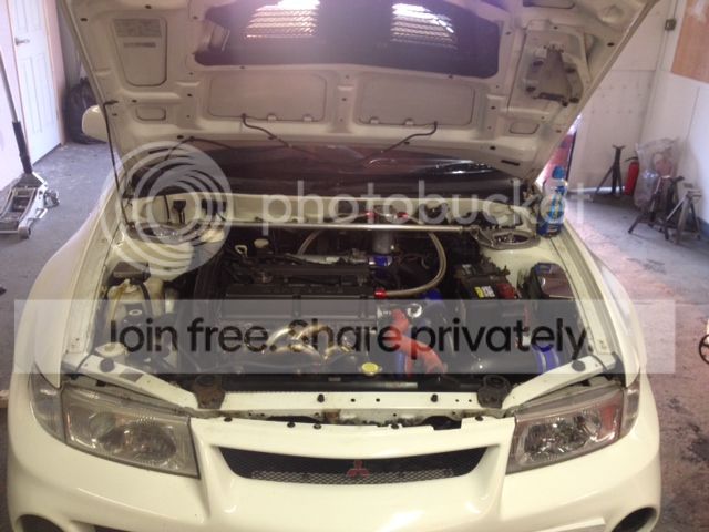

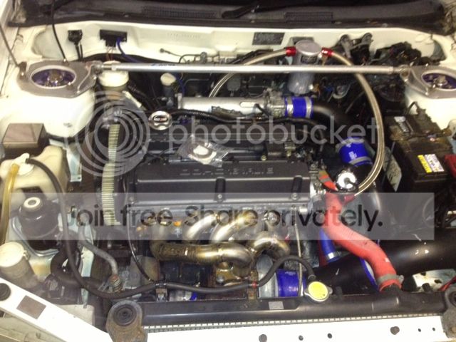

Engine bay when we got it...bit messy but we will sort that :angel:

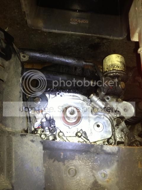

Joe fitted a new crank seal while I done the body work

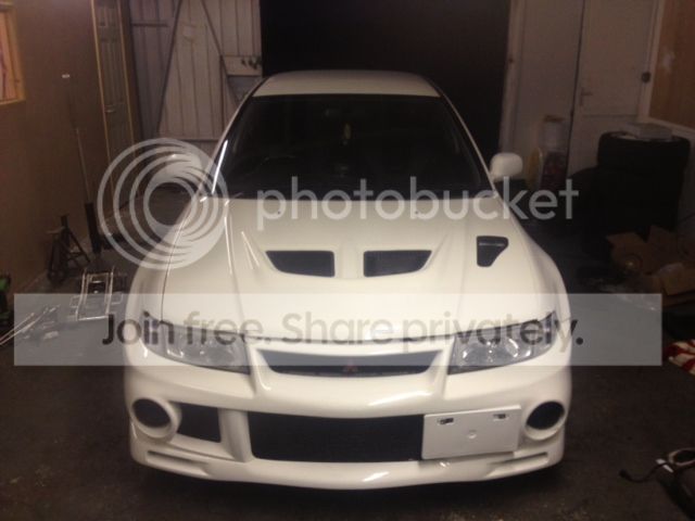

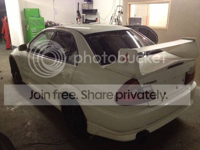

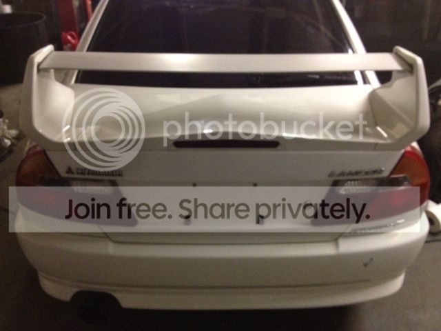

A couple of pictures at the end of the day

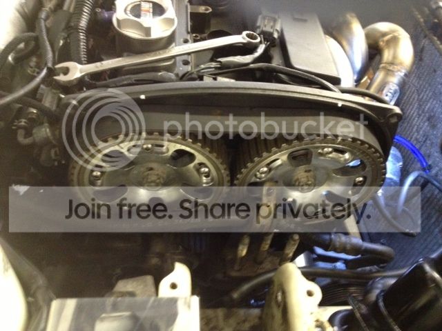

We got the rebuild finished today including cambelt and all the odds and ends....
Turned it over to start it and its only getting fuel to cylinder 1 and flooding it...
The other plugs are dry...
We didnt have an ideal battery on it today so will fit a new battery tomorrow and see how it goes...we think it might be that....
After that we will check injectors and then if not then it might be the ecu, its running an apexi ecu.
Some pictures from today:
Cambelt/Balance shaft belt on and all timed up

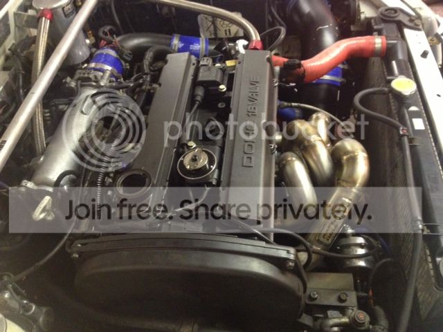

And engine bay complete:

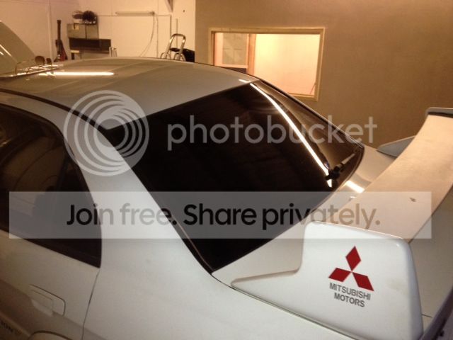

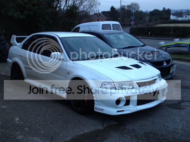

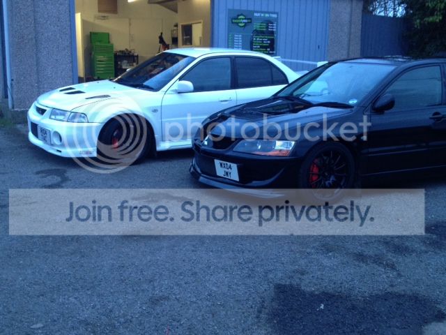

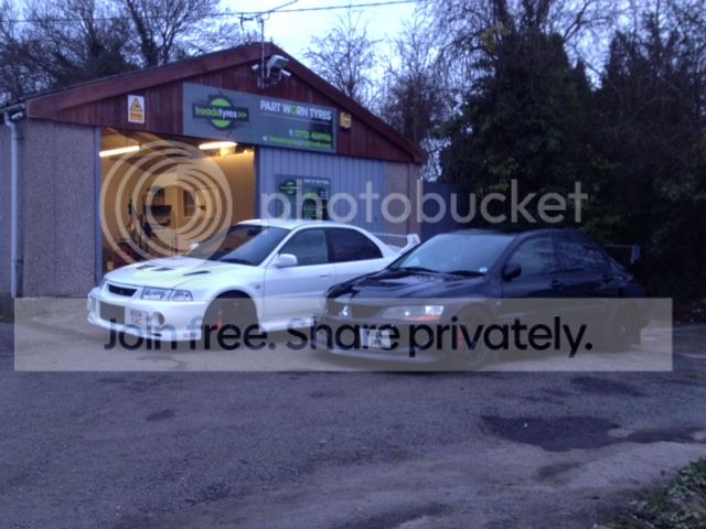

After we got it running and MOT'd we cleaned the V up and took some pictures with my VIII too :awesome:
