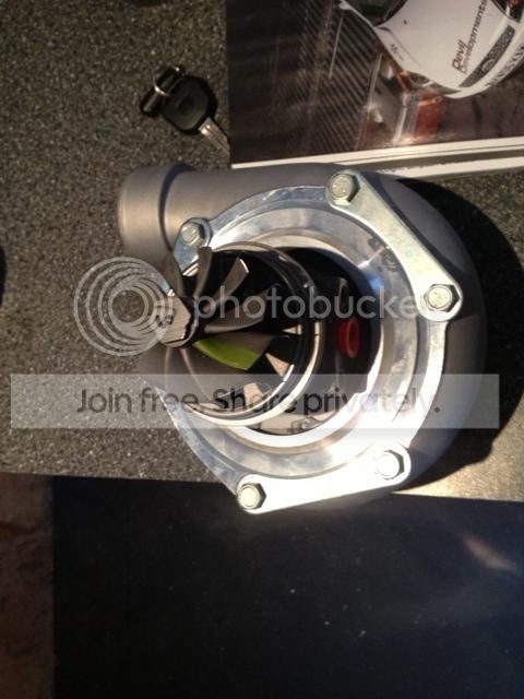

Just as I said it was running lovely my mate Joe took his brother out in the car and the tubby went pop :(
It was an old ATP GT35...its unfortunate but it was probably on its last legs...
So im now thinking of going over to a full frame turbo set up
What turbo would you guys suggest for a road car??
Aiming for 600bhp+

This turned up yesterday :)
Having the car mapped today so will put a couple of graphs up later

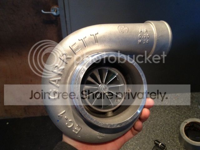

Turbo fitted and dyno today, mapped the car up to 475/475 to run the engine and new turbo for a week or so.
Very happy with the result, fun in the wet haha
That's a mans turbo :)
Good figures that. Now you just need to adapt your driving style :)
