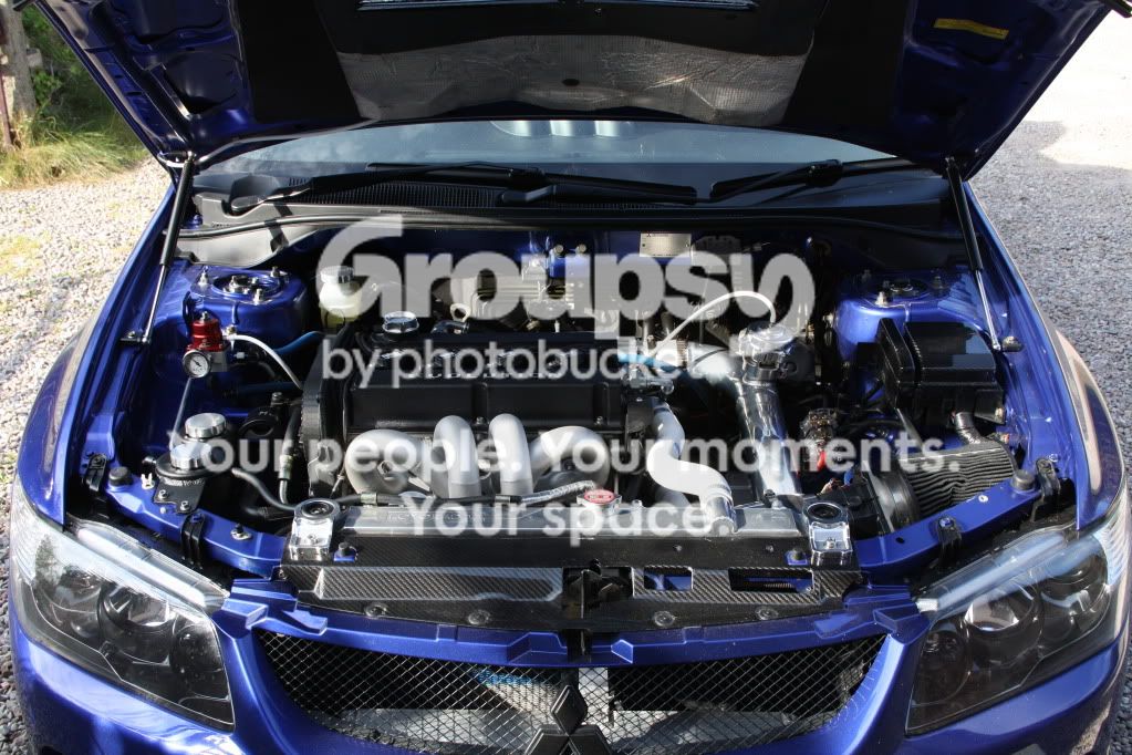

My Autronics ECU arrived today too :D SM4 pnp :D Can't wait to get it on the car and full mapped!! Not after pub figures, after full driveability and off boost characteristics. Though, she's going to stay a beast whatever happens ;)

My Coil on plug system arrived today too :D Ran the car with 0.8mm gaps on new plugs and WOW!! Can't wait to get this thing mapped :D

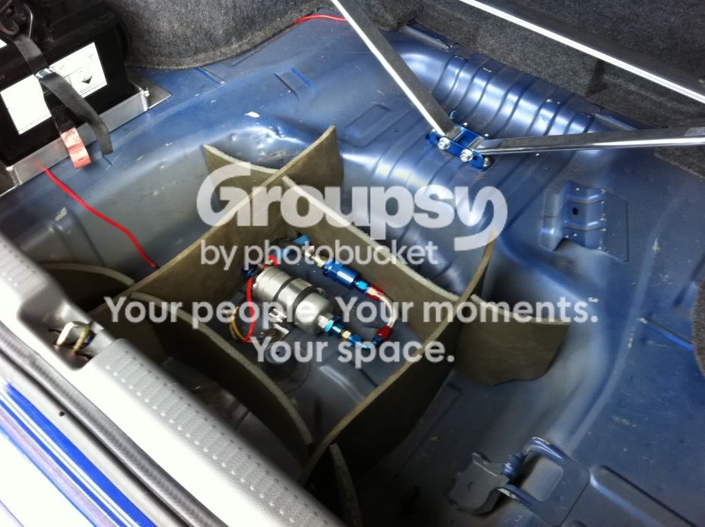

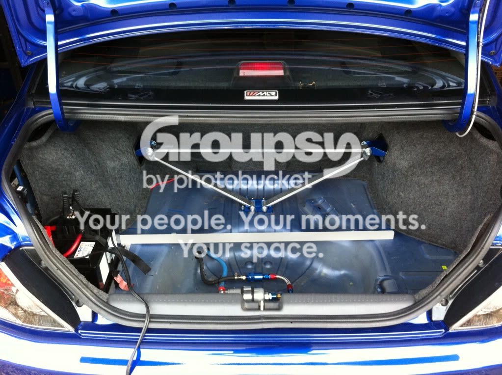

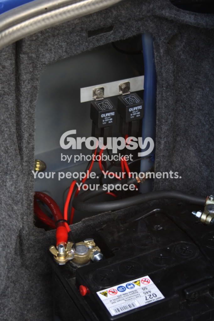

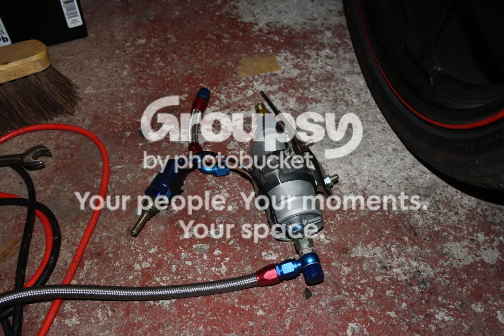

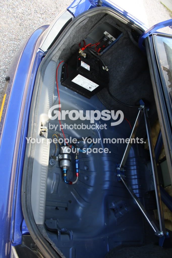

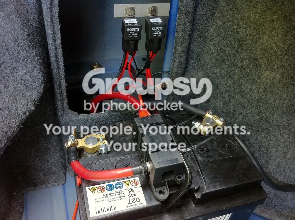

One thing that always bugged me since i owned the car was the noise of that bloody 044 pump in the engine bay, it sounds like a ****ed off wasp so have decided to move it into the boot as well as the battery. A fair bit of wiring to sort out, but i've finally sorted it ;)

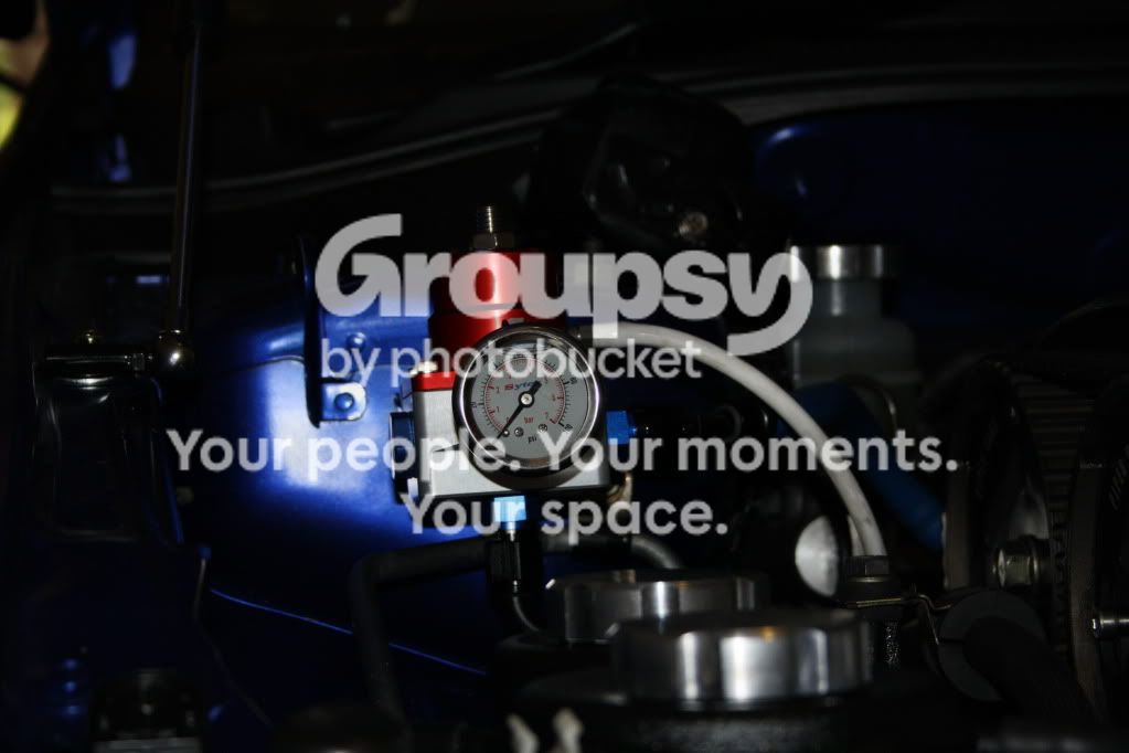

First off was to de-pressurise all the fuel system and pull it all away. I bought an Aeromotive FPR as well as a load of -6 fittings and aeroquip hose. Running the hose under the car was pretty straight forward as i cut out the metal feed hose, knocked out the plastic seats and ran the aeroquip hose in the gap :)

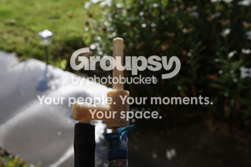

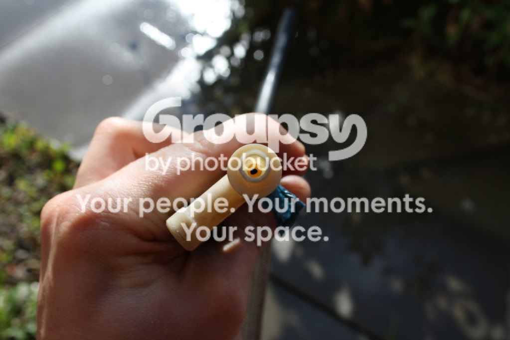

After it was all connected up and the wiring completed, i started the car up - no leaks :D but i couldn't get the fuel pressure below 3.5 bar :( Having researched my options, i decided to take it out on the venturi thingy in the fuel tank as it has a TINY hole in it to create the effect. Having a look at it, there isn't really much to it and i bit the bullet and drilled the hole out from 2mm to 2.5mm. I then decided to get the buckets and the hose to test to see if it still works
Well, the good news is it does! And at a low pressure too! So put it back in the car and got a 2.5 bar minimum on the fuel pressure regulator :) So i can get my 3 bar base fuel pressure and its now ready for mapping! Decided to pull the car out the garage as it was covered in dust and oily hand prints and give it a blast with the pressure washer
Next step is the battery tray to be ordered from Evo Solutions :D
Though i know there seems to be an ongoing battle as to whether or not you need a fuse/circuit breaker in the boot for the battery or not, but i always stay on the side of caution and have invested too much time and money into this car to see it end for a failure in the cable's sheath etc. Just not worth it. So my mega fuse holder arrived today :D 200amp should sort it ;)
I also fitted the switchable earth for the anti-lag on the Autronics :D Just need the battery tray and a PS pump to finish her

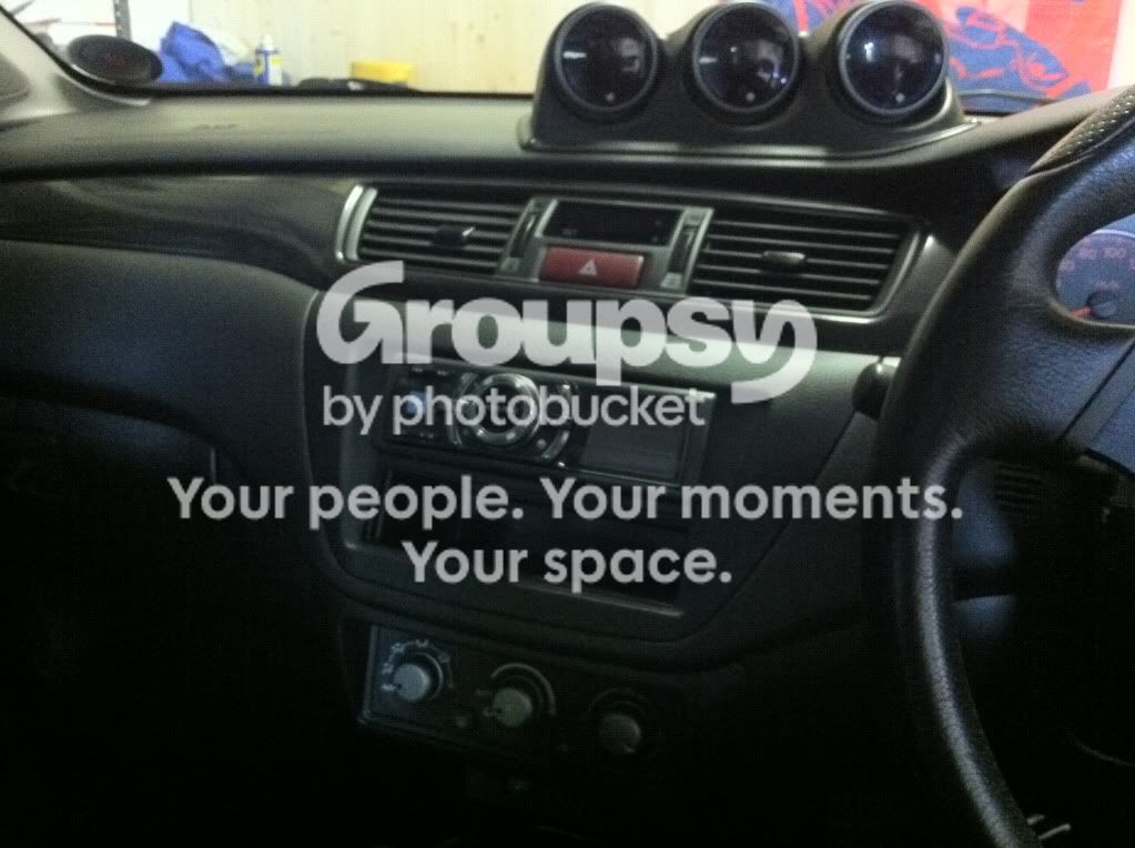

My stereo turned up :D Cheer's Mark for it, i haven't got the proper mounts or the wiring adapter, but i fitted it to see how it looked anyway :) I'm happy :D

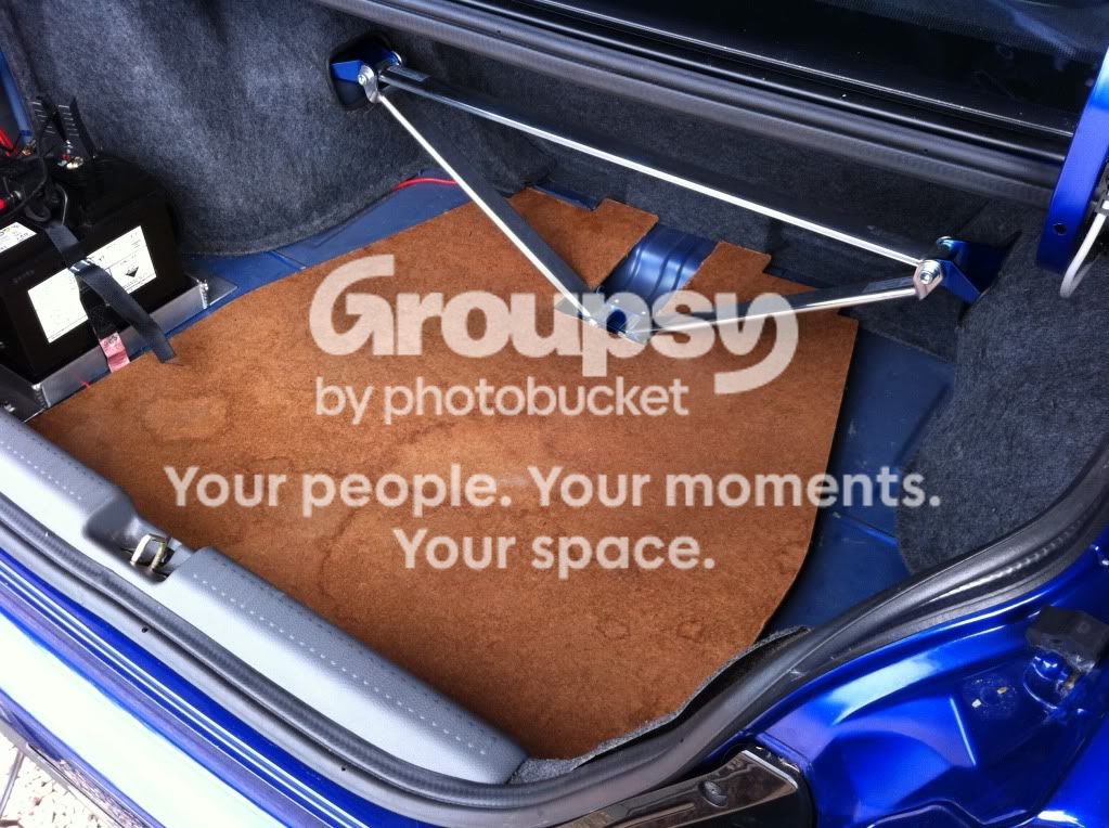

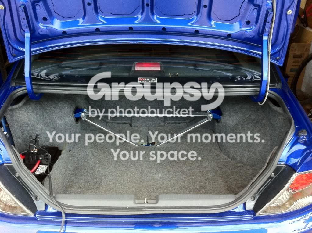

So onto the boot, to FINALLY finish it off. I extended the cable from the relay to the 044 so i could lay it under the tray, then shortened all the earths as much as possible. Then onto putting a bit of strength into the boot so i can actually USE it! So i started off measuring the depth of the boot well
Then got my old MOD issued roll mat and decided to cut it up :D
After some trimming and some simple joinery i got this :)
Its taken a while to get the things to actually straighten up, but after applying some heat, they finally made it :) Then put the wood back in to see if it can take the strength
Then shoved the grotty mat back in :) (could i get away with sticking it in the washing machine?!)
Stereo bits did finally arrive from Camskill and its in properly, its so nice to have music on long journeys!
