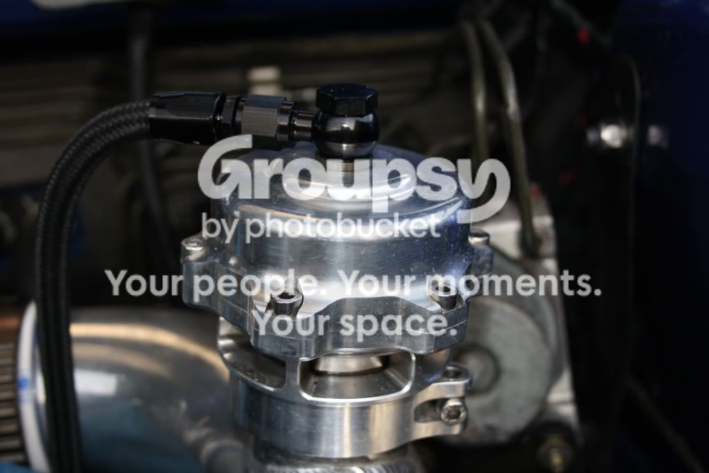

The Tial BOV since i had the car felt like it was opening late, almost like a delay from throttle release, found out with a bit of research that my 2mm vacuum line that was on the car wasn't good enough
So got myself some -4 lines and some fancy bits from autotorque
drilled out the feed from the bottom of manifold to 6mm and linked it all up!
When the car started you could see positive movement from the piston and whilst driving it felt MUCH better
BOV was louder and shut sooner
All in all, good move!

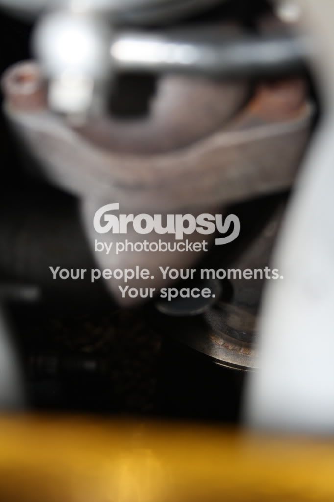

This is when i subsequently lost the bung in the downpipe
A replacement arrived from Ebay, cleaned up the threads in the downpipe, put a bit of exhaust paste on it and tighten it RIGHT up, ran the engine for 10 minutes then gave it another pinch. Hopefully the little sod won't come out!

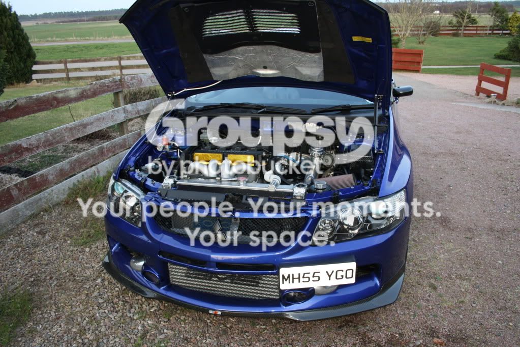

Next was an engine bay clean
Its not perfect, but its better than the dust that was sitting on it

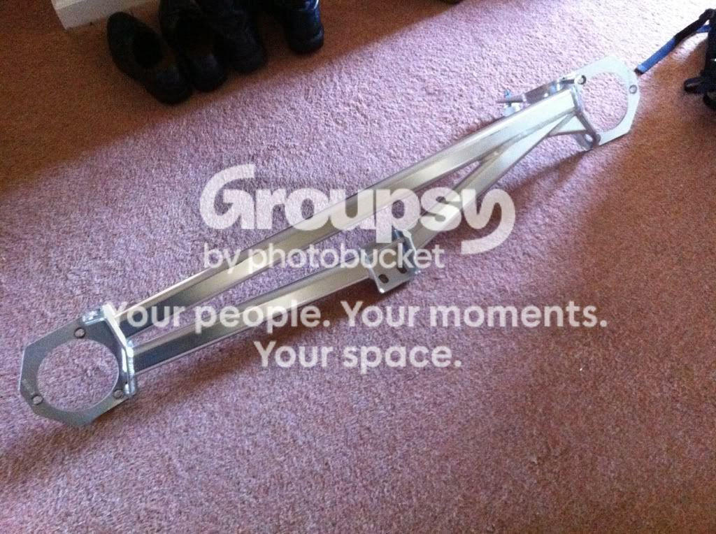

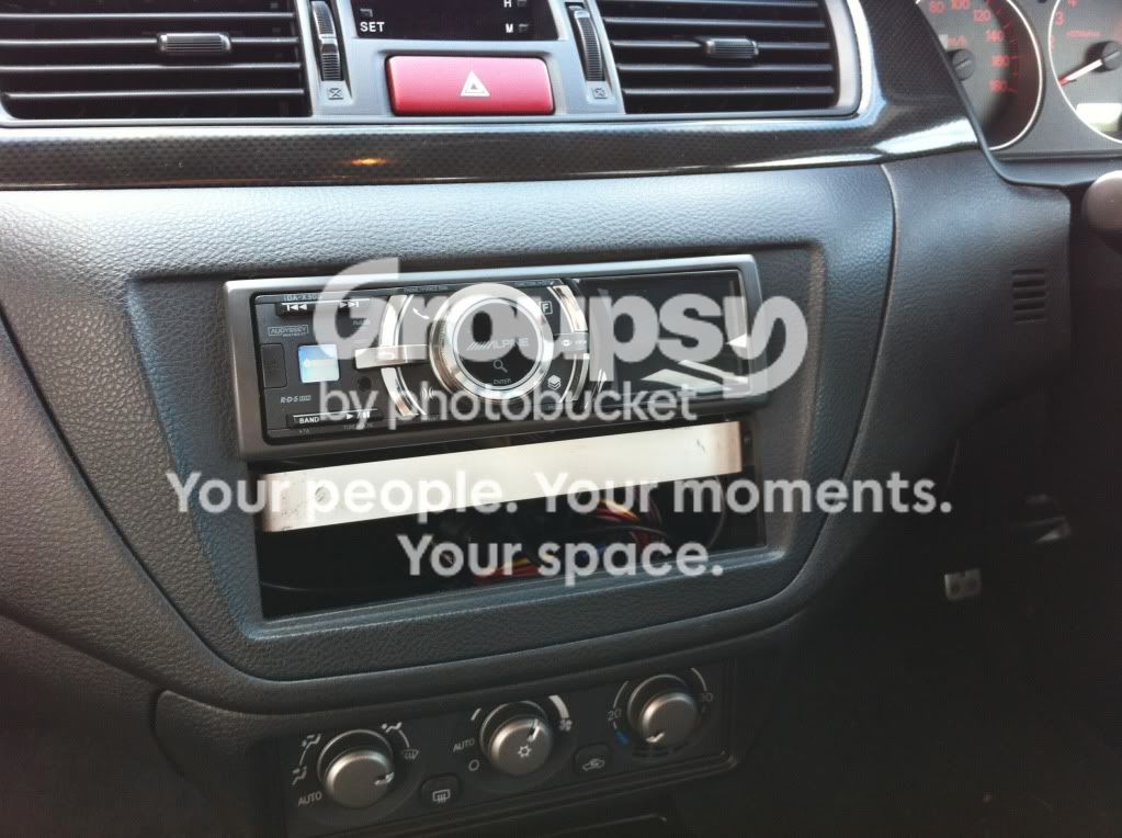

And yesterday the present to myself arrived
Once my Stainless steel bits arrived, i'll fit it
