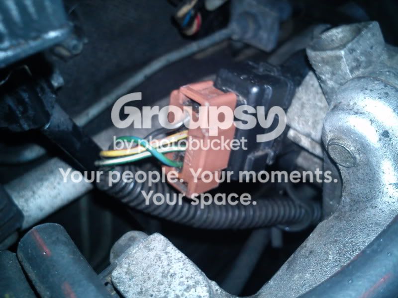

nice 1 ok, em sorry to sound like a tube but im asuming i keep the plug connected and turn ignition on and measure by slightly breaking into the wires? which wires should i test for voltage? im just asking cause if this rain goes off then ill run out quickly and test and would help knowing exactly which of the 4 wires i should be testing.
And@fcm
And@fcm
yeah keep it connected, you might be able to push the meter lead in to the end, if not push a paper clip in, instead save breaking the cable cover, you have 4 wires? are you sure? can you take a picture

ok heres the pic buddy there is defo 4 wires there lol unless i am looking at the completely wrong part
And@fcm
And@fcm
ok from the wiring diagram in the manual it appears that the wires are as follow
Black = ground
Yellow - red = 5V
Green - L = another ground from the variable resistor
Green - White = throttle signal

ok so im guessing between black ( ground ) and green/white ( throttle signal ) is were i should measure for the variation in voltage?
