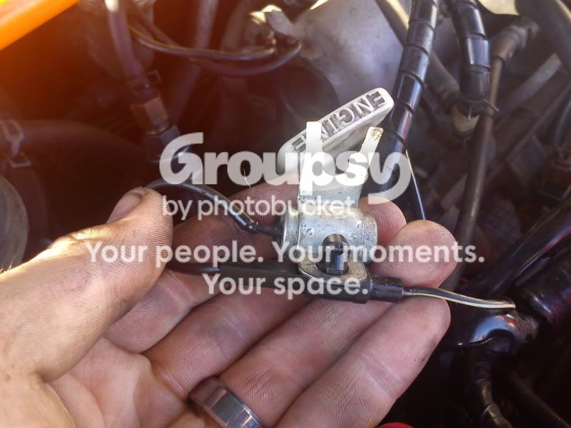

were does this go??? its just dangling around, it comes out the loom were the injectors come from at the timing belt side.
also when i came home from work i started the car and revved it slowly about 7 or 8 times over 2k no problem, then it started the 2k thing again so does this sound like a temp problem?
the fuel reg and map sensor both have important jobs to do so yes it will effect your car if they aint doing there job
not sure what that is but i do know it goes under the head of the bolt that is holding the top of the cambelt cover on :)
