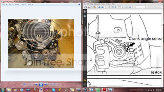

I'm starting to think it's crank walk...I think the crank moved the plate over and smashed the sensor. Only thing is, I really need to see a picture of where the hell it is down there!?!! lol All I see is a crank pulley down there when I removed the wheel and plastic cover???

I'm sure if it was a snake I'd be bitten by now but I just can't see the Crank Angle Sensor....when I look at the side of the motor that is all that I see in the shot of the side of that engine. I see where the diagram is pointing but its just not adding up:(

Here you go....
I just cropped two pix together...one from the technical manual saying where the sensor should be, the other of an actual engine I grabbed a pic of. That's EXACTLY what I see when I look at the side of the engine.

It's just a pic I snagged of the interent, maybe someone can circle exactly where I need to be looking on the engine.

Can you guys see the pic a little better? Has anyone found a pic of the Crank Angle Sensor for me, it'd help me tremendously. Is there anyone that can help me with this. I just want to know where it is?
I really think this is the crank angle sensor. PLEASE HELP, we have 5 pages of talking and I believe it's all the for crank angle sensor LOL. Help me out guys, it's been too long since I heard her purr!

Bearing in mind that you need to be looking at the picture as that is what I am going by, the diagram is 100% correct but what you need to understand is the it relates to what is BEHIND the Crank Cover.
You need to remove the Crank Pulley and the Pulley immediately to it's right and the pulley that is above it to the left.
Once done, remove the black cover and the Crank Shaft Sensor will be revealed!
It is attached with 2 X 10mm bolts beside the pulley that is to the right of the Crank Pulley (the one that is a golden copper colour in the photo).
A bit of a job to do this, but see how you get on and please keep us posted buddy.
