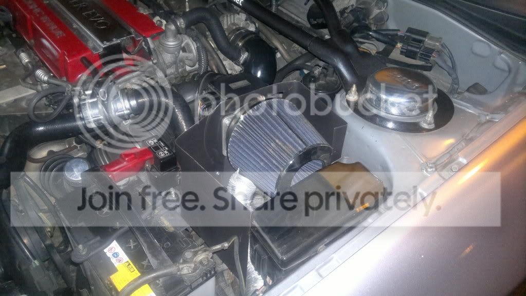

been thinking about making one for some time now but after getting want seemed to be heat soak when road mapping after sitting for 5 mins thought i`ll give it a go see if itwould help

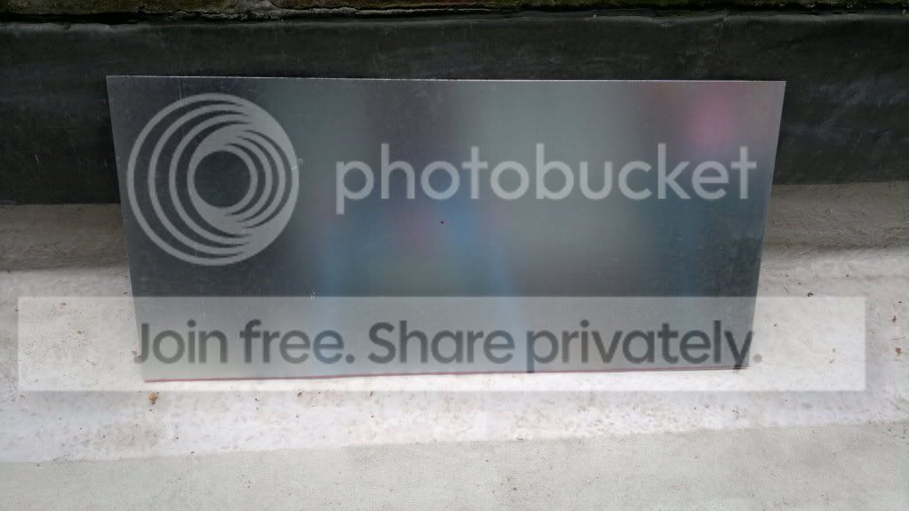

Started with a bit of sheet metal,

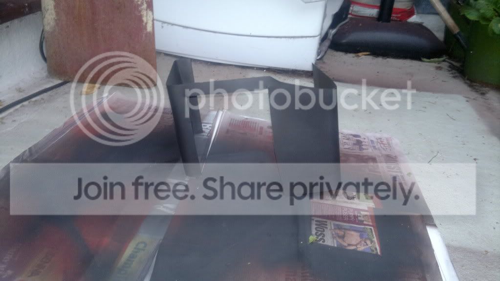

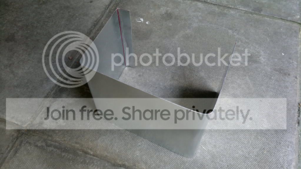

Then folded to size

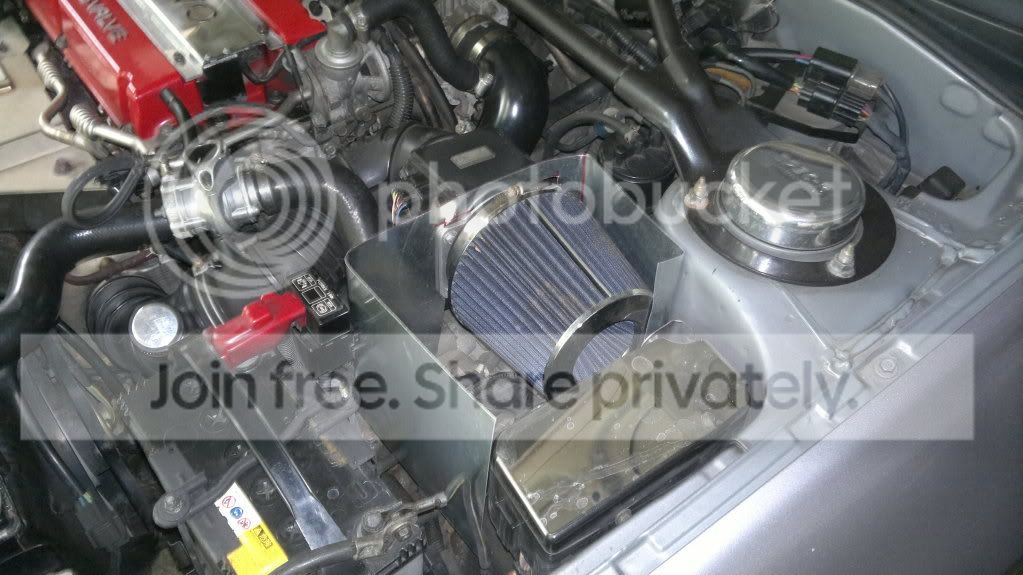

made sure it fitted and cut round the maf

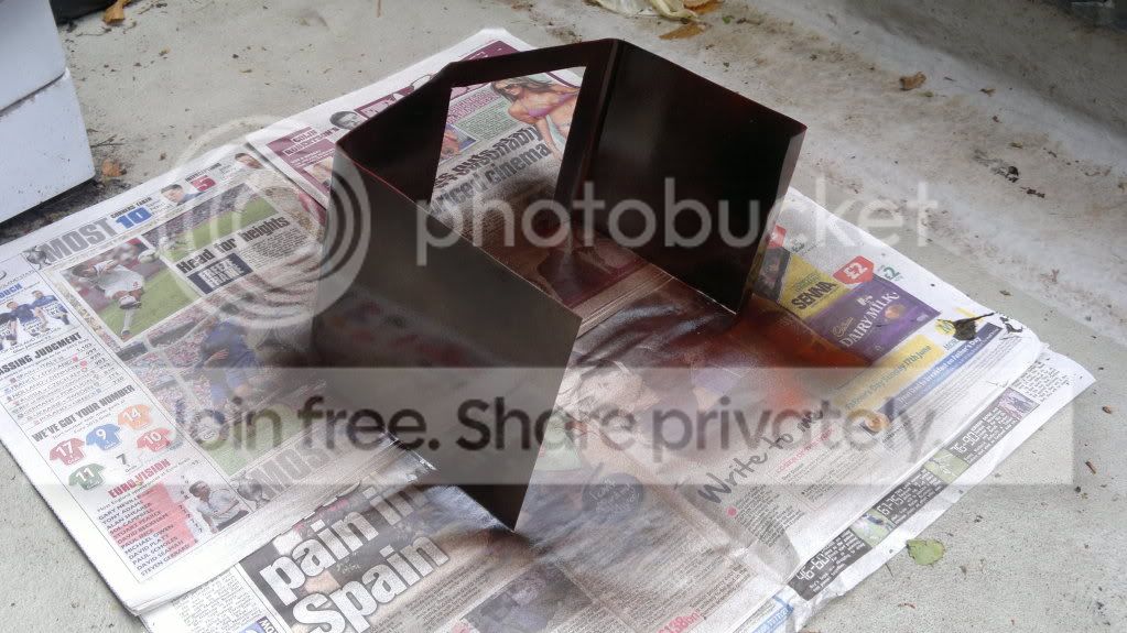

after a couple more cuts to make sure the bonnet would shut it was ready for painting.

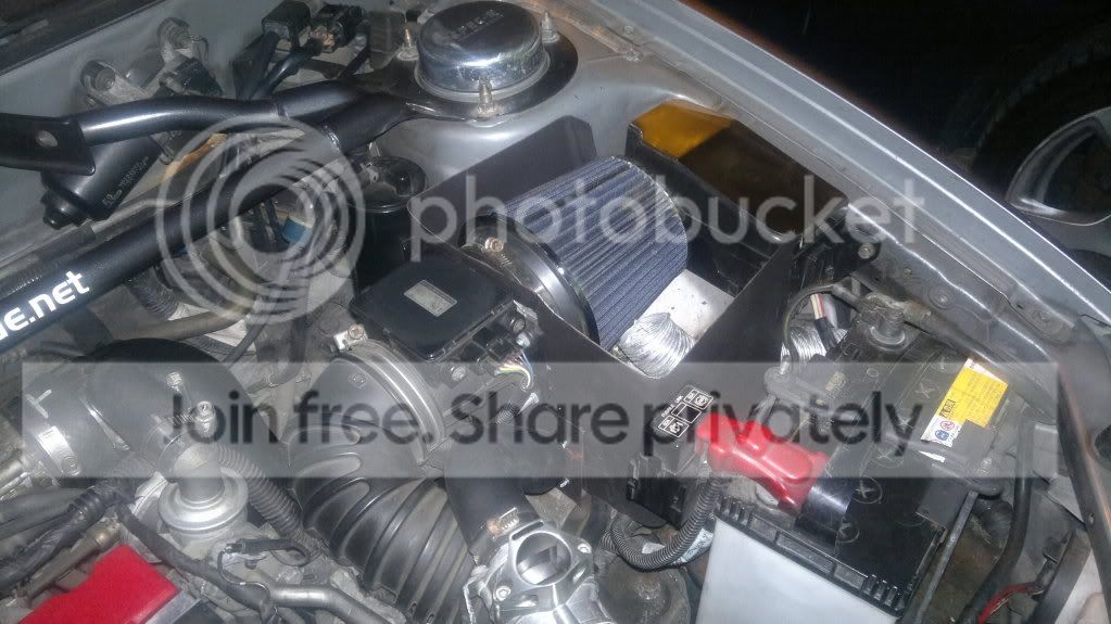

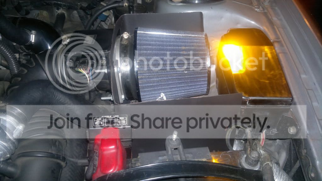

then fitted
the boonet inlet is above and iv`e put a 50 mm flex from the front of the car, just worried it mite trap the heat?? look`s good tho i think.
