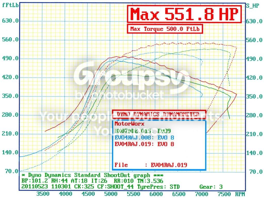

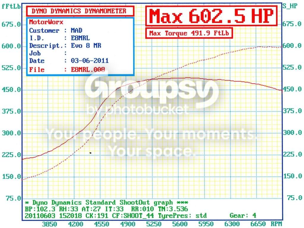

A 2lt with a GT3076 and a BW S200sx on a E8 and twin scroll and the GT3071 is on a E9 and single scroll.
Mark
Mark.. what boost were you running on the GT3076 to see this hp?
Cheers.. Steve
