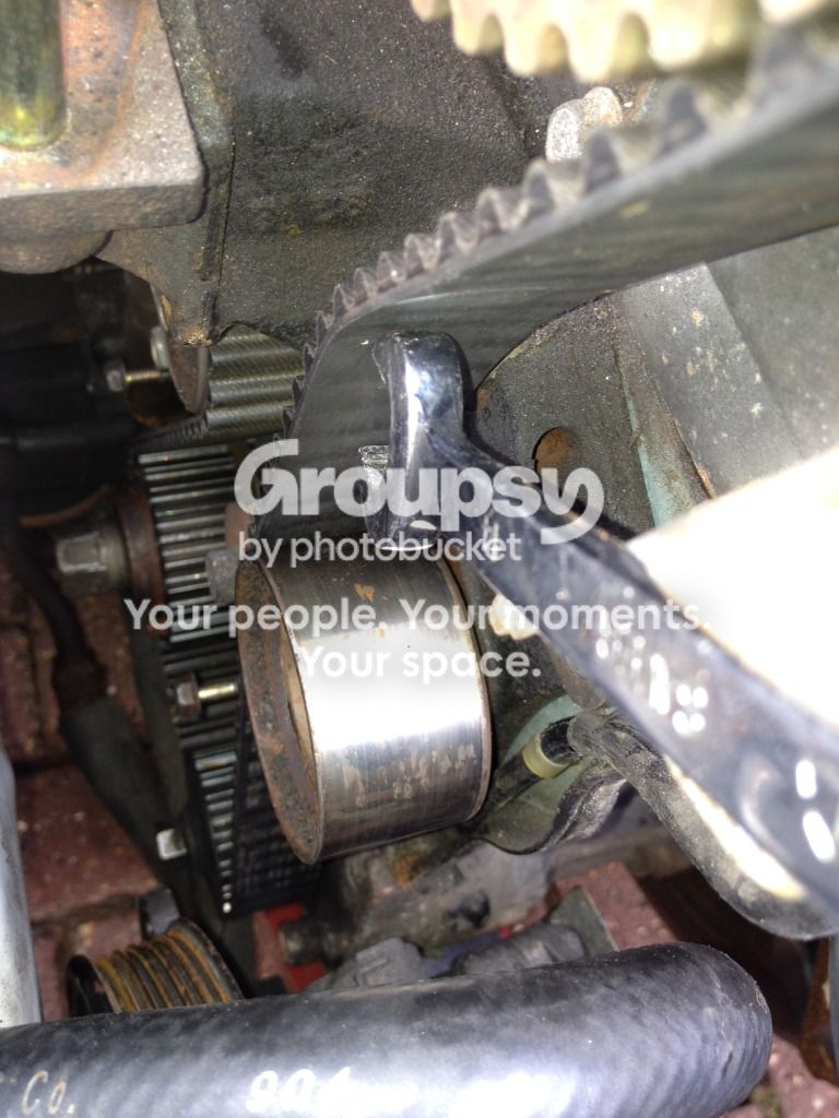

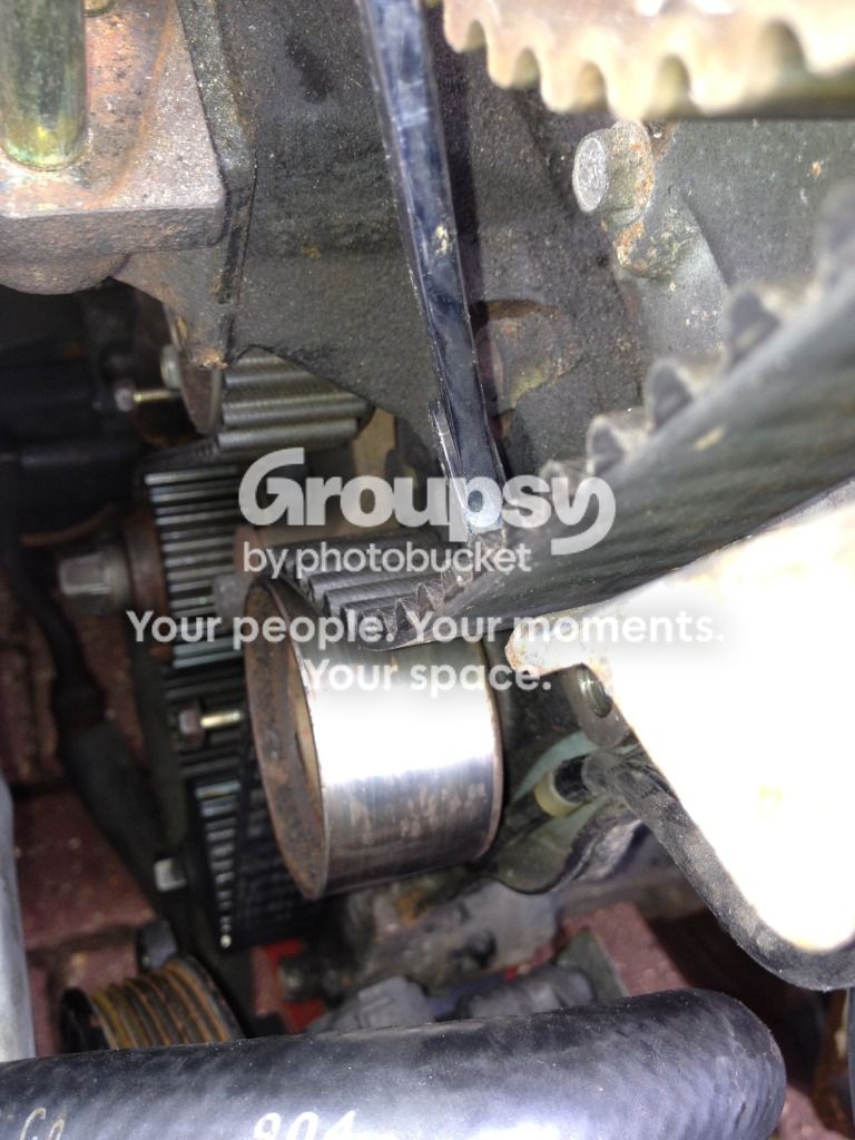

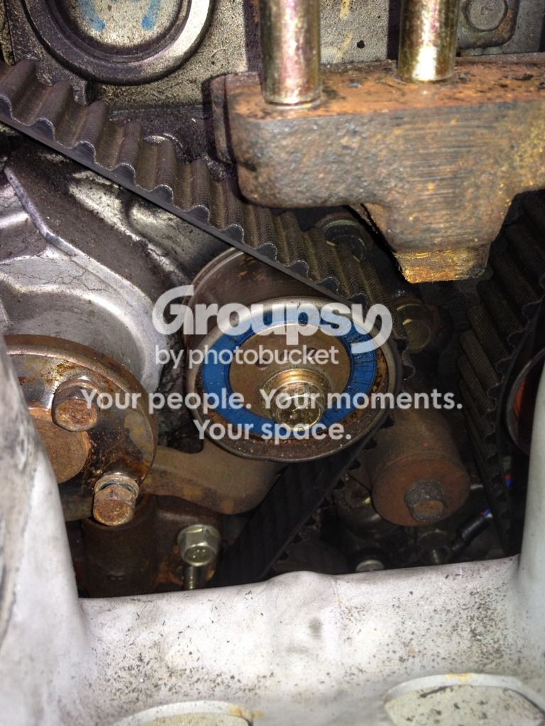

Valid point, I think I will do that as it'll give me a quick answer. The tensioners not doing anything at the minute, the bolt felt tight but I didn't check too hard. I'm not sure about the auto tensioner yet. I've been over the manual quite a few times, the last chain I did was a gearbox off job so glad that's not the case on the Evo !not a good sign :O(
can you not just time that belt back up just to check it if its not damaged with out undoing the crank bolt ??
and aint the 2 small holes in the tensioner pulley ment to be at the bottom / turned anti clock wise to tighten if i remember right .... check the manual ???
and is the plunger still working in the hydrolic part of the tensioner ??
