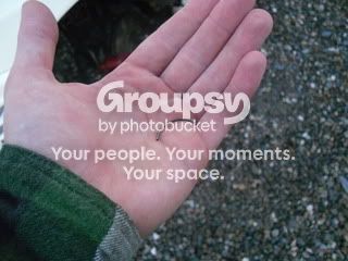

Basically it's half a circlip that I found in the CV boot when I cleaned all the grease out. And yes, the car is lowered. Time to pull the boot back off. The advice is much appreciated.

A few minutes and the boot was off.
Like I said, literally half a circlip.:blush:
