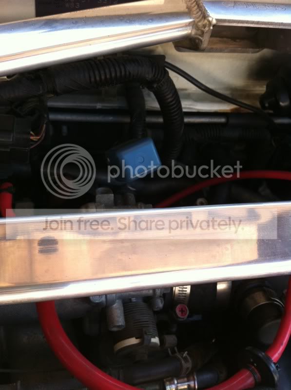

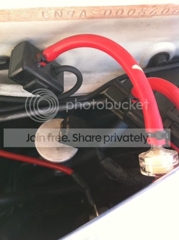

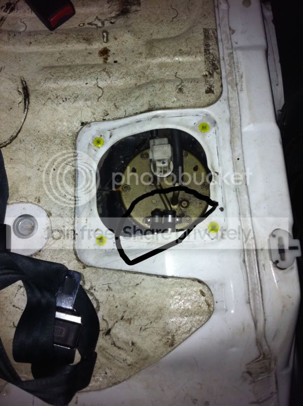

Do is look like my fuel pump has been changed before??? I though the Evo 4 had hard pipes all the way to the fuel pump? :confused:

pretty sure the cam sensor is also a 5v quare signal, but if your not getting any fault codes then I'd just try another cam sensor off a mates car.
if the fuel pipes have been cut then it probably is a uprated pump, but you wont know for sure unless you take it out.

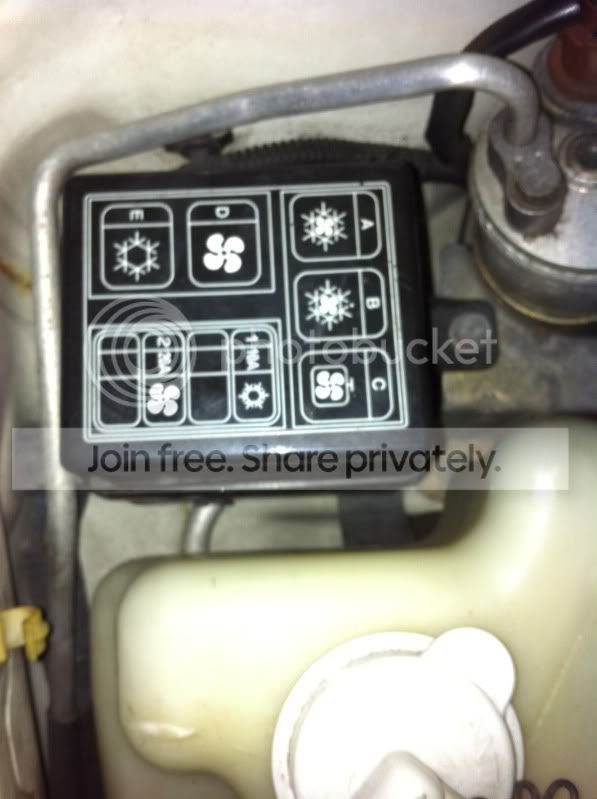

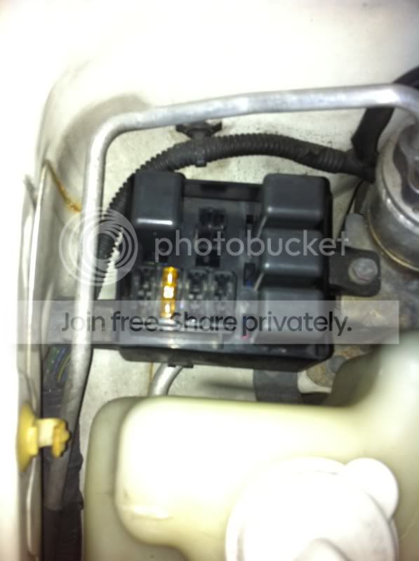

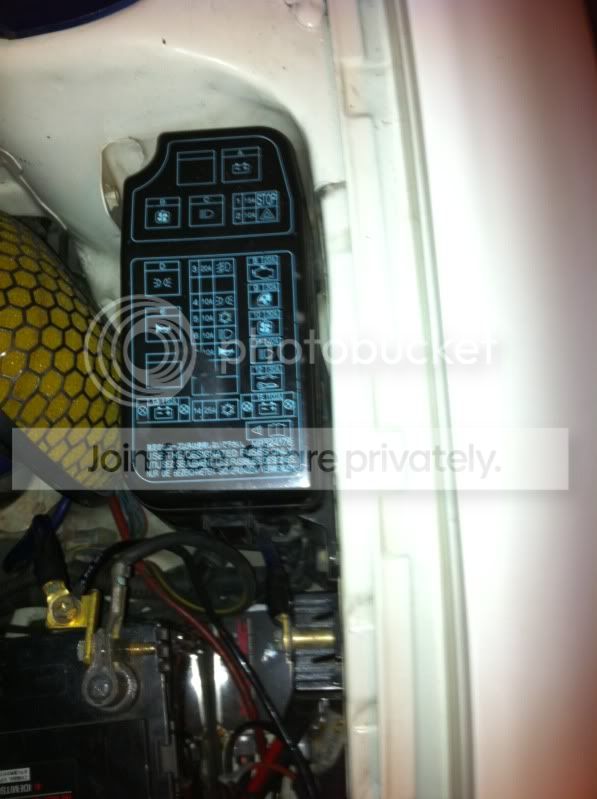

I haven't had a way to measure actual fuel pressure. A little confused on the set-up as a whole, I did notice a missing relay though?! I replaced the CAS, and still no start but turns over perfectly! Here's some pics of where the missing relay is.
Which ones can I pull to test it out and crank up w/o hurting something??!
Tried to swap the above relay to see if I got a start but nothing, I think that's the ignition relay.
What are these two in the corner?

the grey one is the fuel pump speed,
the other 2 I think are ignition and fuel pump (main)
I'm sure El will confirm as hes fiddling with these daily.

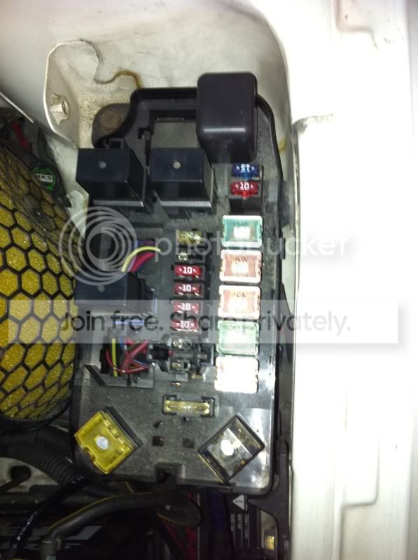

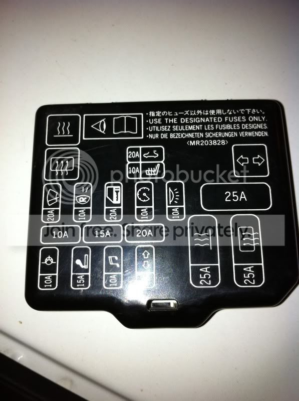

In the fuse box (right hand side of the engine bay) there are 5 fuses on the left hand side which are all around 20-30 amps if memory serves, can you check that the top one is OK (engine Management Symbol) and get back to me please.

So if that relay was missing...the car shouldn't start at all, right??! haha Idk how long its been gone.

The fuse I was talking about is in the first fuse box pic you have posted up. It is the fuse that is located on the top right (the cluster of 5 larger sized fuses, not the smaller blades) and is represented on the fuse box cover with the Engine Management symbol.
It may be irrelevant now as I have since read that your car did fire up in the last week or so. Check the fuse anyway and ensure it is fully connected/not blown.
Again, I suggest that you try to start the car with a fully charged battery as it makes a hell of a difference over a Charger.
When you have fully charged the battery, ensure that it is holding charge and attach the booster pack to the terminals too as this will ensure a better regulated power supply.
Oh okay, yea I've checked and switched that fuse around to try to get it to fire up, definitely a now go.
