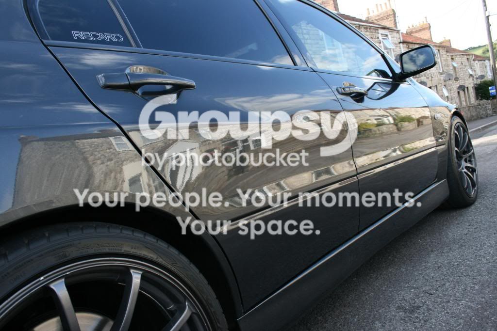

Nope they are the perfect size! got those on my VI but with 225/40/18
you can run 18x9 et30 on a 7/8/9
original evo 9 wheels are 17x8 et 38 so will basically just sit out 8mm further away from the hub :)
