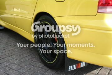

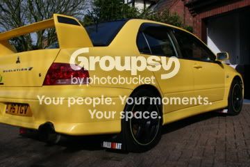

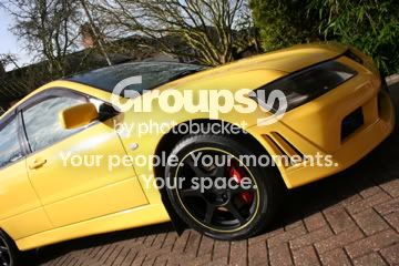

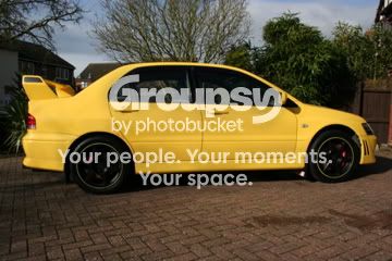

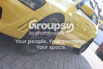

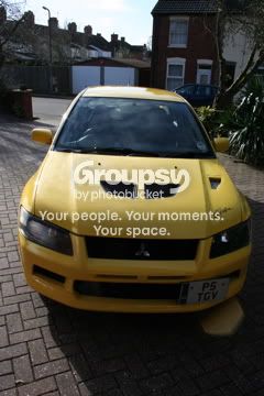

Well here we go then, Full clean and on with the refurbed VIII wheels.
Snow foamed
Clayed
DA'd Both to de-swirl and Polish
Finally DA's to apply wax
Evo VIII wheels were stripped and sprayed satin black with a yellow Rim.

Looks great that Paul, what pads and polish did you use oh and wax, and did you use a microfibre on the da to take the polish off?
cpt jack sparrow
cpt jack sparrow
All Meguiars Products. except snow foam
NXT shampoo
Meguiars clay bar and quick detailer for lube
Meguiars DA, with yellow pad with Ultimate compound
then Black pad with NXT to polish and wax on, Micro-fibre by hand to remove wax once ready.

looking good mate like the yellow rim good idea
im thinking of painting the team dynamics in yellow thats imbossed around the rim
