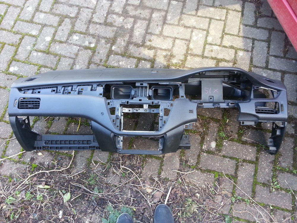

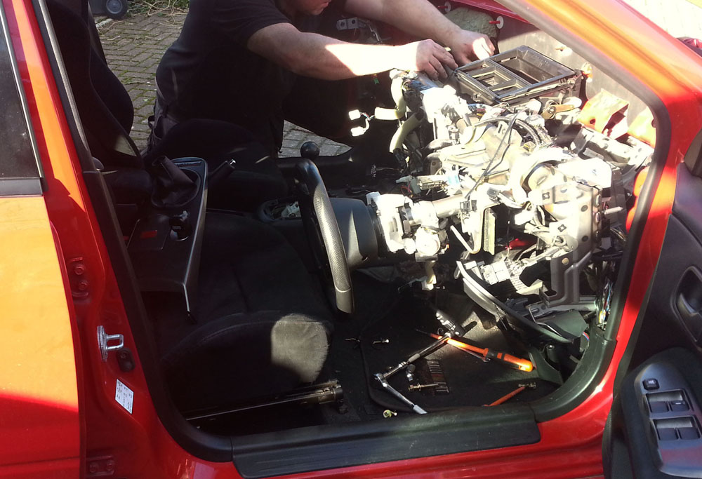

deanmac
deanmac
What a shit job changing the heater matrix.
I had to remove the whole dashboard drop the steering wheel remove cross member and blower unit. Then there was Just about enough room to extract matrix with a little movement on air con pipes.
About a days work
