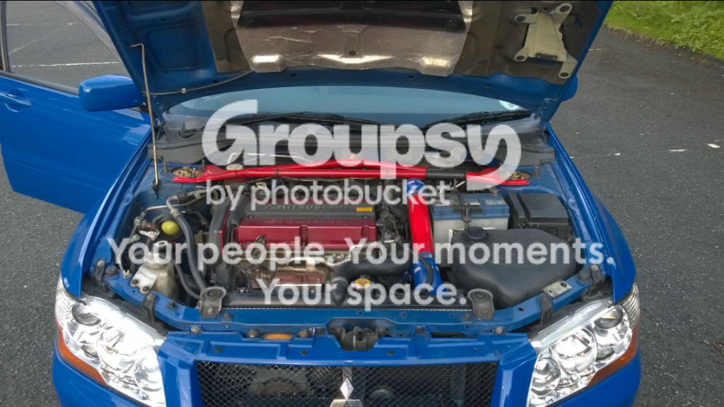

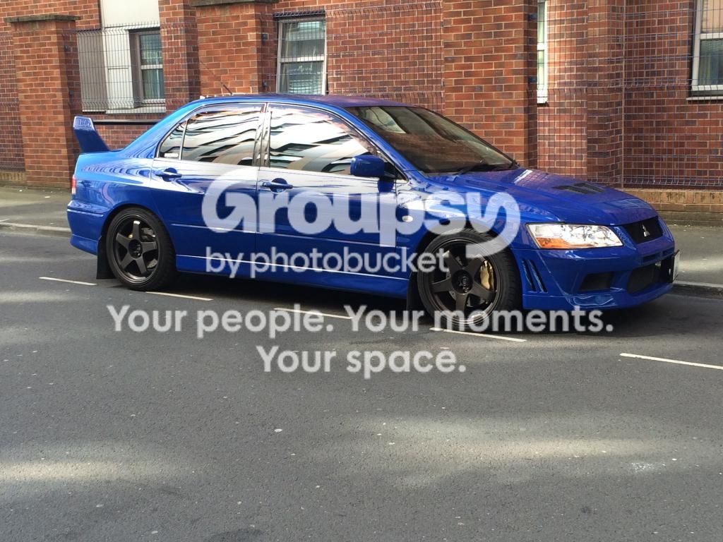

Right here the spec nothing to fancy but room for minor improvement,
2001 jdm imported in 2008
Upgraded bits are
Aps direct cold air induction
Aps ic water cooler tank,
Aps intercooler
Hks 3" exhaust full decat
Samco hard pipe kits
Hks dumpvalve
Hks turbo timer
Blitz spec s boost controller
Tein coilovers
18" wheels
Apparent it's got a cusco diff fitted but there's no proof of this in paper work I've no way of doing a visual check unless I strip it down...
Bad bits no sign of mapping, tracking needs doing and acd button isn't working I told this is because tits fitted with a cusco diff imo it's just needs replaced as it's probably screwed but there are no dodgy noises coming from it!
