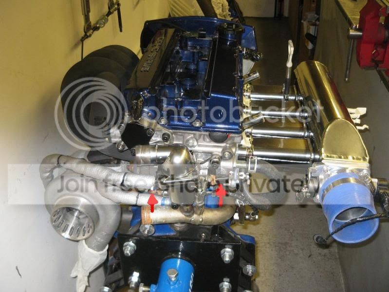

doubt the issue is with the plugs if the car is fine when warmed up.......although strange that its started since you swopped the plugs.
.....poss engine temp sensor?

Perhaps you're right buddy on the temp sensor, something I forgot to mention...... I would be very much surprised if it is.

That is a good point about the temp sensor. Where can i find it in the engine bay?

the one at the front goes to your gauge, the one at the rear is the one your interested in.
