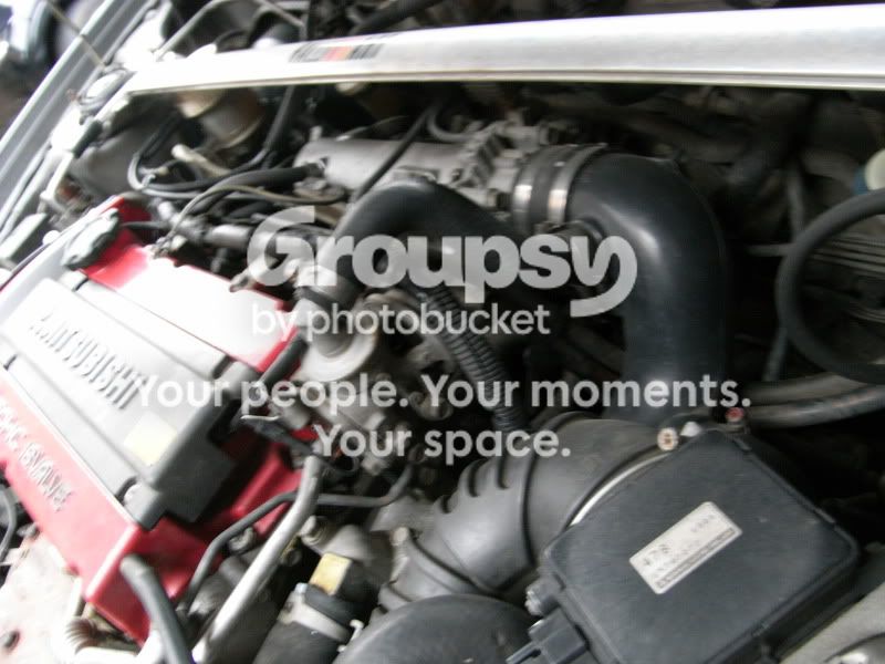

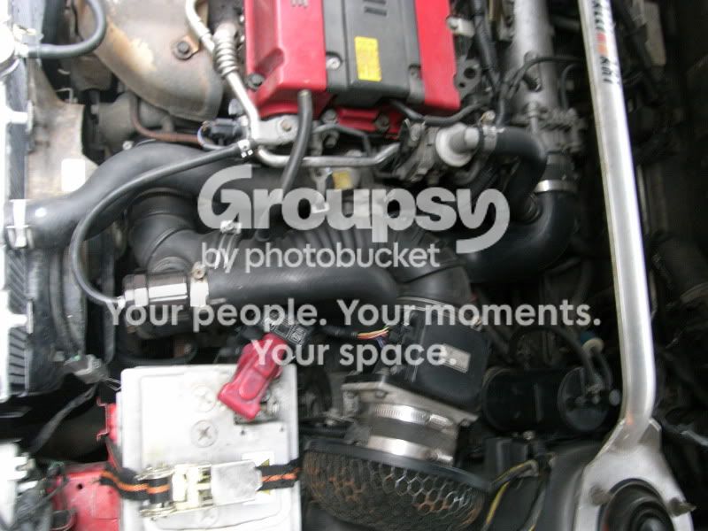

Can anyone tell me where the dump valve is so I can let you know what it is?
P
prone
101
Redhill
ok, so the dump valve is made by forge motorsport. Is that any good?
