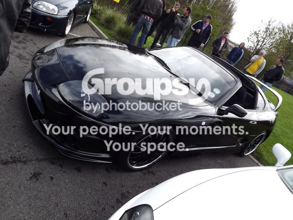

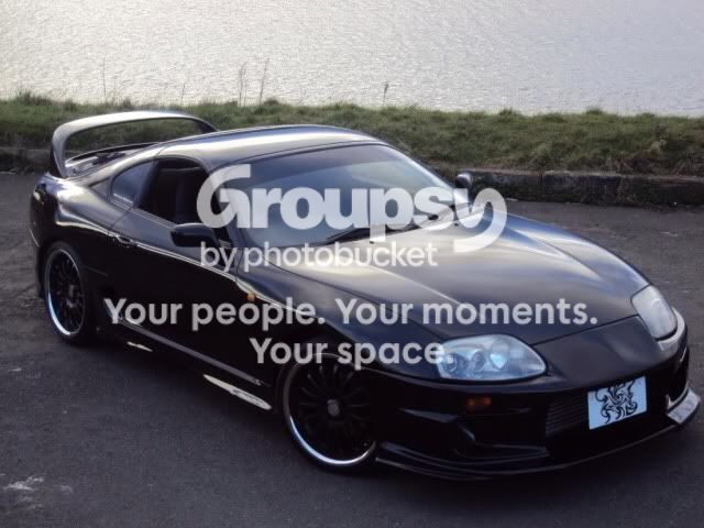

This is my Toyota supra all work has been done by myself. I've owned this for 4 years now and it started life in my hands stock.:)

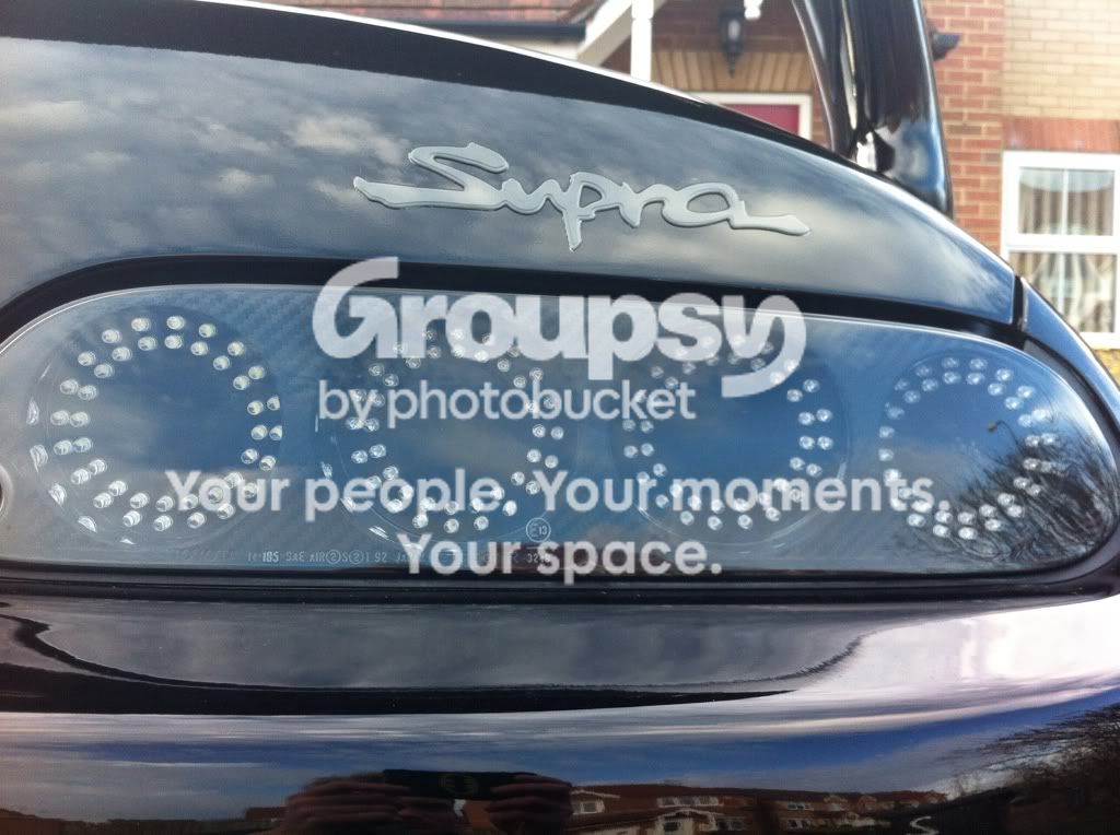

Custom tail lights:

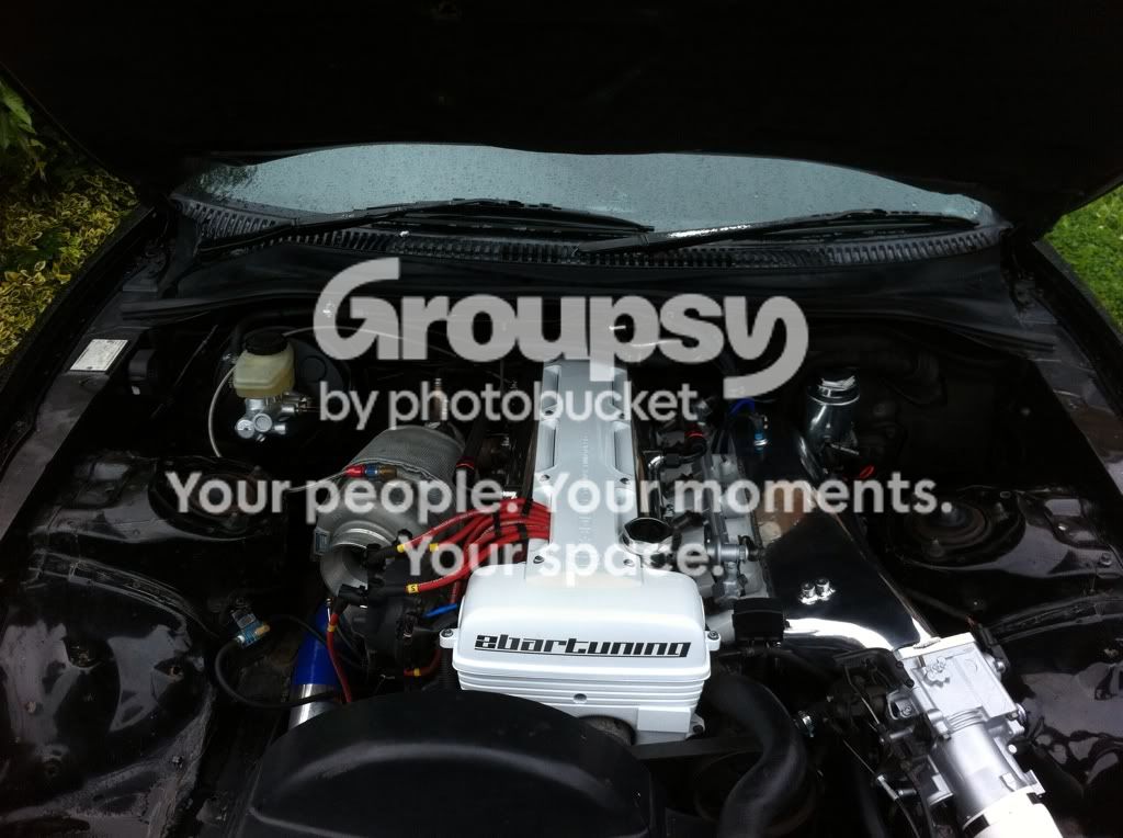

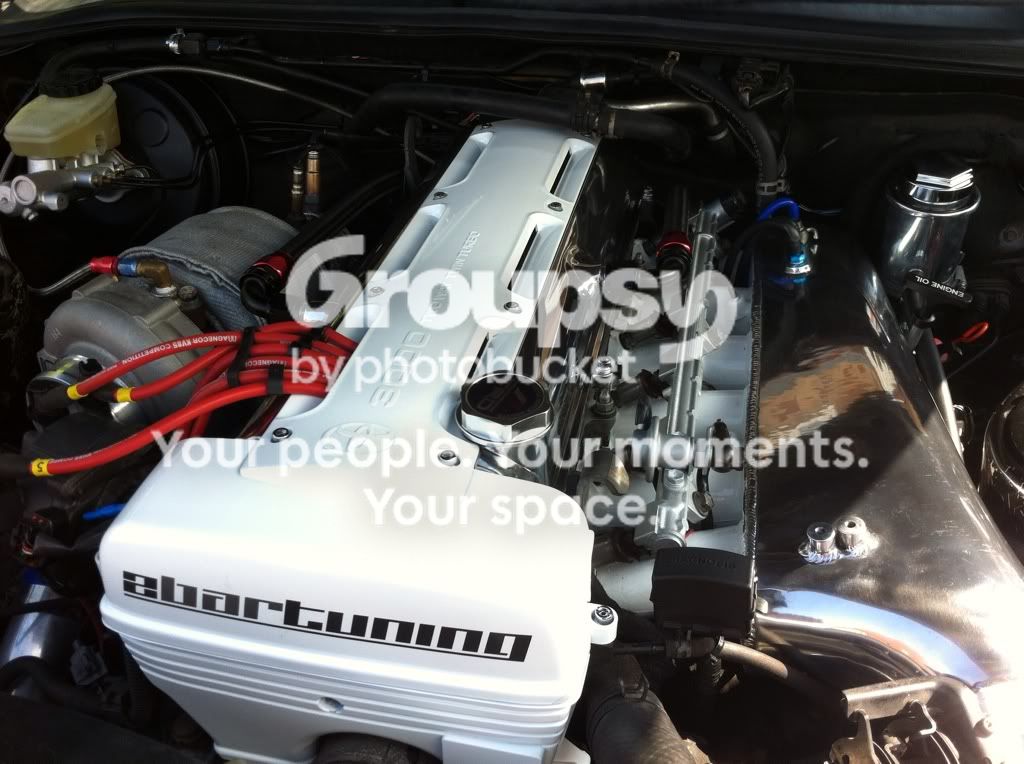

Thanks mate,
High compression 2jz-GE
I've fitted the T-61 big single turbo conversion
3" down pipe
3" mid pipe
Nur spec R exhaust
Greddy emanage ultamate ecu
8.5mm ht leads
4runner distributor cap
Custom front facing inlet manifold (FFIM)
AEM wideband
AEM tru boost
Full wire tuck, removed abs system ,relocated battery, relocated fuse box, relocated relay box, relocated pas tank, removed charchole canister, relocated ignighter, and relocated coil.
It still needs the engine bay smoothed and painted and a few things tidying up but its getting there.

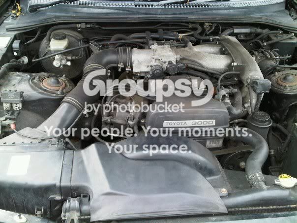

Here is a picture of the engine before:
