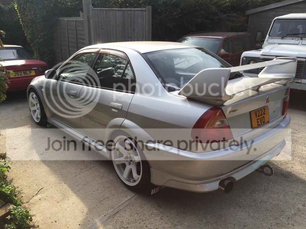

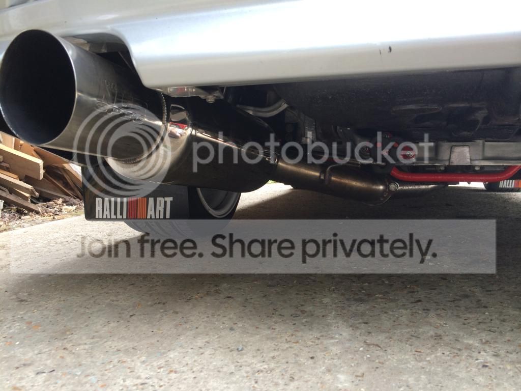

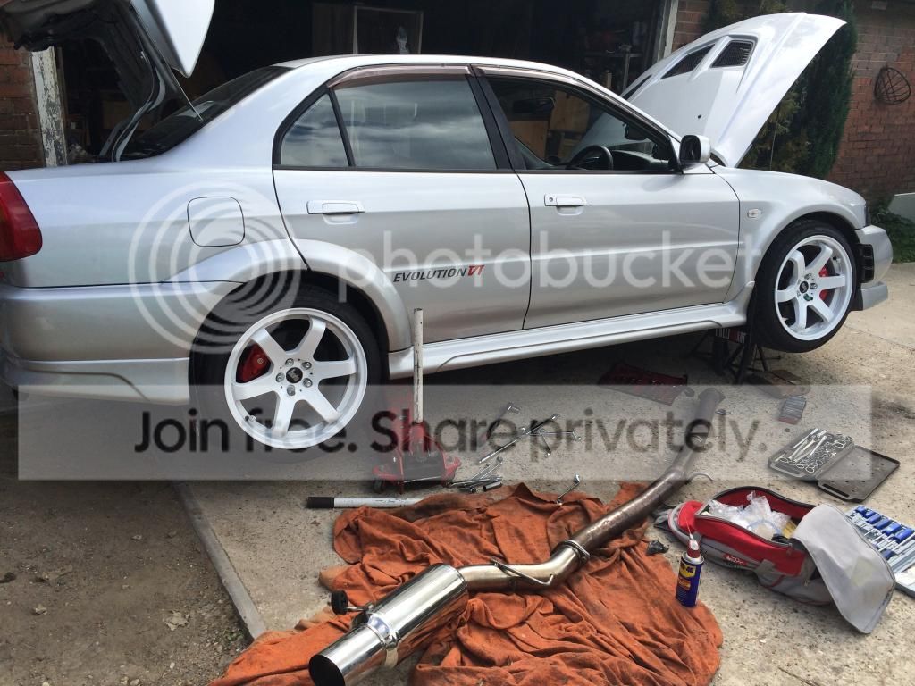

So after rejecting a garages offer to fit my blitz exhaust for £50 lol I thought id save my pennies and do it myself........as usual :)
Car in the air ready for the fit
All done and sounding awesome, not sure why some can't live these systems it's fine tbh and makes the Evo sound like a proper terrorist! Although subtle in 5th gear I found.

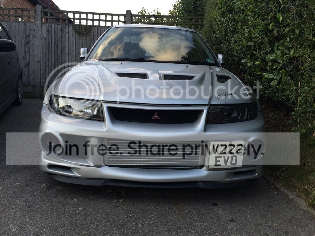

Offered the one piece headlights today, got one in fitted bit of a ball ache tbh faffing around with lining it up drilling an extra hole on the slam panel and trying toget a nut in place underneath it all before drilling out the rivets to actually get the bloody things in place!
No side light though so that's another issue with these to sort.
Anyway one side fitted and I'm liking the look.

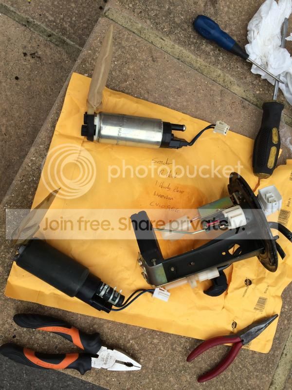

Fitted my Walbro 255 pump at the weekend cheers Rich, also fitted the Blitz induction filter aswell.

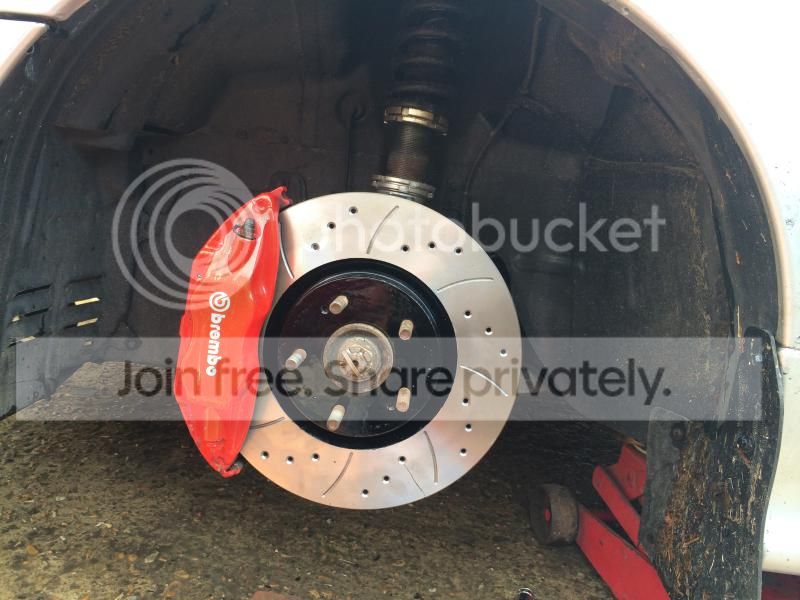

Busy day tomorow awaits me, new discs and pads all round with painted hubs to avoid the dreaded rust look lol

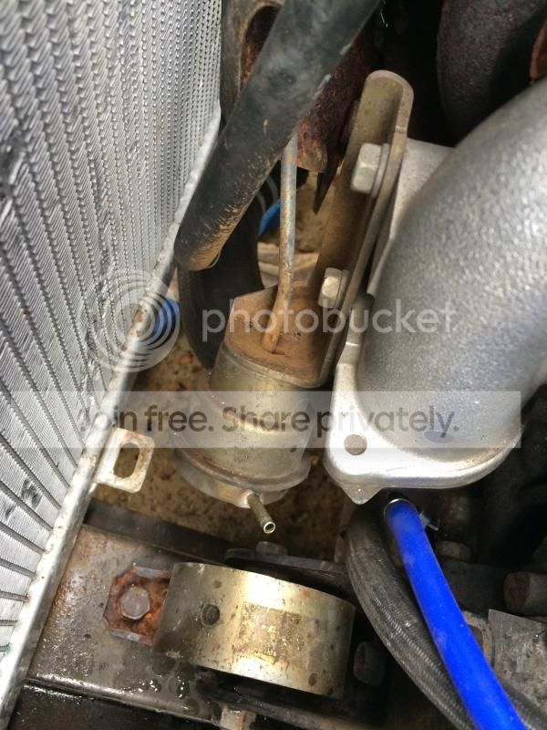

Plus a new Forge actuator to fit in time for remap next week....

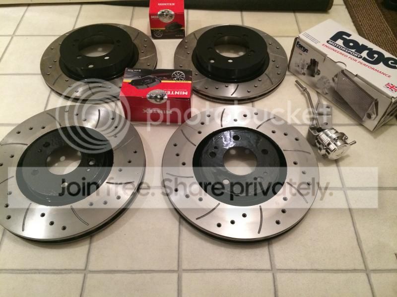

Been gathering a few more goodies recently including this at a bargain price :D
and it turned up

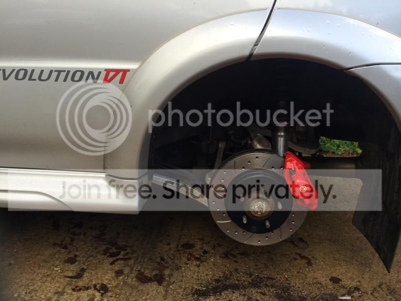

Next up fitted my discs and pads all round whilst avoiding the god damn rain :smthumbdo
Then the horrid fiddly job of changing the ****ed actuator to the forge, ballache! Now im set for mapping at Dynotech at last..

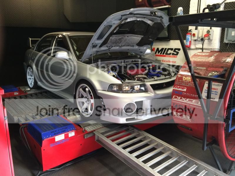

Finally had the Evo re-maped today with a mixed outcome but overall happy as the car drives so much better now and is even nippier :)
As i can only get 97 ron fuel i had to run it on that instead of 99 v power, the ECU also detected knock which Bob found confirmed it was lash adjusters playing up so the car was leaning off thus dropping power :(
Outcome was 344bhp expected a little more and would have had it but for v-power and lash adjusters not messing about causing knock to the ECU.
It drove home great though, next move is to fit new lash adjusters along with poss mr cams and go again.
Also had pops and bangs maped in but had very little of them on the trip home, these should come though with time...

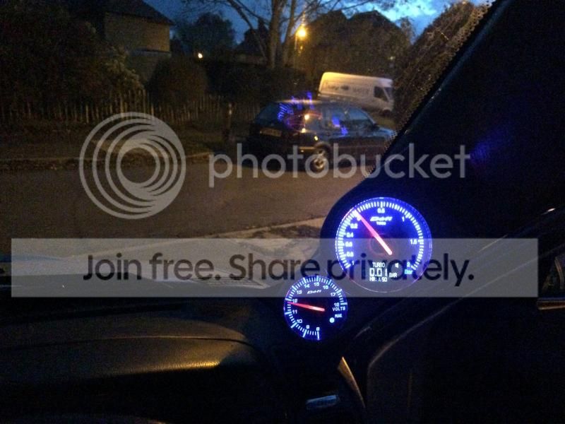

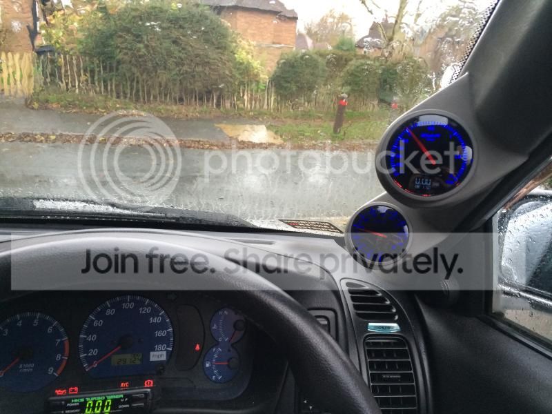

Fitted my Defi guages today, as they were 60mm i had to file the 52mm pod holder to get them to fit but worth the hassle i reckon.

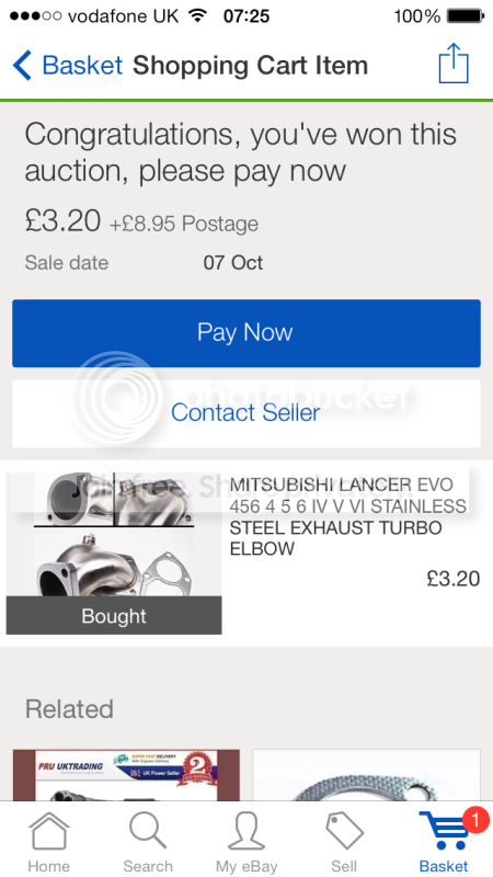

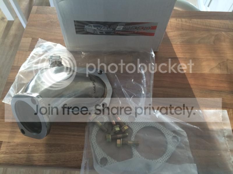

mate the japspeed elbow it's ok on the car?
because i bought one on ebay but i can't fit with down pipe...
