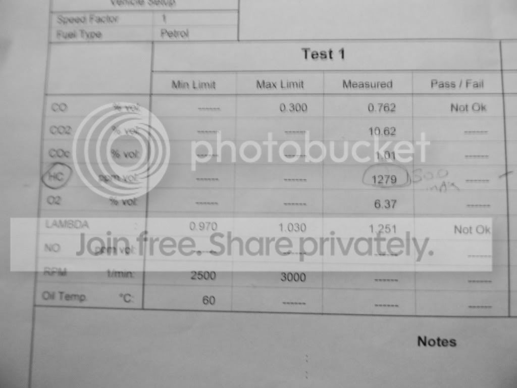

Right I have just had my emissions done on the MOT and its way too high. The HC is 1700 and should be down between 200-300. Im running a 5 ecu (no idea of mapping etc) a magnex down pipe, have re-fitted the Cat (its from a 5-6 and has no bung hole for the sensor, the sensor isfixed so it does not show on the dash board), blitz nur spec-r cat back,272 cams, standard fuel pump and running a maf.

what was emmisions print out? post it up

well one thing ive noticed oil temp only 60 so i assume it was cat tested when cold, so id immagine those figures will drop, looks like theres a cat issue due to th high hc and co
+1
a good thrash before hand might bring it down enough, or worst case need to try another cat on it.
the sensor in the cat is the cat on fire sensor and not a lambda.

Emmissions is down to lambda sensor & CAT, if either does not work, then it will fail. Get the lambda fitted into the turbo elbow as it should be and take it out for a blast to heat up the cat and help bring emmissions down.
You are right in that only the Evo 4 has a temperature sensor in the cat. Lambda sensor is always in the turbo elbow.
