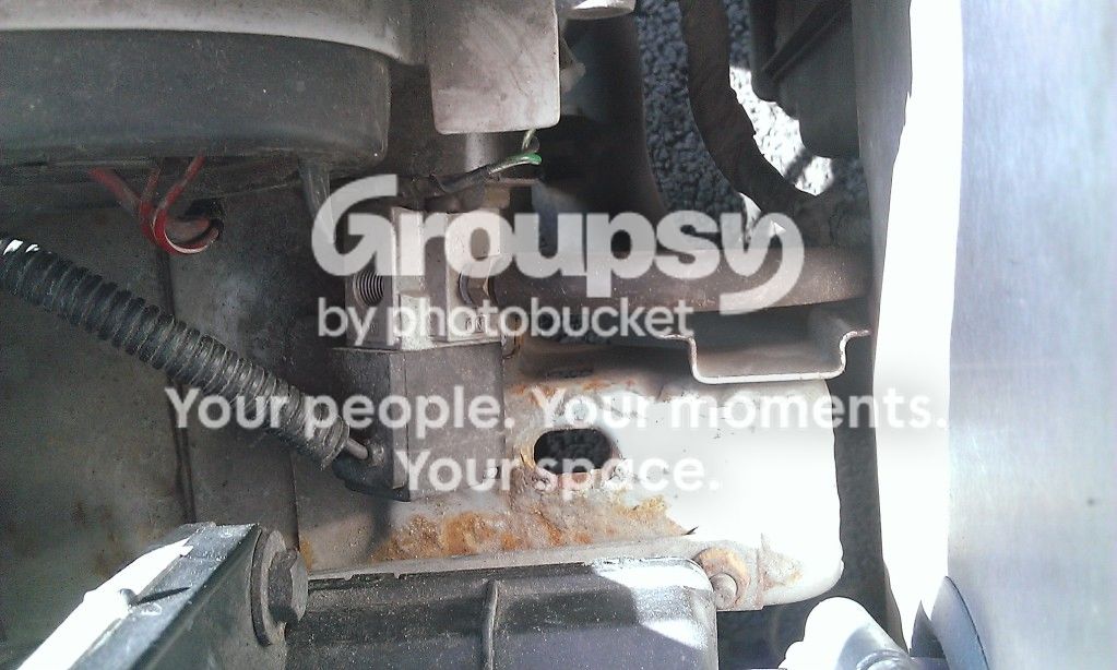

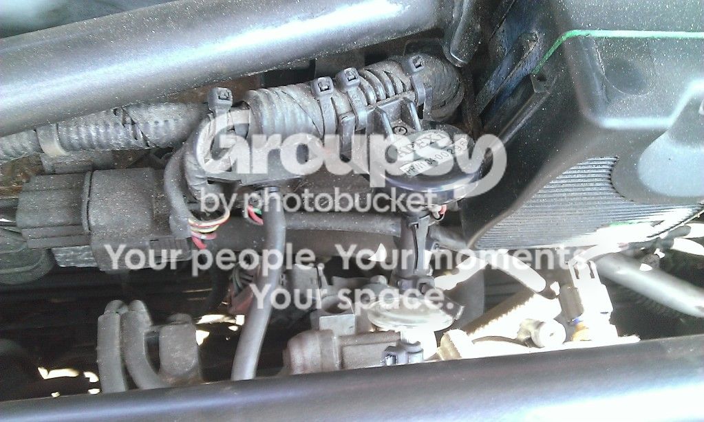

took a couple of pics although not the best. ive found two units next to each other (in the first pic) with vac hoses coming off the inlet, one with apexi on the top and the other just a black box which could be the map sensor, the only other thing linked to any other bleed hoses which I could see was coming off the actuator which im assuming is just the bleed/boost control valve.
two vac hoses going into these two units next to each other one labelled apexi
this I assume is just the bleed valve controlling the actuator

In the top image they are definitely the two boost sensors, one will go to the gauge and one to the ecu.
The second picture has the 3 port which as you said controls the actuator
