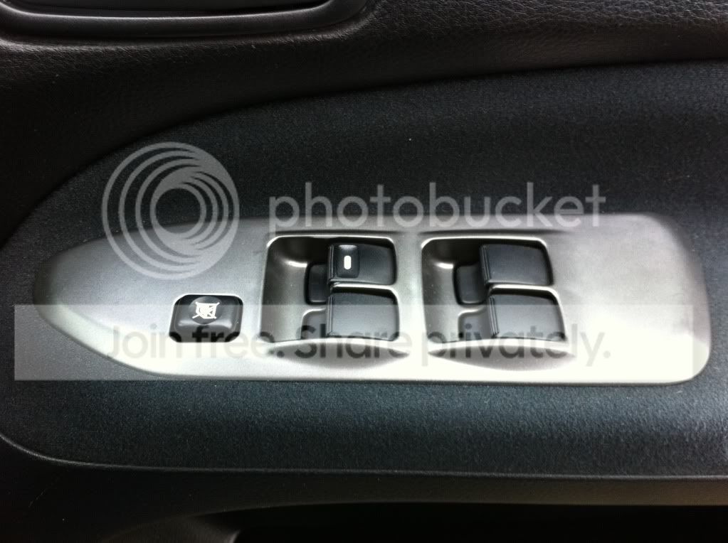

I'm having my window switch surrounds wrapped in carbon vinyl.
So how do they come out from the arm rest on the door? Blunt knife under the edge and lever them up or are they screwed in any way?

Have a look in the hole where you put fingers to close door and you'll see a screw then just pull them out :)
Yea A pillar trim just clipped on :)
The window switch panel is just clipped in and there is 3 or 4 screws on the underside to remove the switches from the panel. Yh summat blunt will get it out, the handle/ pocket has a screw to remove and just pops out too

Right then front switches and double din surround are out. Can't get the rears out though. Managed to get one up but the clips broke and the switch unit seems to be hard to get out when it's attached to the switch surround.
Surely the door card doesn't need to come off.

Ah ok... Odd that the rears need door card removal and the fronts just pop out with a bit of persuasion. Who do the rear door cards come off then?
Undo 3 screws then fingers behind bottom of panel and pull/pop it off :)
they will just pop out mateonce up a lil use ur fingers to push the lugs inwards preventing them snapping
