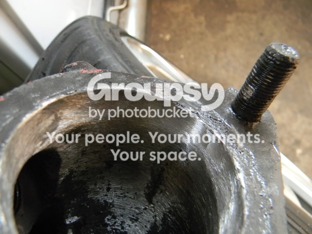

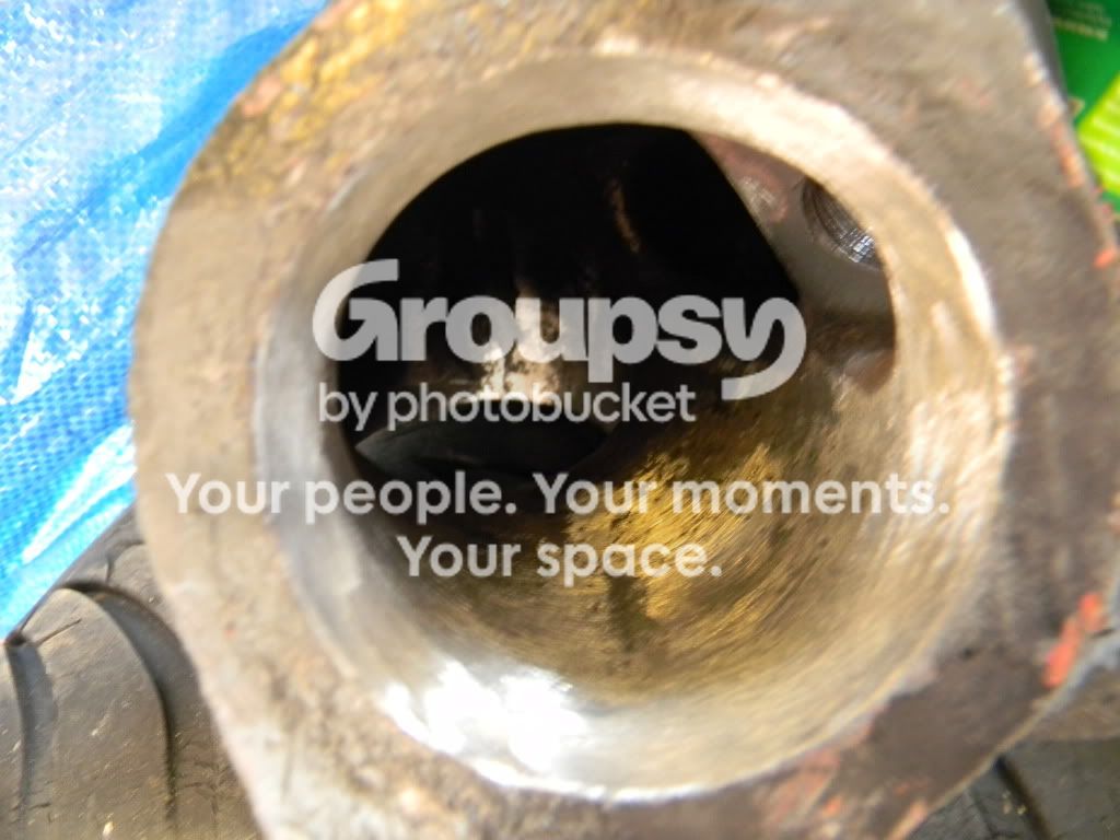

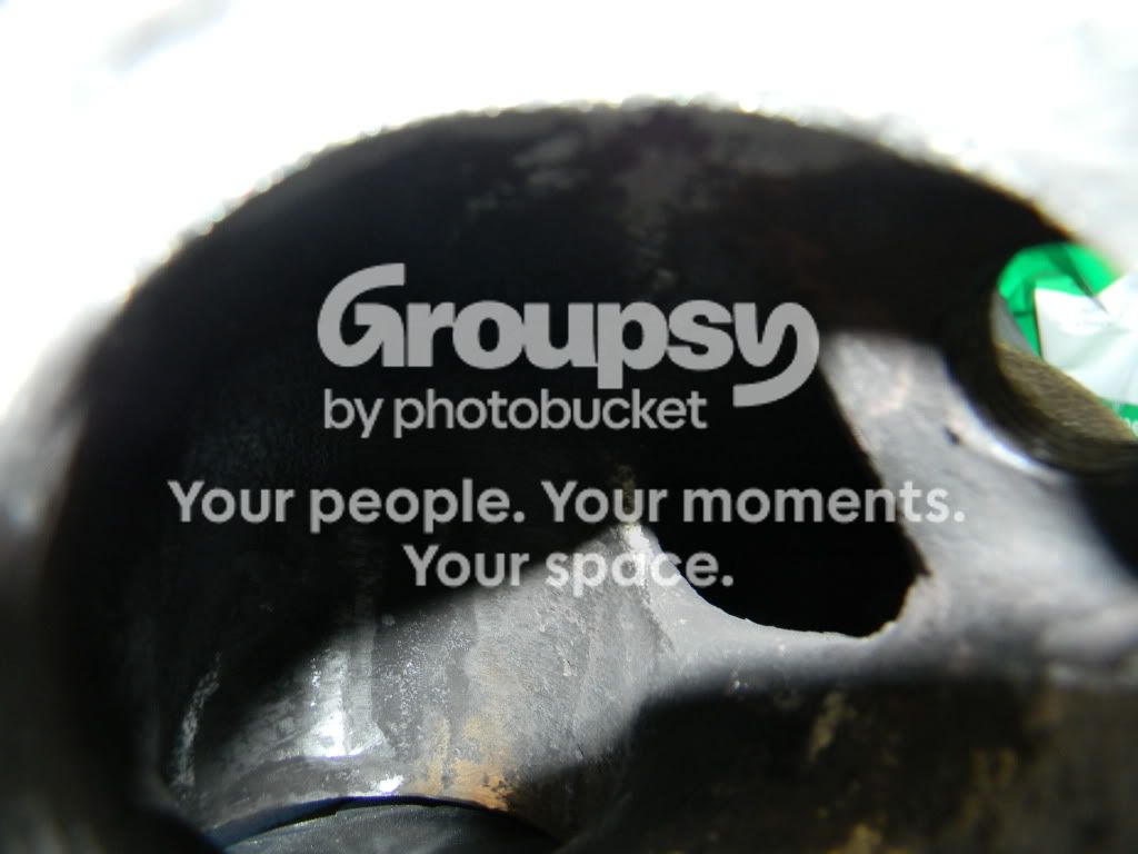

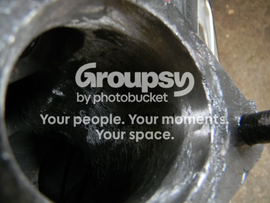

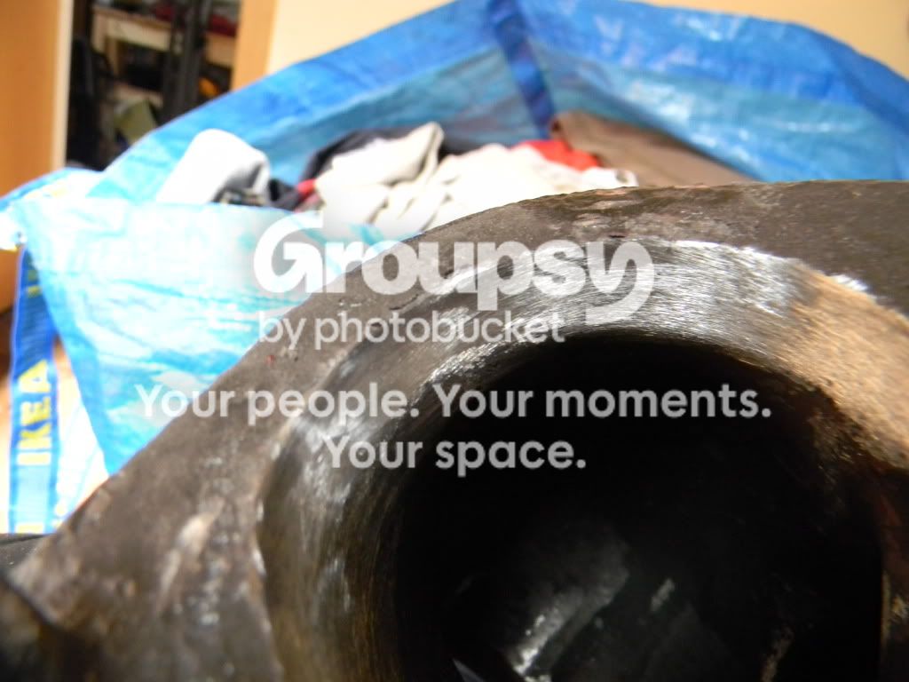

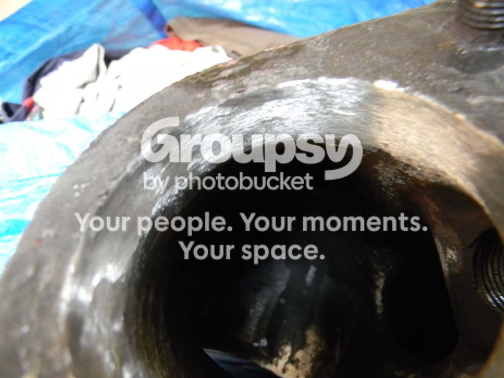

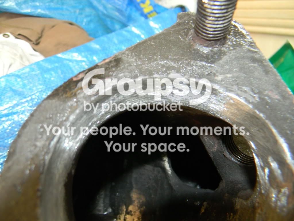

Had a quick go at porting my turbo elbow today, Am I going down the correct route and is there anything else i can do to it?
opened the flange out by 3mm

Looking good but did you match it up to the gasket?
RsvRob
RsvRob
Trying to get a good even flow is best.... from turbo-gasket-elbow. If one is bigger/smaller than the other then the flow of gases is disturbed. Best to have same size from turbo to gasket to elbow rather than just having a bigger port on one of them.
BUT all good fella ;)
