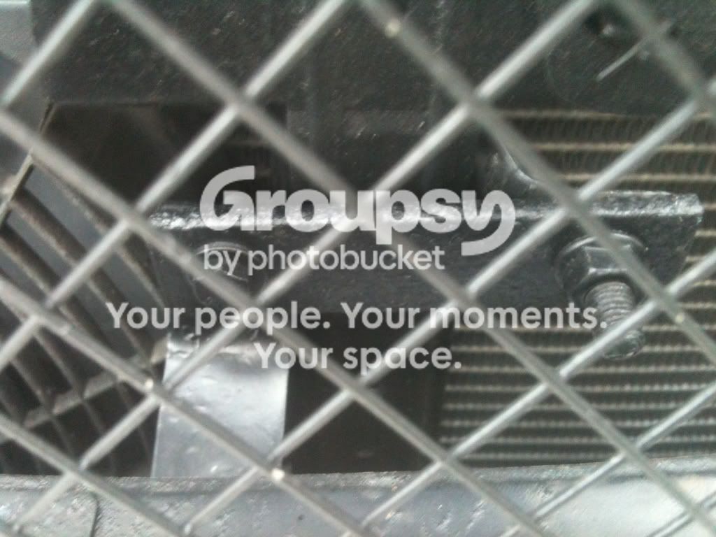

Standard front mount intercooler. Would it be a straight swap with no modifications?
Mickyyy
107
From comparing Intercooler pictures I can see the top bracket is centralised on the evo 8 while on the evo 6 it is to the right.
Bottom brackets will fit and are identical only the top bracket is different
What's the easiest way to modify a top bracket and how without bending it?
Just use a bit of flat metal bar to link the fixing points together.

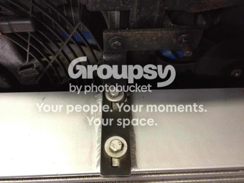

Custom brackets are very simple to do i have made a ton myself. Find your choice of metal from a local hardware store (i prefer aluminum) and if you have a drill and some bits you are all set. Just make sure to measure and mark. Aluminum is very easy to cut with tin snips or a dremel fyi.
Like this
