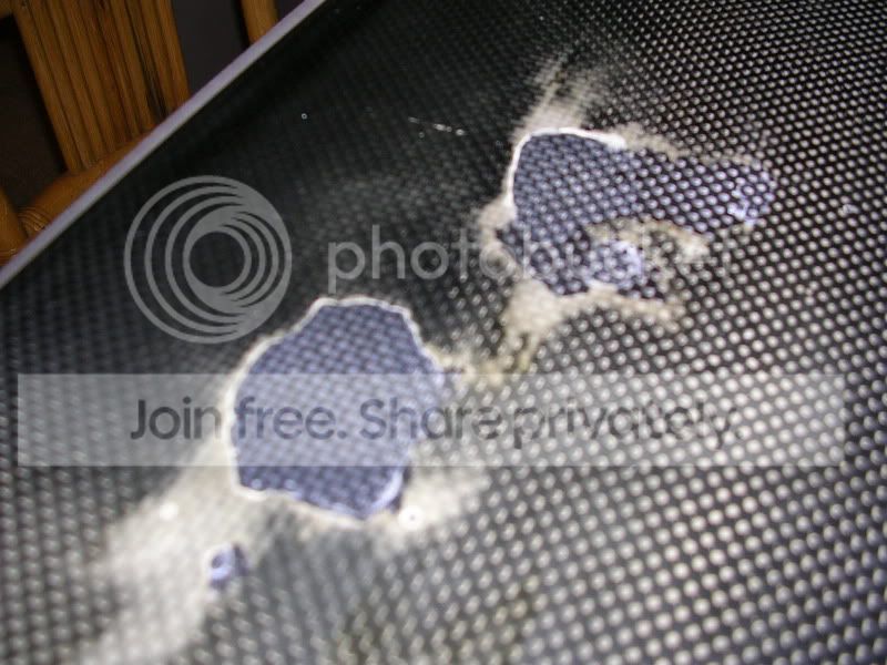

No pics of original damage but it was a little like this.

Example of the lacquer peel.

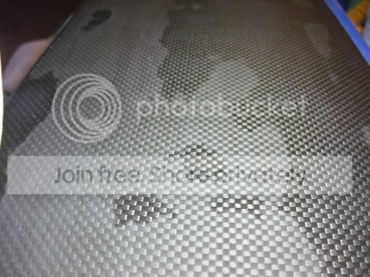

Part way through the sanding process. You can see the clear coat reducing and carbon coming through.

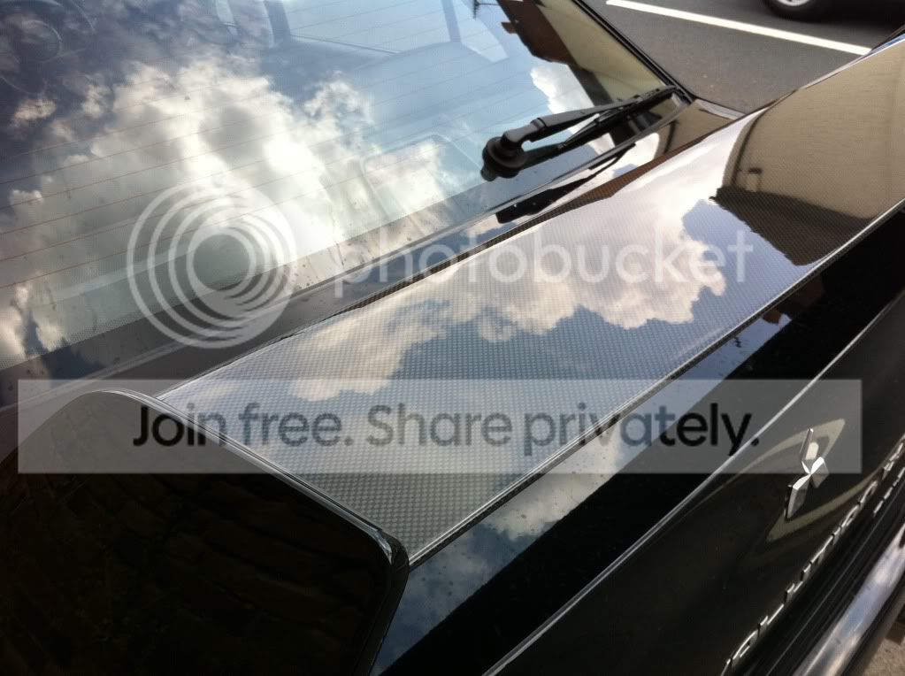

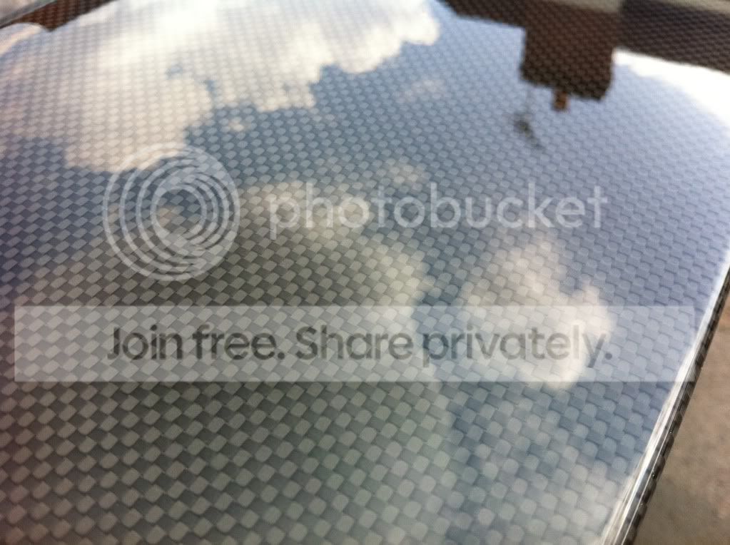

Finished product!! Really pleased that I spent a bit of cashola instead of doing it with a rattle can. Would never of got the same finish. What you see is straight from the spray gun no mopping or polishing. Its like glass!!! Will get a couple of layers of carnuba on in the next week or so.
