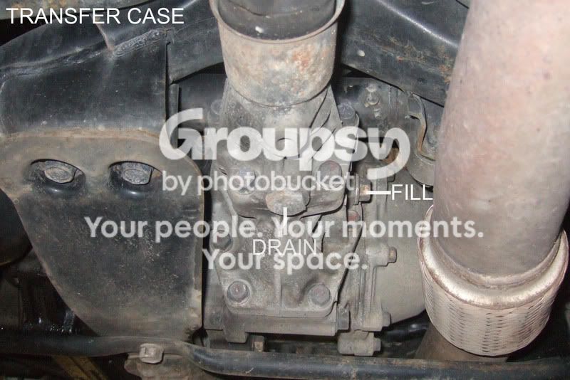

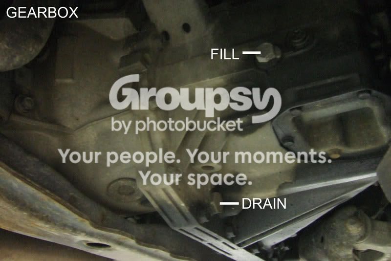

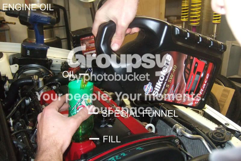

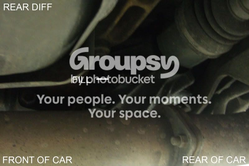

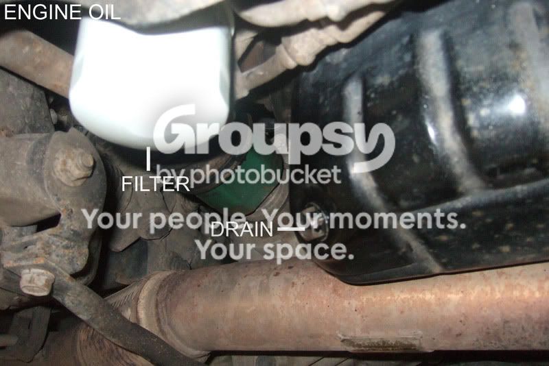

It's about time to have a big oil/fluid change for my Evo 9.
However after going through various sources and even the manual...I am puzzled by what oil I should get for the parts...
1. Engine Oil - I am fine with that
2. Gearbox Oil - DiaQueen GL-3 75w-80, obtain from Mitsubishi Dealer
3. Tranfer Oil - Is it the AYC oil or LSD?
4. Rear Diff oil - AYC oil as above?
5. ACD Fluid - Diamond ATF SP III, obtain from MItsubishi Dealer
My main concern is about 3 and 4...are they using LSD or AYC oil as shown below?
