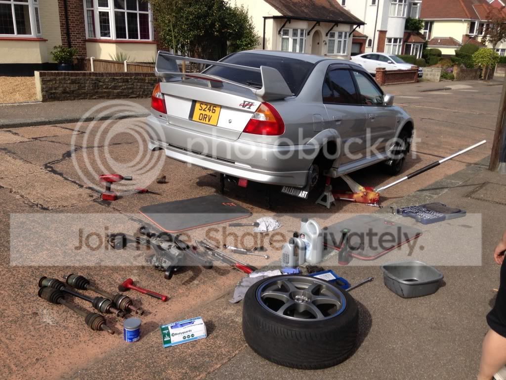

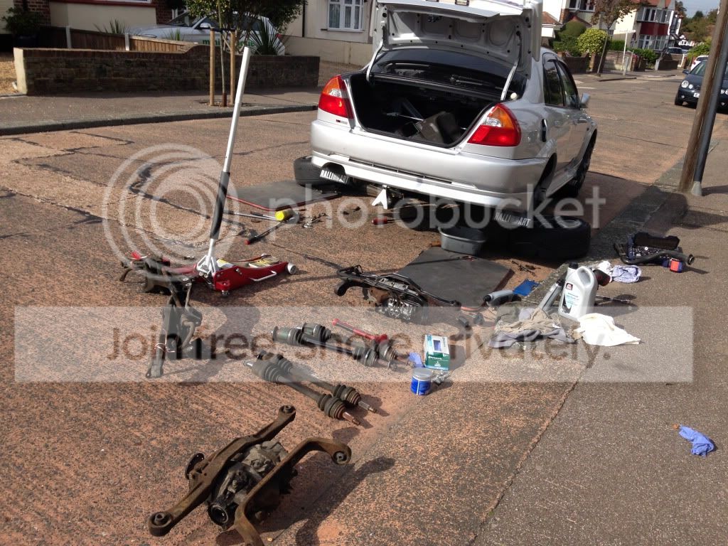

All I've got is me starting with the 7 diff ready and half way through with old diff out but 110% confirmed 7 diff is a direct fit with all the 7 hangers/mounts inc... Driveshafts.
I can only assume that, that is then the same case for 8 & 9 diff fitting and also vise versa if people want to fit a RS diff to there 7,8&9!
Starting:
Old diff out, 7 about to go in:

True lol just such little room to work but i guess that could work to your advantage. Are you using man power or jack to lower it? I assumed man power since the lack of room. Also super off topic but what time is it out by you guys? Its 11:27pm here
Reece.
Reece.
The rear sub frame I took down by man power but the diff was lowered with a jack but still had to be lifted on and off and it's not light either!
