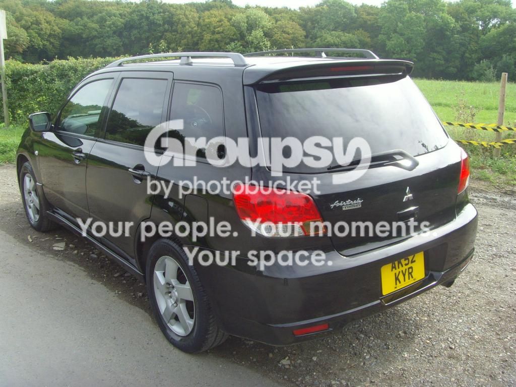

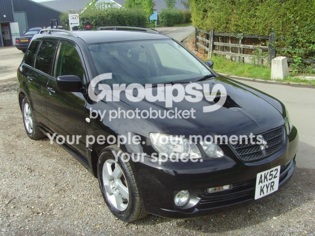

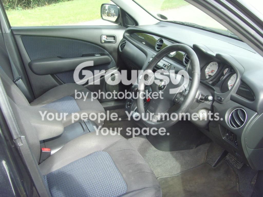

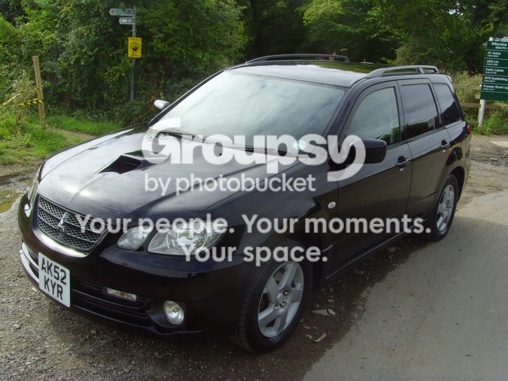

Glad to here your car is now fixed have you any pics :p

It looks very clean and tidy have you any plans for it?
