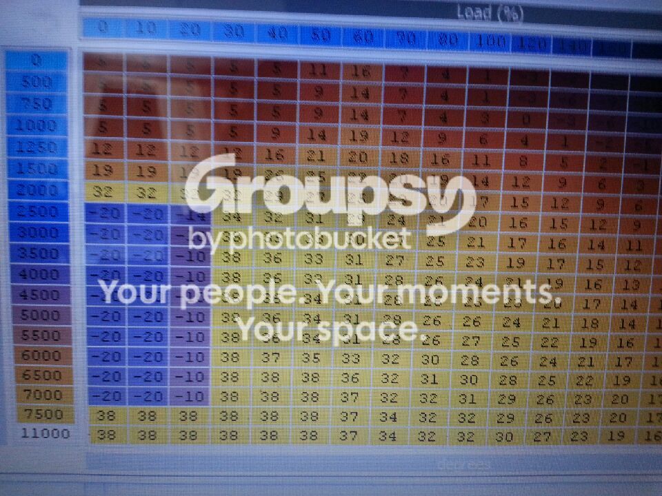

What's everyone using for the sas setting for pops and bangs? I've got a vta and it seem to just bang the once not crackle or pop on over run?
Any ideas?
These are the ones I've copied,
On my five
min trig speed 24
min trig RPM 3000
min trig load
min trig coolant 50
min trig time 2.0
valid trig time 2.0
load below which active 45%
Active time limit 12
Delay before air injection 0.1
delay before fuel injection 0.1
Fuel Injection time 4.8
Air in jection time
2000 0.7
2500 1.2
3000 1.6
3500 - 5500 1.9
6000 1.5
RsvRob
RsvRob
Vta will cause 1 bang.
Recirc will give machine gun effect.
Helps to drill sas bolts out to 5-6mm aswell.
Mess around with air injection times for different effects....
Also because you have set -20 doesn't meen you'll get that unless you have altered the table to allow that much. Or you'll still only see -10. You can try logging to see if you get -20!!
