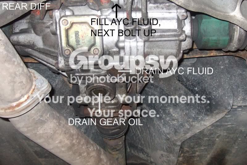

Sounds like the normal donkey noises. This can be cured by changing the Ayc fluid is the rear diff. Not the pump fluid but the Ayc fluid which in the part of the diff which houses the clutch packs.
The fill bung is the one which you can only just get your fingers to. Up round the back of the diff.

Here's a pic someone posted a while back
