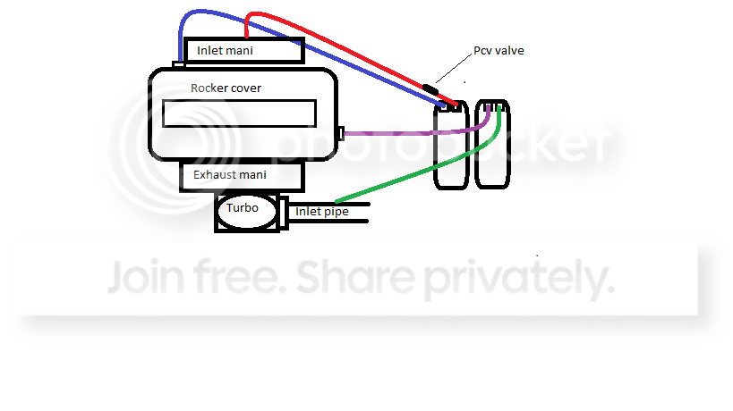

Hi everyone im going to be fitting a dual catch can setup and will be drilling and tapping the rocker cover to fit -10 an fittings but do i use the std pcv valve? Ive added a diagram of the setup i will be using, What do you all think?
Please feel free to copy the image and alter anything ive missed. Thanks
what are you hoping to achieve ?
ive not seen a set up like that before, nice drawing though :)
most people that i know of (myself included) go for this set up :)

Nice set up that lee..
I run a cusco catch can, as there is only one in breather I have a t picked the two breathers then run it to the catch can.

Some cams will vent though the lid, otherwise you can run a breather pipe to a crank case breather filter.. That's what I did.
