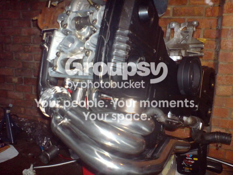

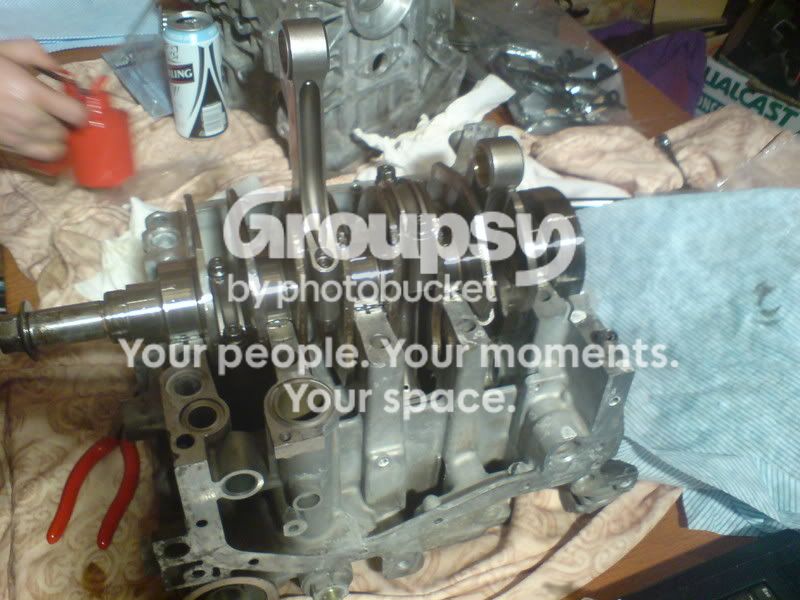

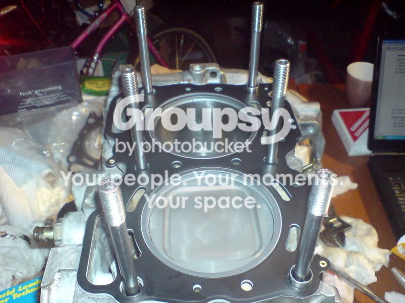

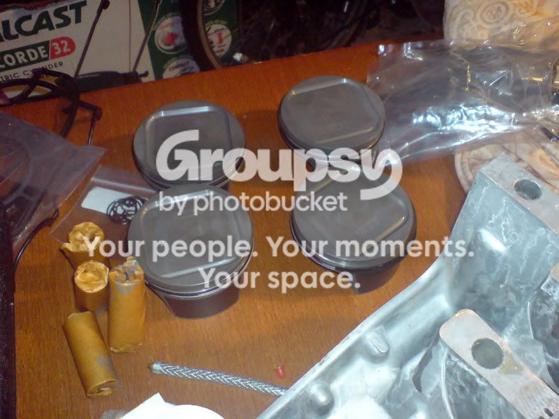

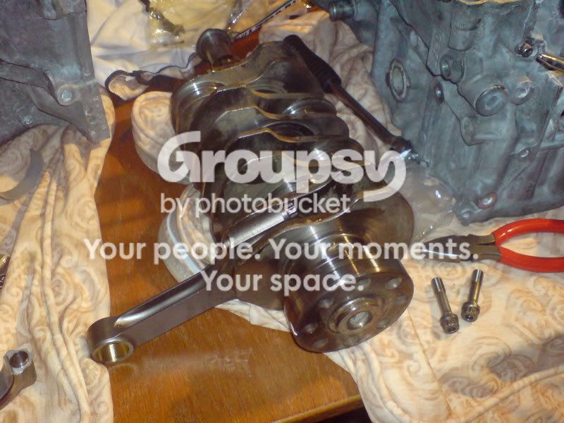

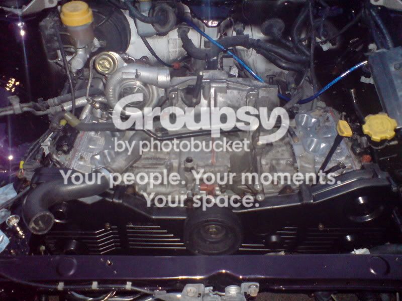

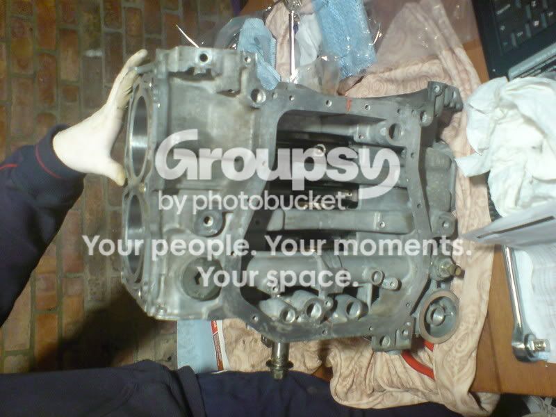

To be honest i find the scooby engine an easy one to work on when on a stand. My last car was a pulsar GTi-R you want to try working on one of them enough to mentally break someone lol. After looking round the evo engine bay its a nice simple unit to work on and i would compare it to a normal twin cam.

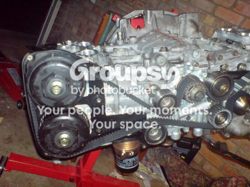

A few pics of one of the scooby engine builds
Marty.H
527
Norwich
They see a comfortable 450/450 ish you can push them a bit harder but to be honest 450 bhp and the same in torque in a road car is more then enough.

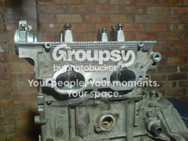

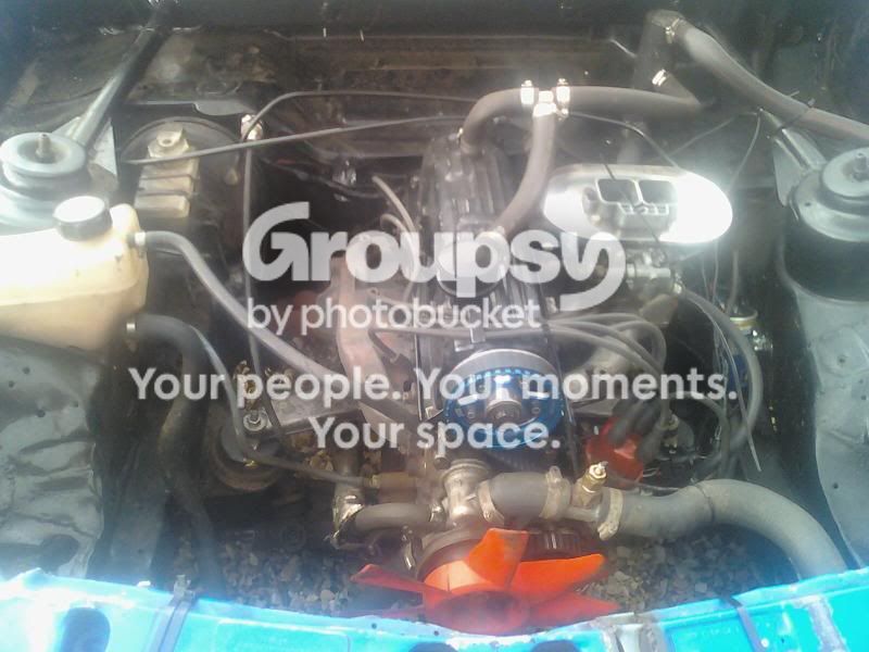

another engine i like to play around with old school this one
Thats the engine i use to run in my lightning rod
Spec of that was
Head work been done is :
130 thou removed from face
New cam bearings
Kent GTS2 cam
New rockers
All new valve seats
New valve guids
All valves machined into seats at same depth so when setting clearances all rockers even
3 angled valve seats
New valve stem oil seals
New kent cams vernier
New K&N filter
Carb:
32/36 DGAV
Re jetted
Larger Venturi's
Choke's removed
Power valve blocked
Bottom end 205 Block:
10 thou decked
Mahle pstons
STD crank not been ground
Has been stripped and checked all new gaskets fitted
New water pump
New Cambelt
Dizzy been done NO vac advance
New Coil / dizzy cap / Rotor Arm
As you can see i like to play around lol
