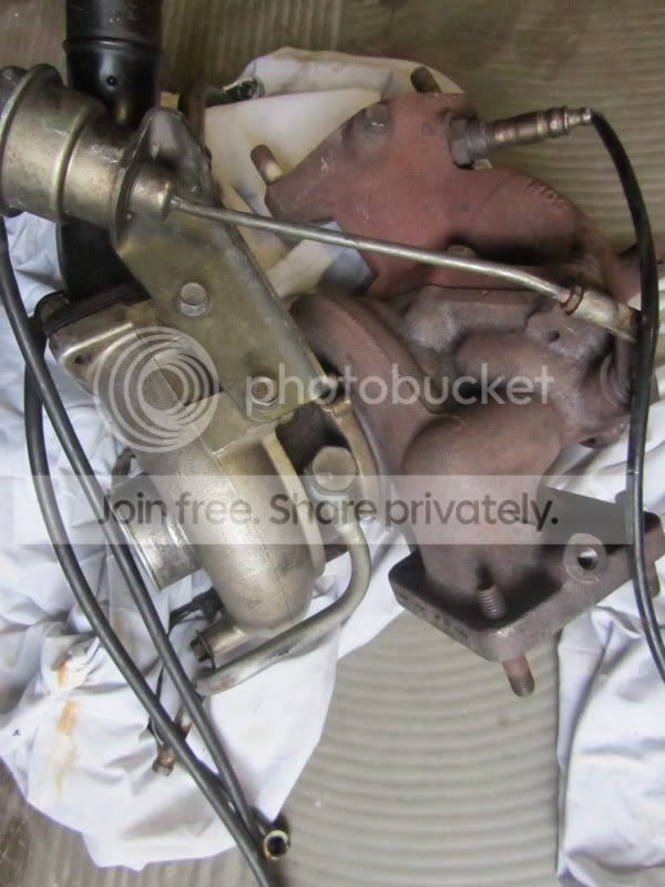

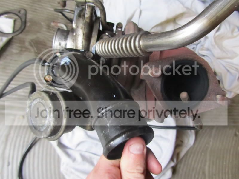

Does anyone know if i would be able to use my old actuator (i think its off a VII see pics) on a series 80 evo IX Turbo?
I will be running about 360-380BHP max
Cheers :)

the 9 is longer I believe but you might be able to unwind the adjuster on the end and make it fit depending on how far it needs to come out, might be worth a look before buying a new one
Andy
As Andy said. You can probably adjust it enough to get it to work right.
Align the hole in the end of the arm half way over the pin that it locates on. This should be, and best to check with a pressure gauge. 0:80-0:90 bar :)

the 9 one is a slightly different shape...
