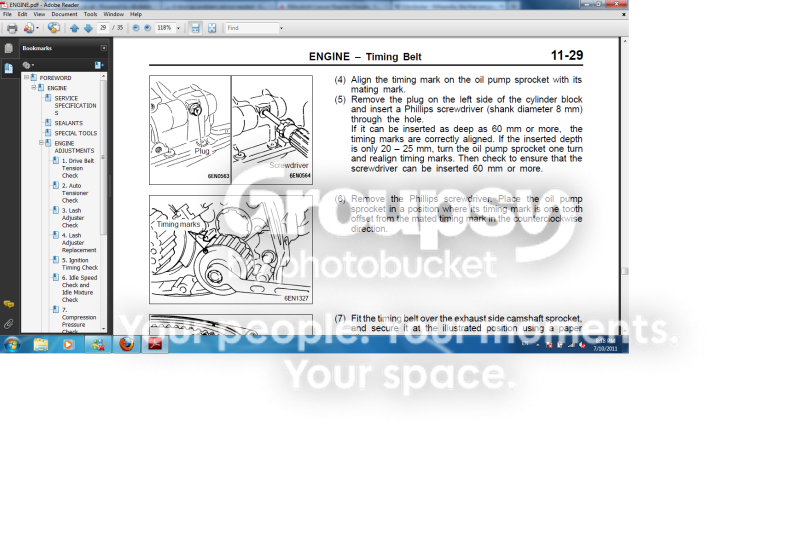

Ah i bet as ive slackened the belt of it has dropped :blush: i better get it back to work and of the ramp and get it stripped out
im going by this
and had it set to 1 tooth before anticlockwise
But i did not use the screwdriver :blush:
