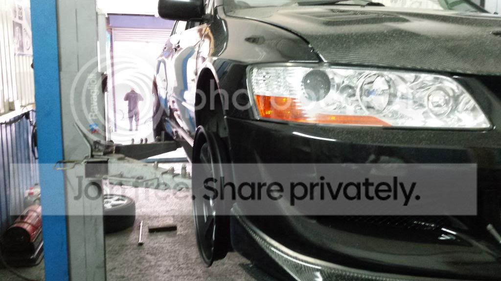

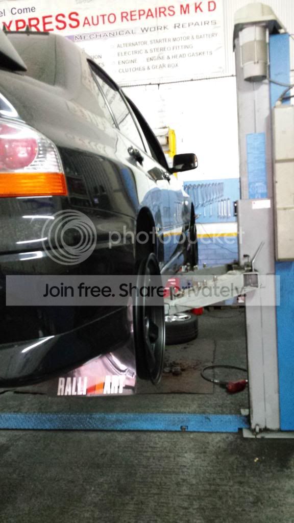

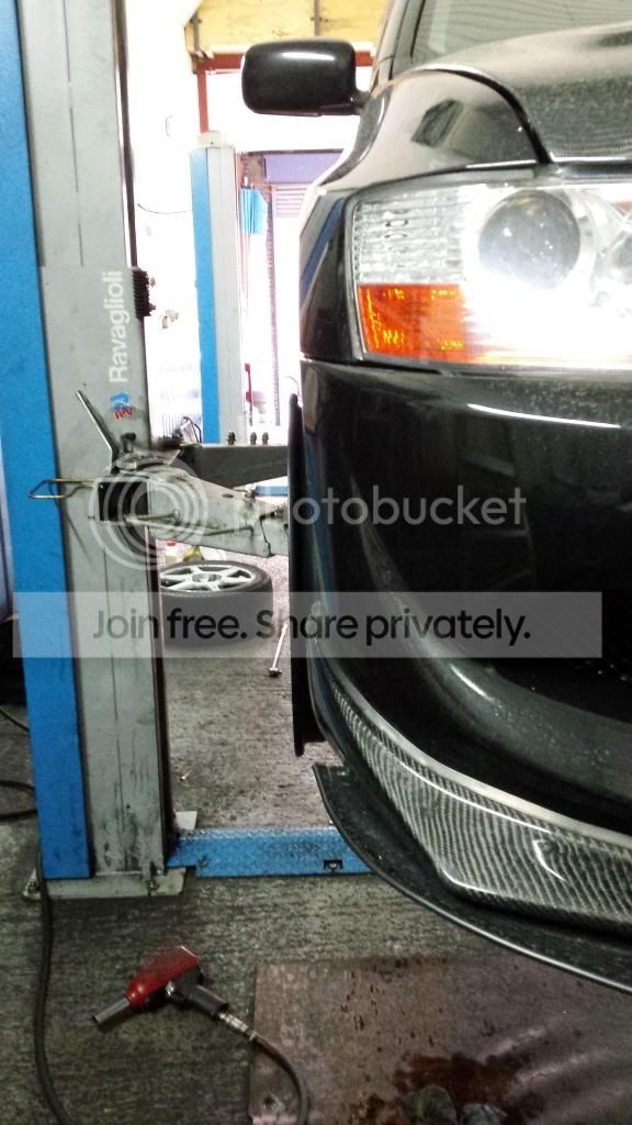

Will it touch the calipers? Would rolling the arches do the job?

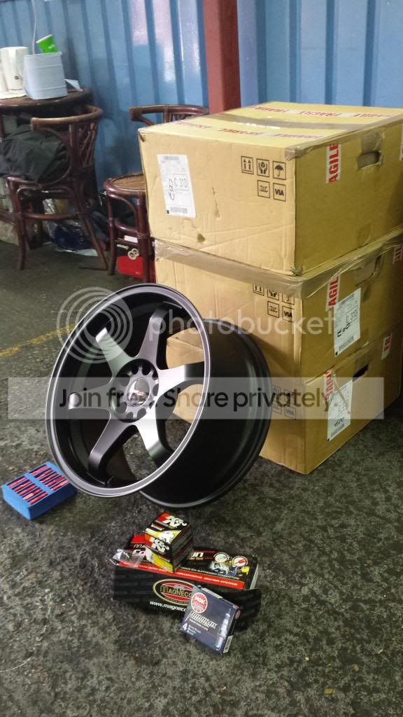

Like these ?
Just read somewhere else that someone had 18x9.5 et20 on there car and had to drop to a 225/35 tyre so they didn't rub the arches. Yours are gonna stick out another 5mm further than that.
Also said the car handles like a pig

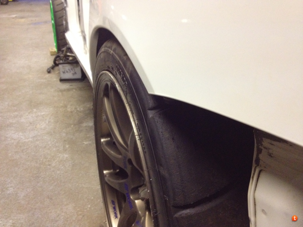

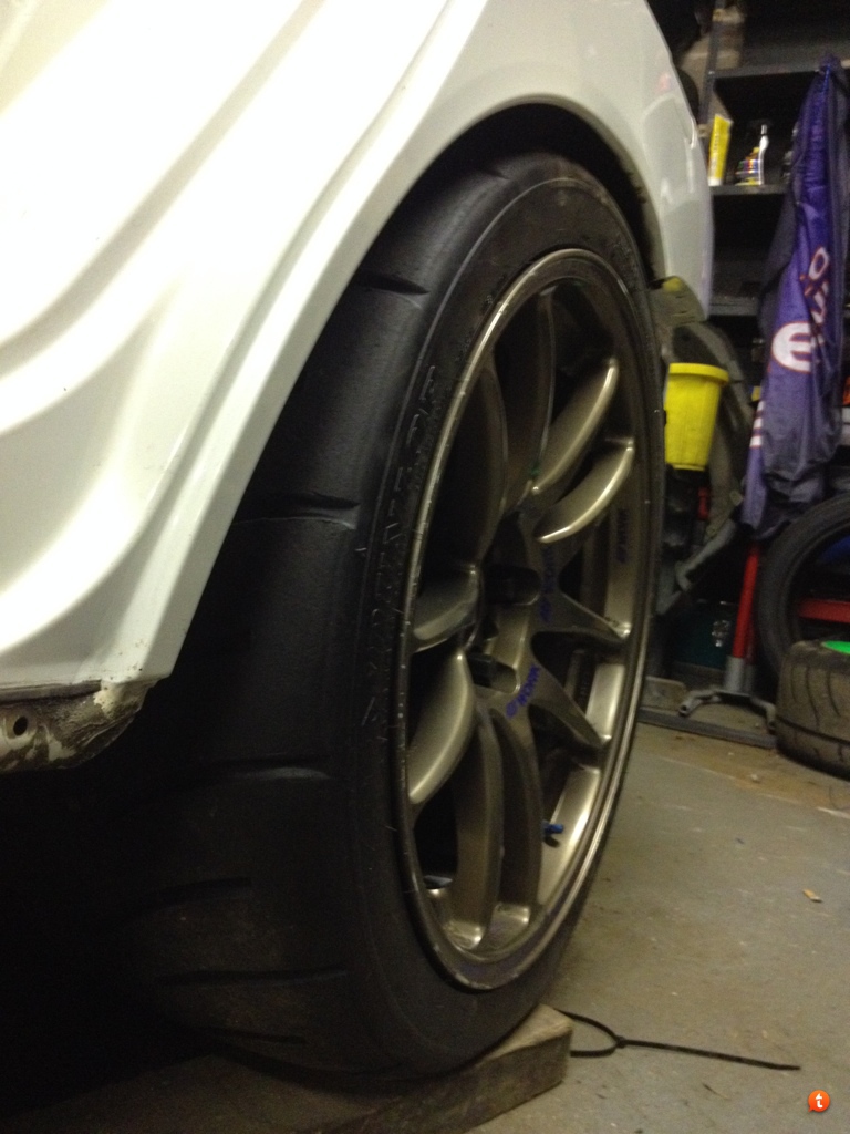

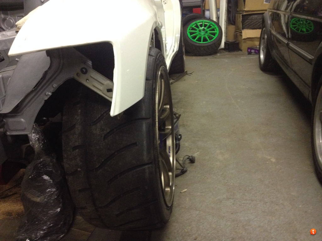

This came today.:)
Done a full service today just need to buy the right tyres and a spigot rings.

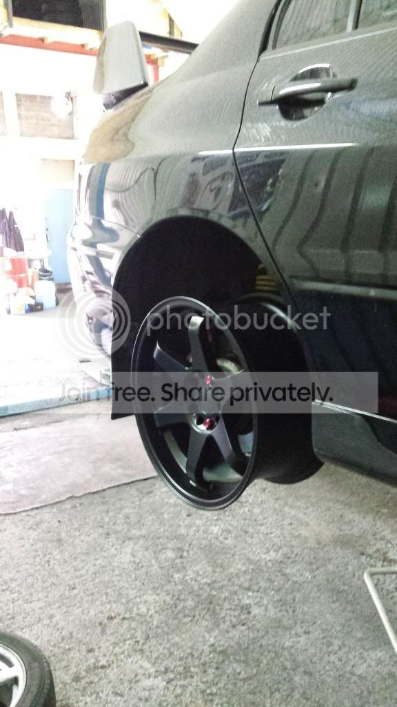

I also test fitted the wheel to see how far it sticks out and it looks like I will have to roll the arches, therefore can someone kindly suggest what tyres I will need and what spigot ring. The hub is 74.1 if this helps.
(i know it would have been better with the wheels on the ground but didn't have wood to rest it against):sneaky:
