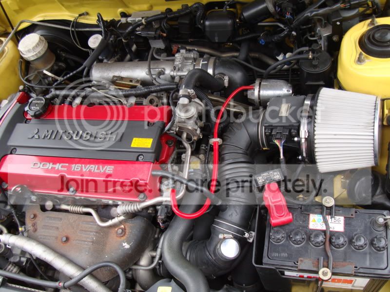

this is the rest of the engine condition, looked well looked after to me?
Looks like it has had a recent steam clean to me buddy!
Might explain why up top it looks like there is nothing to worry about;)
He might have replaced the Rocker Cover Seals and then had the bay steam cleaned which would mean that everything is fine now.
Have you asked the seller to explain what the leak is all about in the picture???

if it does turn out to be one of the above items im not too worried,im mainly concerned if the running of the engine (head gasket, block/head etc) are ok.
the bloke is a valeter so could explain a steam clean, the rest of the car is very, very tidy.
