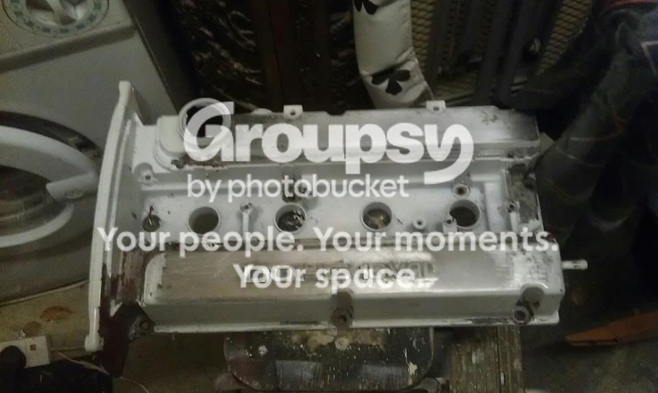

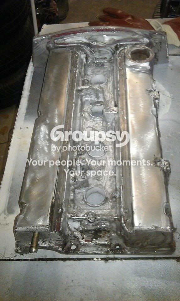

So i recieved the cover in to be honest, a worse than wear state than i would have thort :hm:

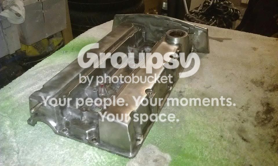

I decided from the characteristics i had learnt. that smoothing the cover would give an affect the owner would admire
as the cover had been sprayed twice previously, we decided we wanted to take the cover back to original state, to make sure there were no contaminats.

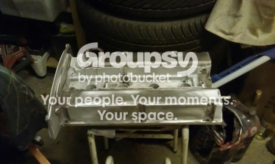

Further to this we needed a smooth base to paint on so upon removing the acid we gave it a flick ove

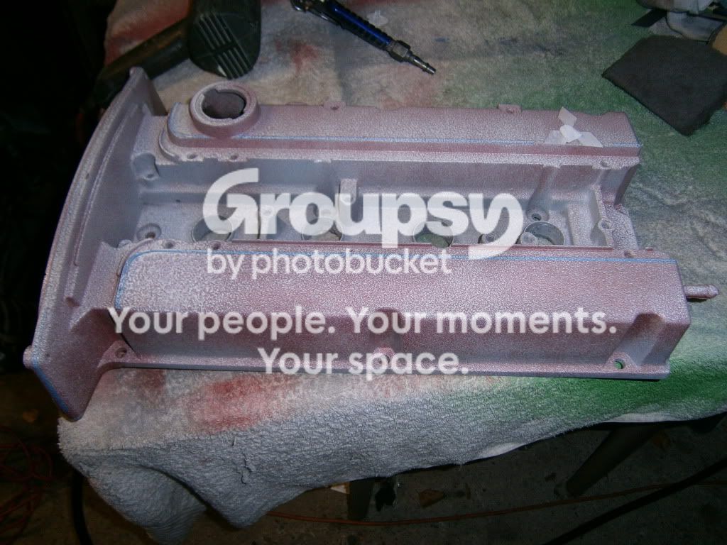

Building the platform before two layers of paint, we used a primer that helps adhesion
then taking the wanted designs into consideration we applied what would be the detail colour :thinking:

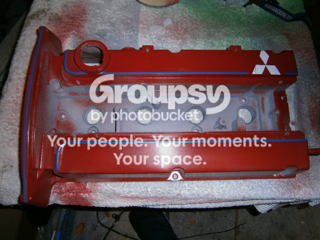

The owner had talked about the mitsi logo, and we thought that it would really set it off, with an old scool pinstripe :disgusted:

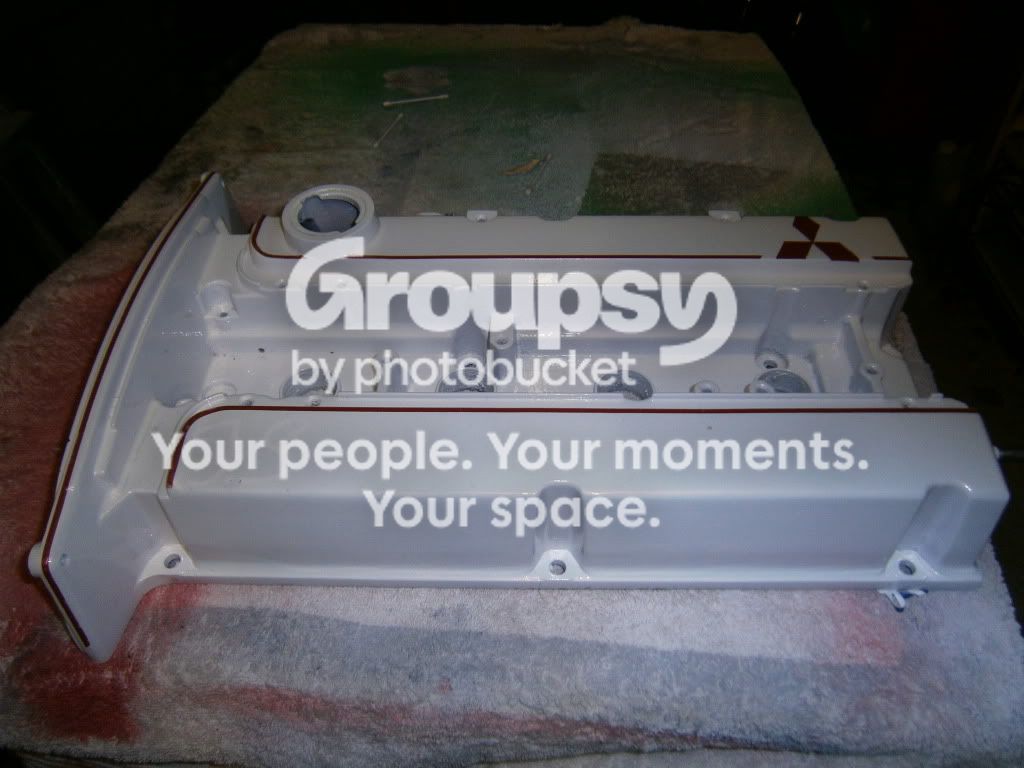

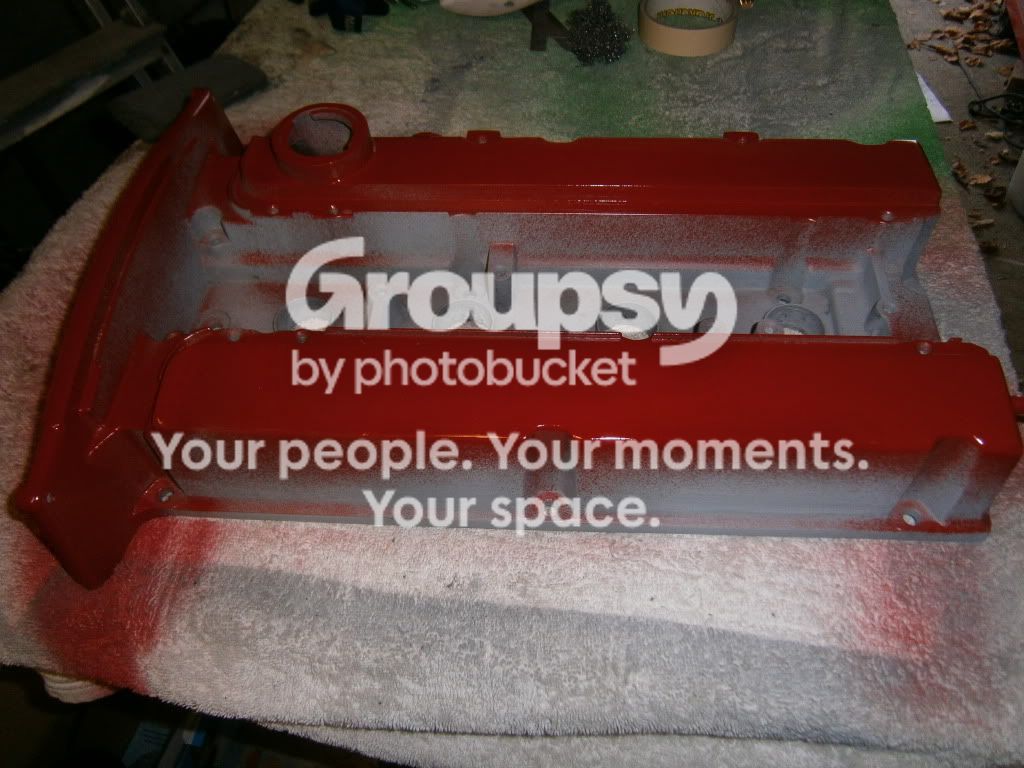

Applying the choosen base colour in light dust coats

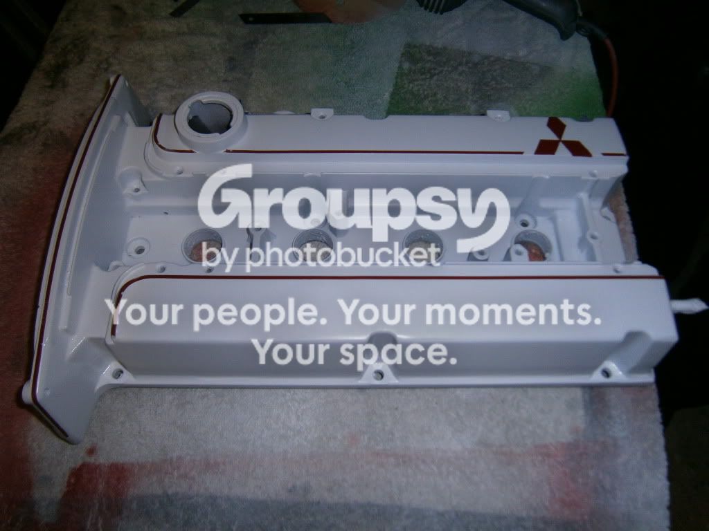

To reveal

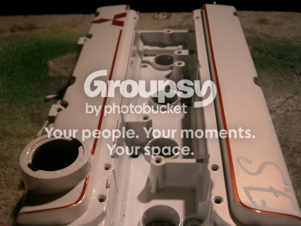

carrying on we then applied our stamp 'paint perfection' but in this time the intials Fs :whistling:
Anyhow deciding we did not want this to be a centre point we decided we would merg it into the base colour

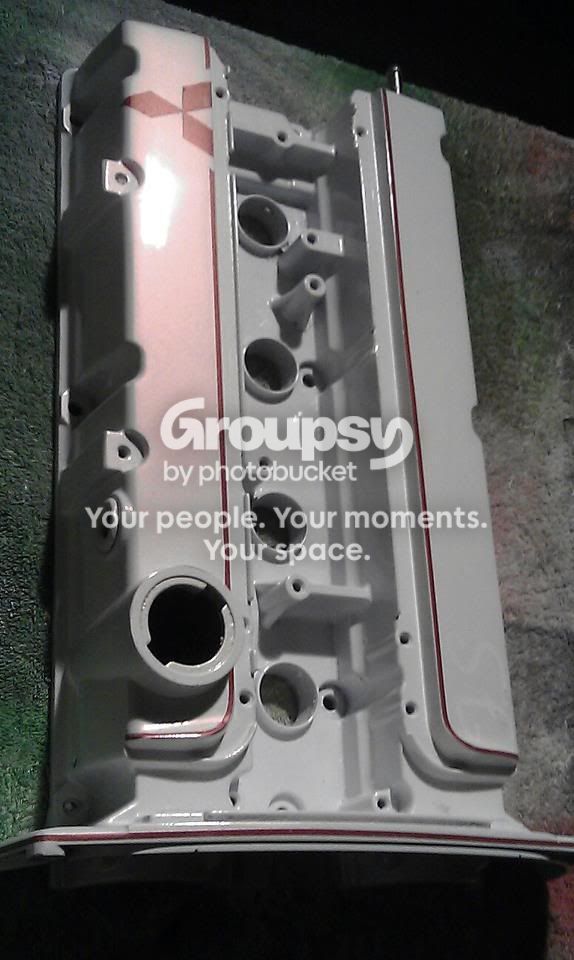

Finally to really set her off we finished her off with a red pearl to match the theme of red and white in the engine bay and a deep gloss coat of clear :arms:
Just hope you are happy enough with it to take your mind of the times for a lil while
Paint perfection!
