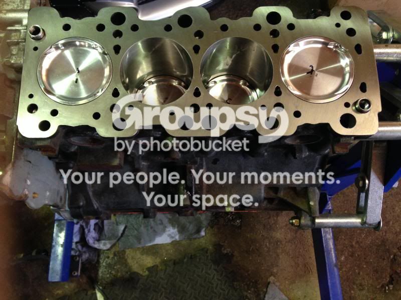

What power you wanting?
490-500 safely.
Spent a couple hours on her today, got engine and box in along with transfer box and fitted the poly bushed engine mounts (had to use original engine mount as the one i had was from an evo 6 and puts engine to high).

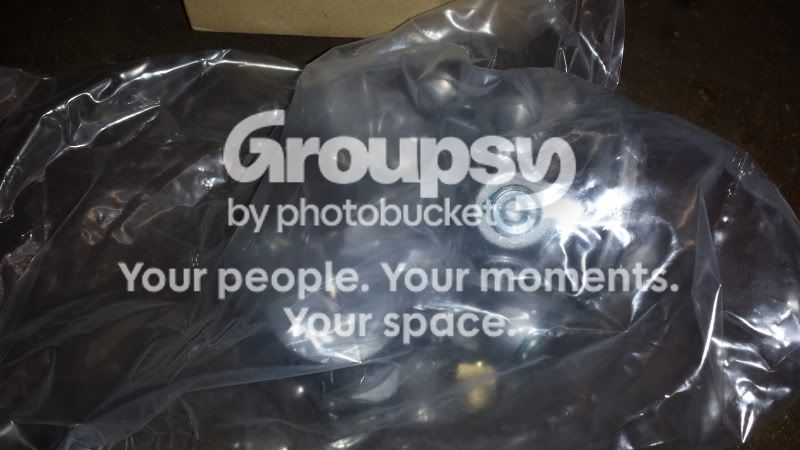

Opened up the TT S214b box to build up and tbh first impression of it was not very good.
The finish of the J pipe is shocking compared to the HKS pipe iv just sold, the outside finish of the compressor housing is rough, the exhaust housing finish isnt that great.
It came with studs in the fitting kit but no nuts.
When fitting it to the manifold one of the water pipes fouled a bolt so had to to moved, also the wiring for the starter gets in the way so had to adjust the bracket.
The j pipe doesnt line up with the compressor housing on outside but may do inside!
With the water problem and the actuators id of thought it would have a hat like the evo 8s do.
So hopefully it will perform well to outway these negatives.
