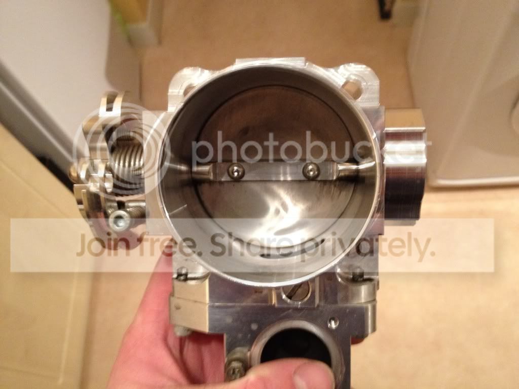

I had to open my idle screw as it wouldn't tick over at all.
I know what your saying about the domed nut. I'm running standard fuel rail but still had to tweak the thin part of the metal fitting on the end of the fuel line.
I had no previsions for water pipes on tb as I have a later 7/8/9 one so just removed 1 of the pipes then looped the other one round to the open outlet to complete the circuit
And yea my hardpipe also stepped down to about 60-65mm hence why I had it remade in 3" :)

i was going to loop the water pipe my self but noticed the choke flap and when i ran some hot water through the pipes it turned so i thought i would leave it for now just to get the car back on the road ,
maybe if needed later as the thing is adjustable i could adjust it shut and then remove the hot water pipes .the cooler the inlet the better ???
there is defo a big differance in the way the car drives now more so than i thought there would be,
more torque faster spool its win win :O)

Yea see I was lead to believe that if you done away with the water pipes on the early tb that yes it means tb will be slightly cooler but also it will introduce cold start issues.
Mine is different as I have the later tb with later idle control valve so water pipes not needed anyway :)
Yea, see now I can feel it scrabbling for grip in 3rd gear or just plain spinning the wheels :)
