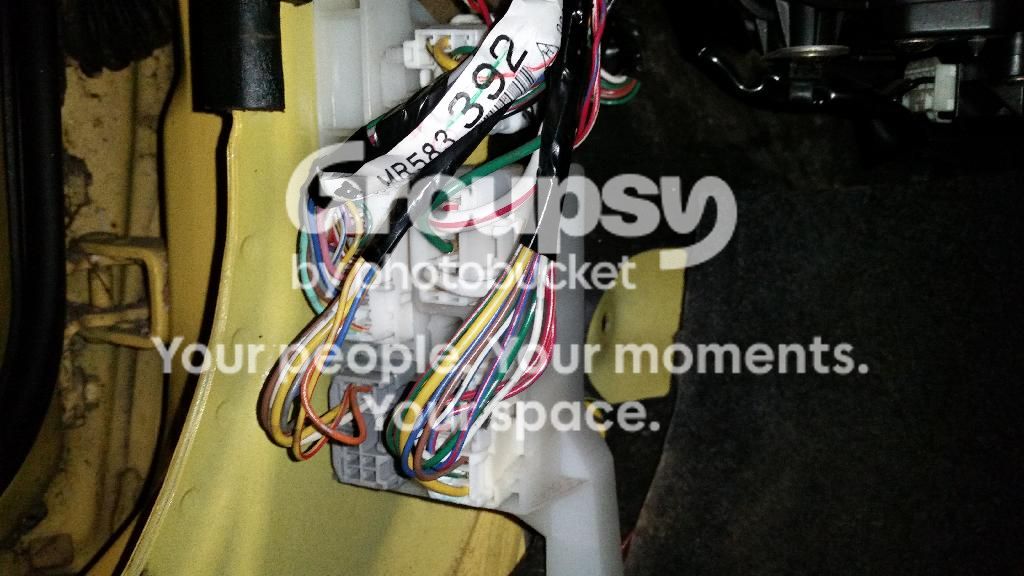

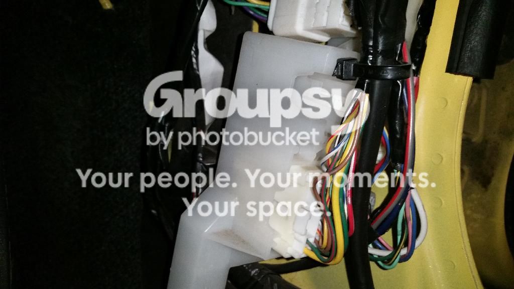

- passenger side foot well seems all in (dont mind the dirt, need to clean it out)
-drivers side foot well seems all in

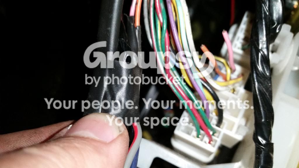

-driver side has 2 wires cut... but i have HKS turbo timer and TOAD so i guess its done for that?

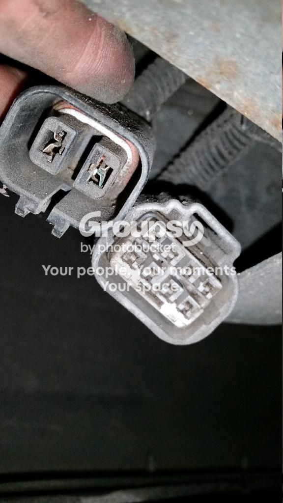

I was lurking around the car today again, checked the fuses and stuff... topped up the fluid just in case... and decided- going to look at the pump, seen the wires, gave them a touch and:
unplugged!!!

The first port of call is to clean out the said plugs in the pic and their corresponding terminals. Once done, reconnect them.

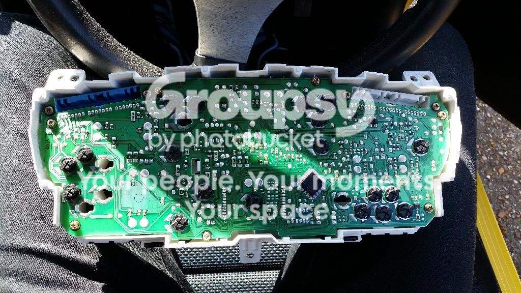

Just for the peace of mind I had the clocks out, and all seems perfect there
