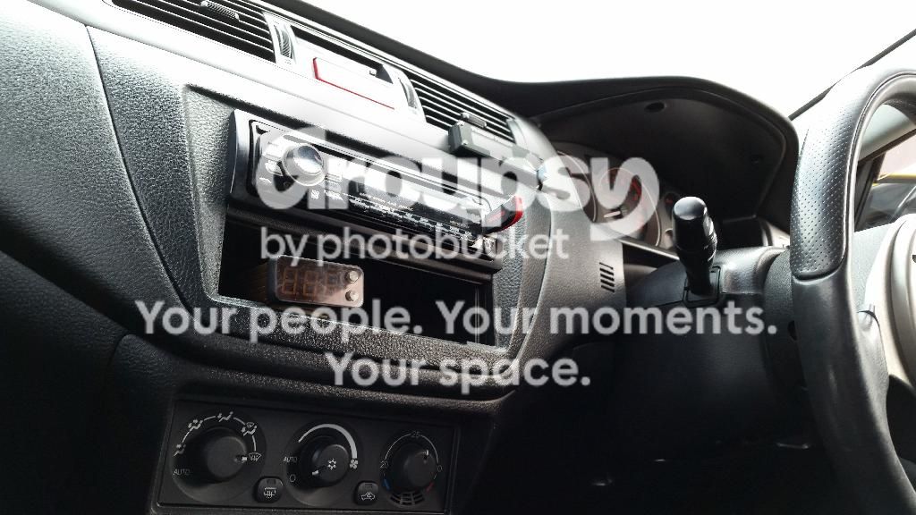

I got an Evo 7 GSR (import) with FQ heater controls on the bottom
(I used to have GSR before and it had single din with heater controls under the radio.)
Now I have this:
(boost controller is being moved under the heater controls today)

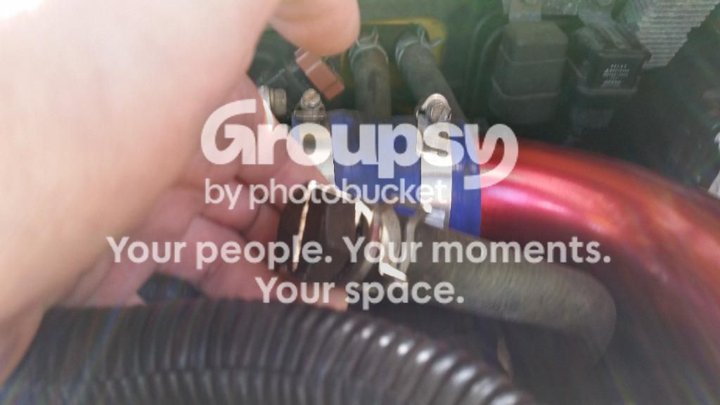

Was ready to put air through...
Found this:
Where exactly the pipe go (left one is plugged in to the block I think, this one is the right one)
8,136
Boston
Oh that looks like one of your circulation pipes. Is the other end of that in the bulkhead atthr back of the picture? Not a clue why that would have been blanked off unless you have bought the car recent and the stat has gone and he done ttto hide on the test drive
N
Nero_slk
18
Southampton
Found the issue :))
My car has evo 8 engine where that pipes goes in to thermostat housing instead of manifold...
I still have evo 7 termostat so I need a T piece from any other pipe, or a thermostat from evo 8....
Thinking to do it properly, but if I replace it with 8 thermostat,will I have to do any other pipes???
8,136
Boston
Ah right that makes sense, not sure to be honest you may need to blank something off but see what el has to say when he gets online as he will know more about the differences between the 7+8
5,705
Nuneaton
Aha, I see that you have found the problem!
I have read your previous post and am certain that the Evo VIII Thermostat Housing is different to the VII and the opening system operates differently too.
I have a feeling that you're capable enough so maybe your best bet right now is to try and modify what you have available to you....
