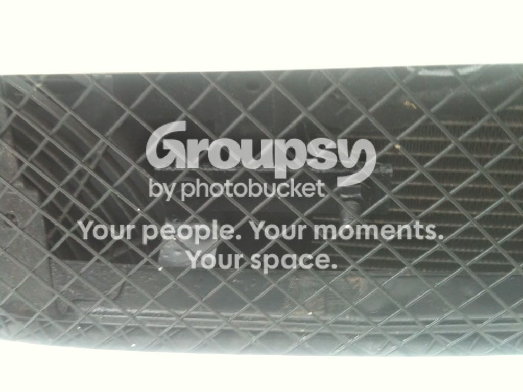

here is my modded bracket, just a simple horisontal bar and a bolt
BenV
BenV
76
well the one i removed from a 5 looked like a well put together kit so i'd say it may be worth a punt and is certainly a better choise than the cheap bar and plate ebay jobbies.
yep a simple bracket is all thats needed to fit the 7,8,9 think i may have one at work aswell if interested
