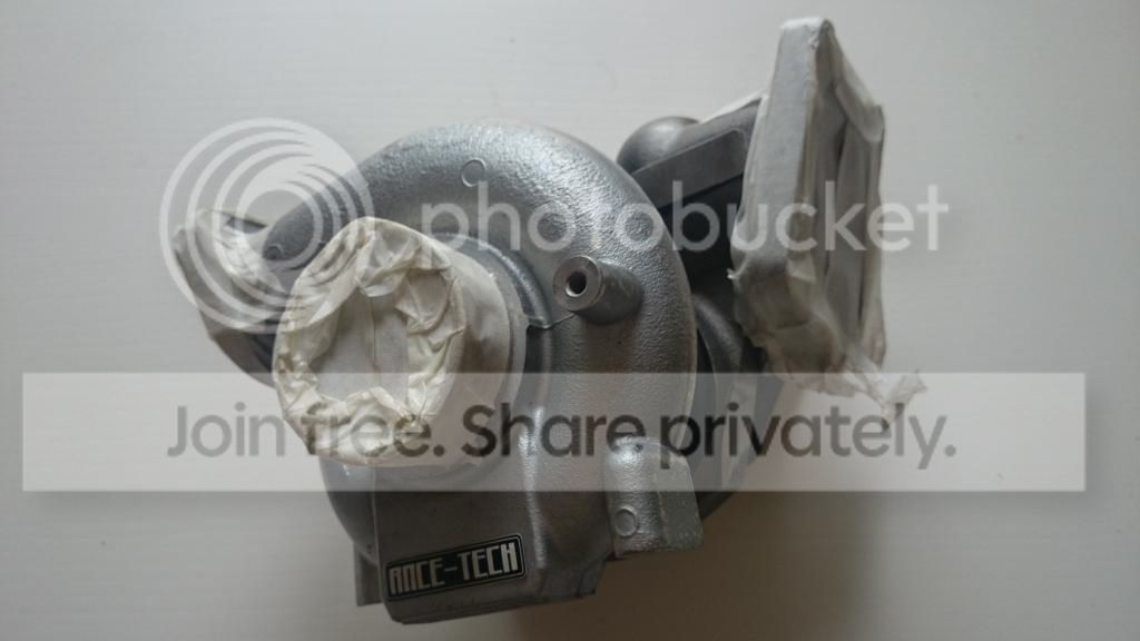

Ah ok how's the best way to check what turbo I'm running ? Unsure if it's standard

Where the race tech sticker is there should on your turbo be a part number. Last few digits will be something like 9.8t or 10.5t which is exhaust size. The later will be able to run more power ;)
