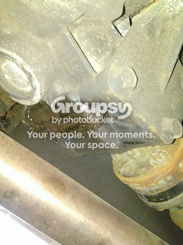

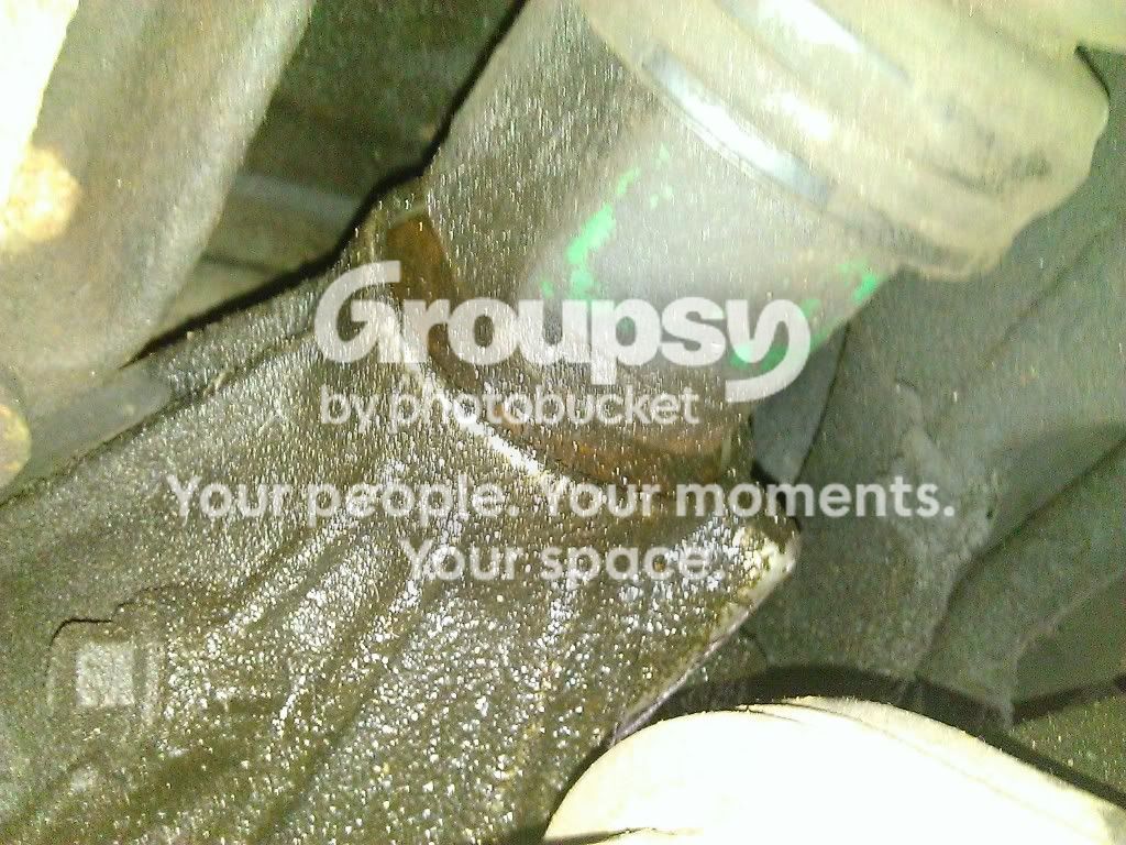

hi guys. recently had to take my evo 5 gsr off the road due to a very loud knocking/clunking in the drivetrain. loud under acceleration and deceleration and u can get it pretty much silent if you balance the throttle so there is no load and you just coast. I am leading toward me thinking its a drive/prop shaft problem as it feels unbalanced also. I have had a quick look under it and took a couple of pics of what may be the problem area... so what do you guys with more experience think??
these two are of the rear passanger side shaft, where it joins the diff. there is oil leaking from where it goes into the diff and dribbling down the diff housing. (actually enough to leave a spot on the floor) the boots of the driveshaft look ok and not loosing any grease, but where it slots/joins onto the diff where its actually leaking from there is a lot of play (a lot more then the other side which is dry).
now im leaning toward this being the problem, with the play and the oil loss. would you blame the diff or the shaft? as I don't really know how these work.

From what I have read buddy, it sounds like the Prop Shaft to me.
To confirm, please advise, was the clunking faster and louder at speed and slower, less noisier when you were off throttle / slowing down?

its instantly audable as soon as you roll and gets louder and louder the faster the wheels are turning (its not relevant to gear its relevant to wheel rotation speed and doesnt change when you clutch in.) so its still there when you clutch in etc.
can get it pretty silent if you balance the trottle.
loudest at higher speeds under load.
doesnt really change when cornering.
its loud as hell and had to take the car off the road as soon as it happened because of it.
now what can go wrong with the prop? what do i need to check?
all i noticed is that the rubber donuts in the center of the shaft holding it to the underbody there is a good deal of movement, say half an inch in one. the other looks ok. and all other joins of the prop etc look ok.

quick update guys... bad news. ive been under it and inspected the prop thouroughly, i cant see anything wrong with it at all. all the joints look sound with no play, all bolts are present and correct and tight. the only play is the middle donuts which looks like the acceptable normal play. anyway, i was going to put it on 4 stands and drive it on the stands to see if i could narrow down the area the noise is coming from but i didnt feel it was safe enough to do this. i let my partener drive it up and down our street a few times and outside the car it defo sounds rear end related, and sounds alot more 'clangy' outside. i fear it is diff related. so im going to get it to a specialist in the near future and just get it sorted along with fluid changes all round. in the meantime i will be doing other bits to get it how i want it ready for when its fixed :) thanks for the help guys.
