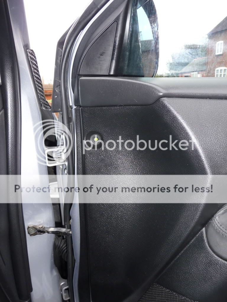

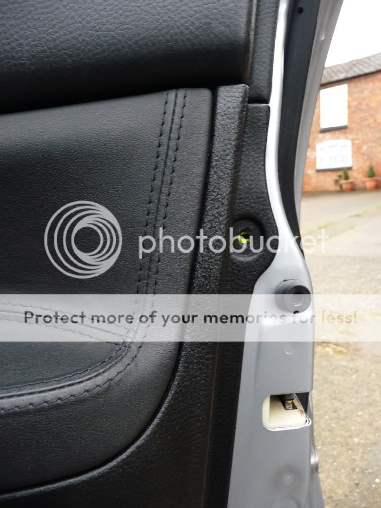

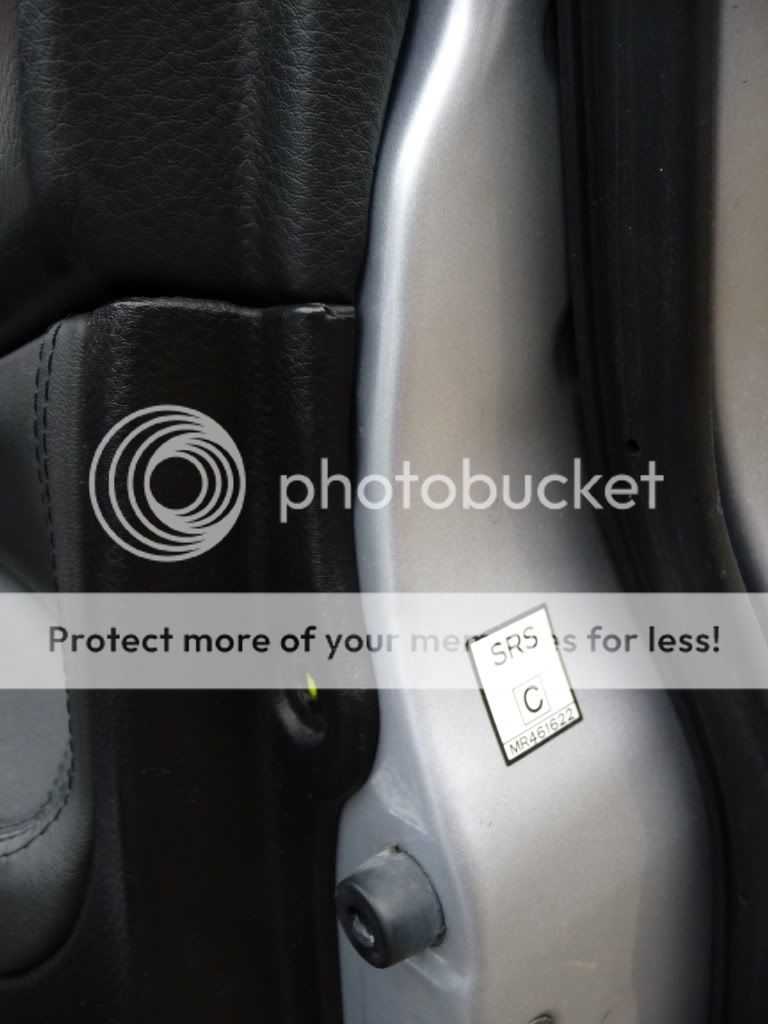

    2. Locate the little covers in the top left and bottom right of the door panel and gently pop the top off with the small flat head screw driver and undo the screw.
    There is two of these per door panel
    DO NOT USE TOO MUCH FORCE AS THERE IS LITTLE PIECES OF PLASTIC HOLDING MOST OF THE SMALL PIECES YOU NEED TO REMOVE AND THEY WILL BREAK IF YOU ARE NOT CAREFUL

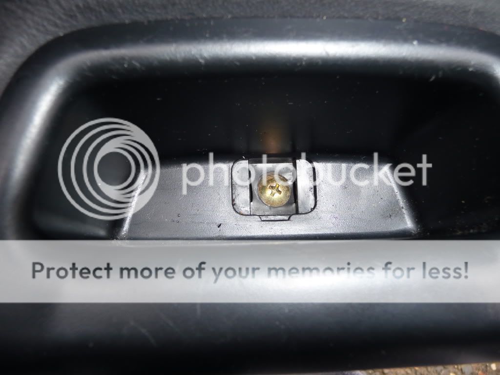

    3. Locate the plastic cap inside the door grab, and using the advice in step 2, pop off the cap and under the screw inside this compartment and gently prise it away from the panel.

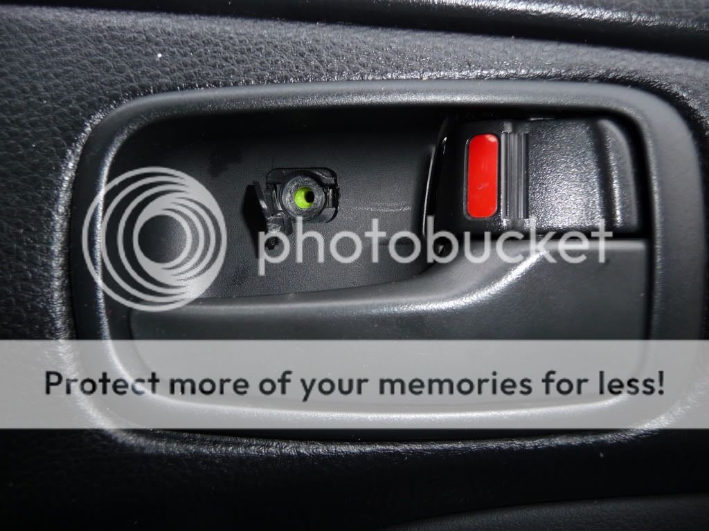

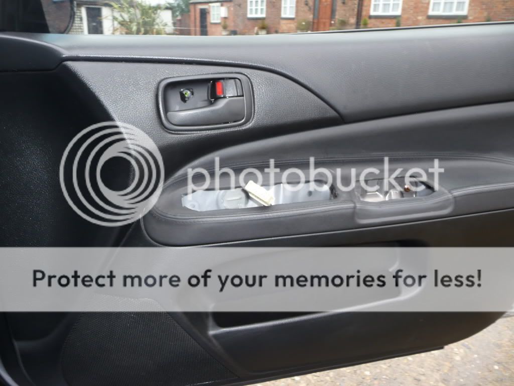

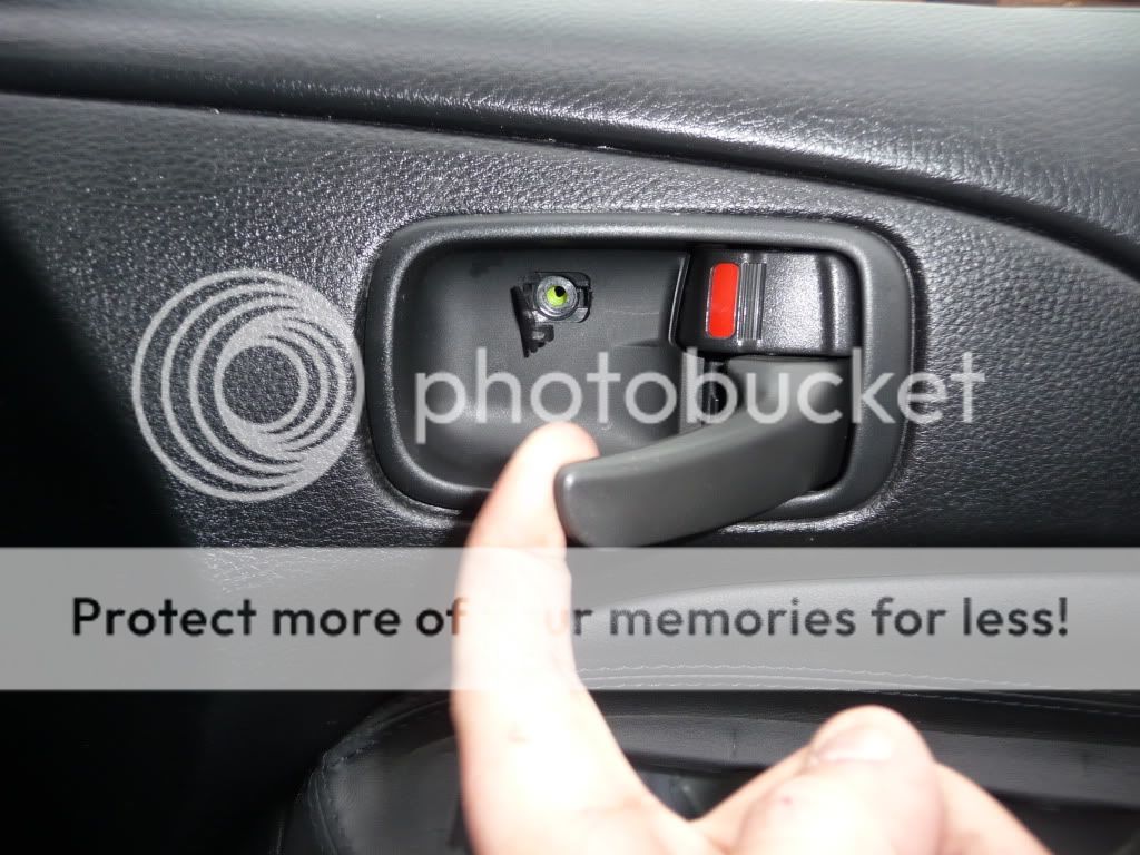

    4. To remove the door handle itself at first seems a little scary as the plastic is rather brittle but there is a knack to it.Firstly undo the screw in the door handle
    Pull the door handle in the open position and then gently prise away the lower part of the surround and then lift the top part slightly and slide it over the handle, you may have to use the thin flat head to lift it away from the panel .....this is why I wrapped my screw drivers in masking tape ;)

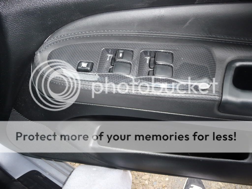

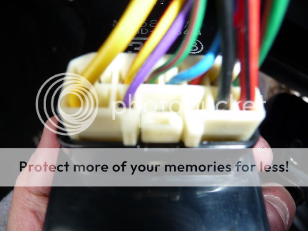

    5. Remove the window switches being careful again not to mark the interior door card or the switch, gently prise up the switch with a the thin flat head or wait until the door card is almost off the door and then pop it out from underneath.
    [​IMG]
    Disconnect the switches and your almost ready to get the door card off.
    [​IMG]
    [​IMG]

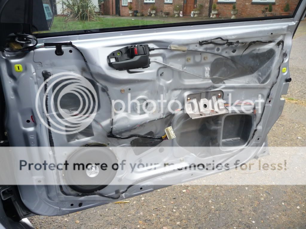

    6. Using the large flat head, push the panel away from the door going all the way around the door card, you will here a pop as the plastic clips holding the door card come away from the door, I found the easy place to start was up by the door lock, there is a small recess in the door which allows easy access for the flat head.
    [​IMG]
    Once you have popped off all the clips you can the door card will still feel like it is held in place this is where you must slightly lift and pull away the door card as it is also held by a lip at the top of the door card it should just lift off then it will leave you with this.
    [​IMG]
    At this stage if you were sound deadening your doors you would remove the plastic wrap on the door but more on this in my next How To.......
